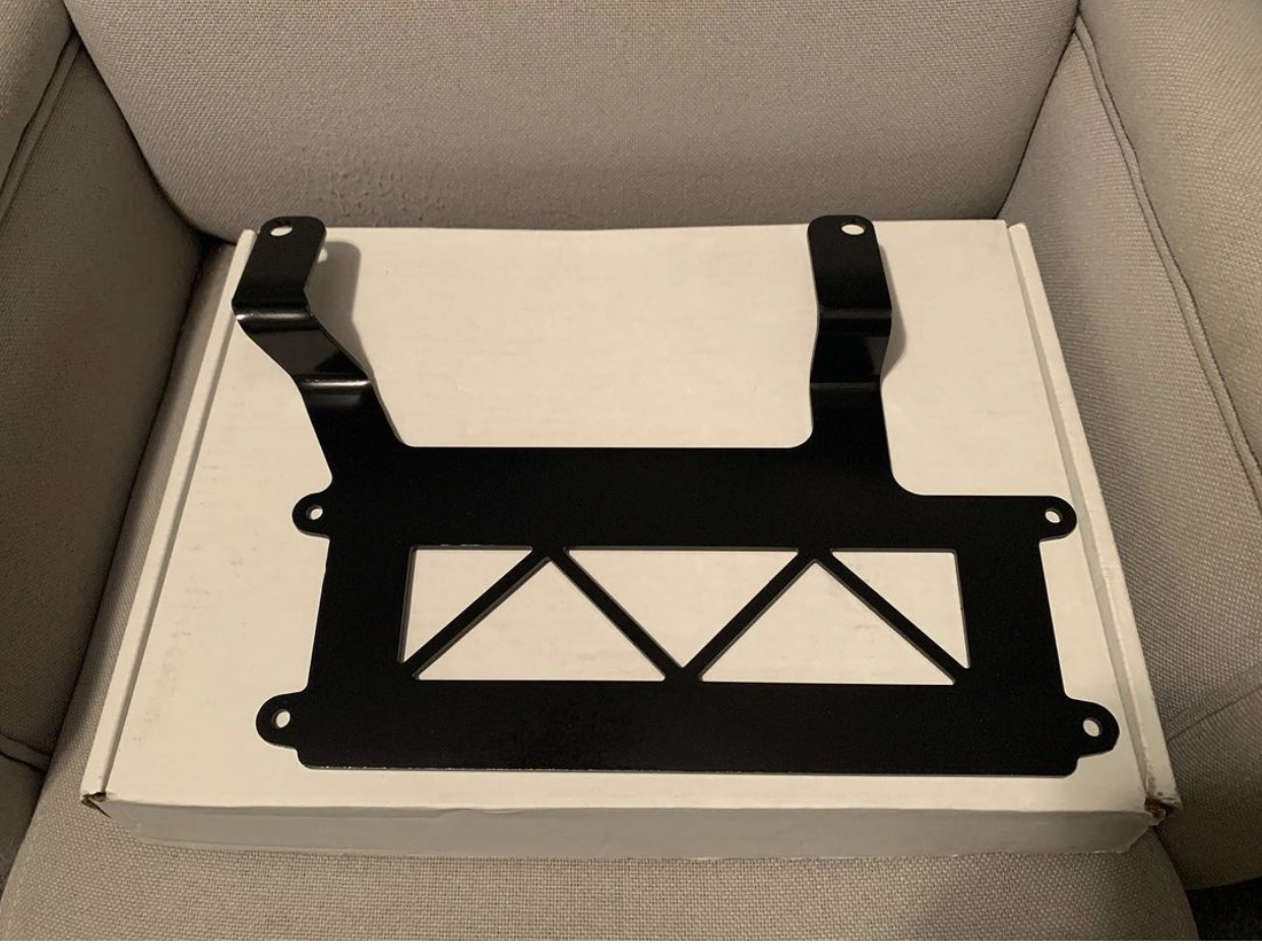

Last minute upgrade. I picked up a Dominator ECU to replace the HP. Possibilities are endless now!

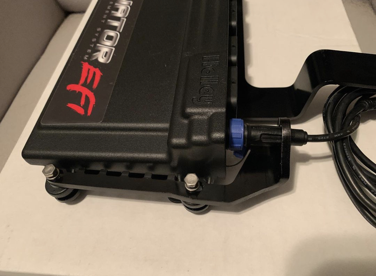

Also grabbed one of the Holley Dominator mounts made for under the passenger side seat of a Fox

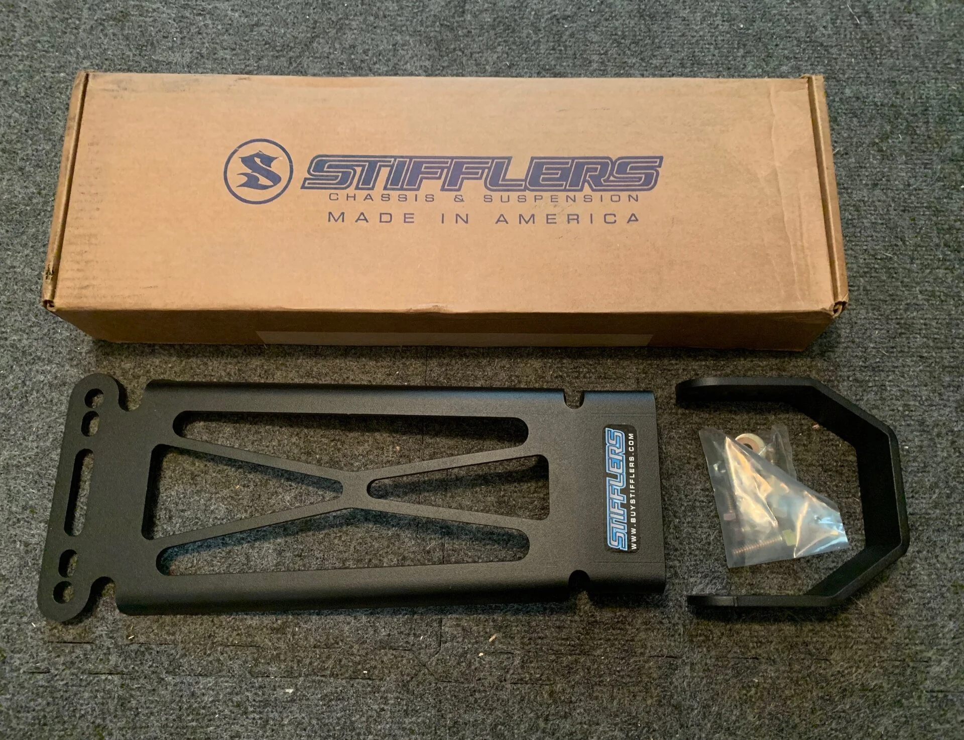

I grabbed one of the Motion Raceworks USB cable brackets too. It bolts to the ECU mounts and has a slot for the USB cable to sit in to keep it from getting damaged or broken off in the ECU:

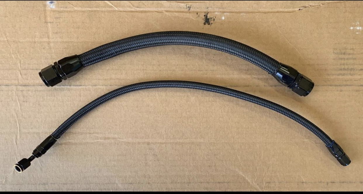

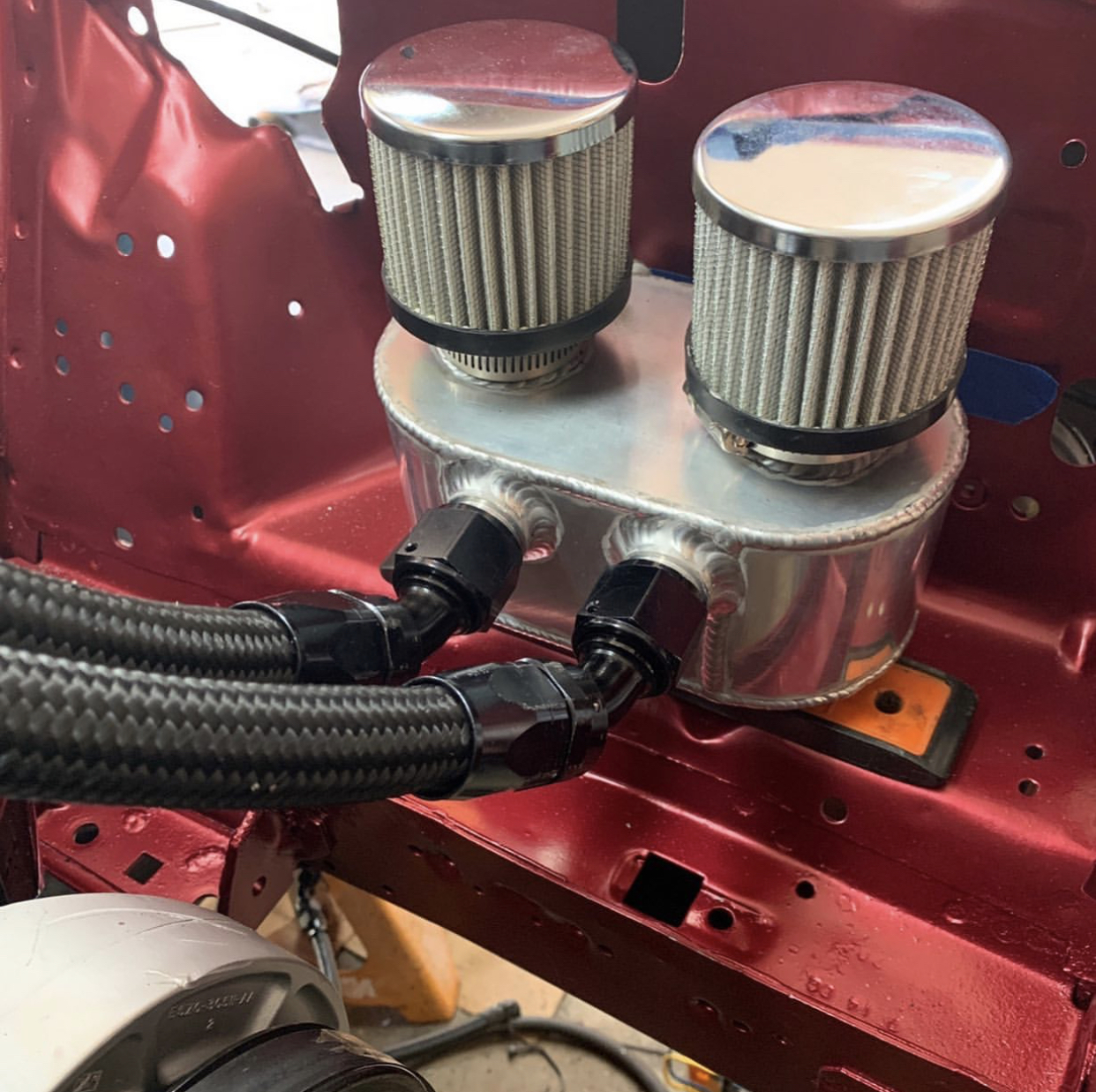

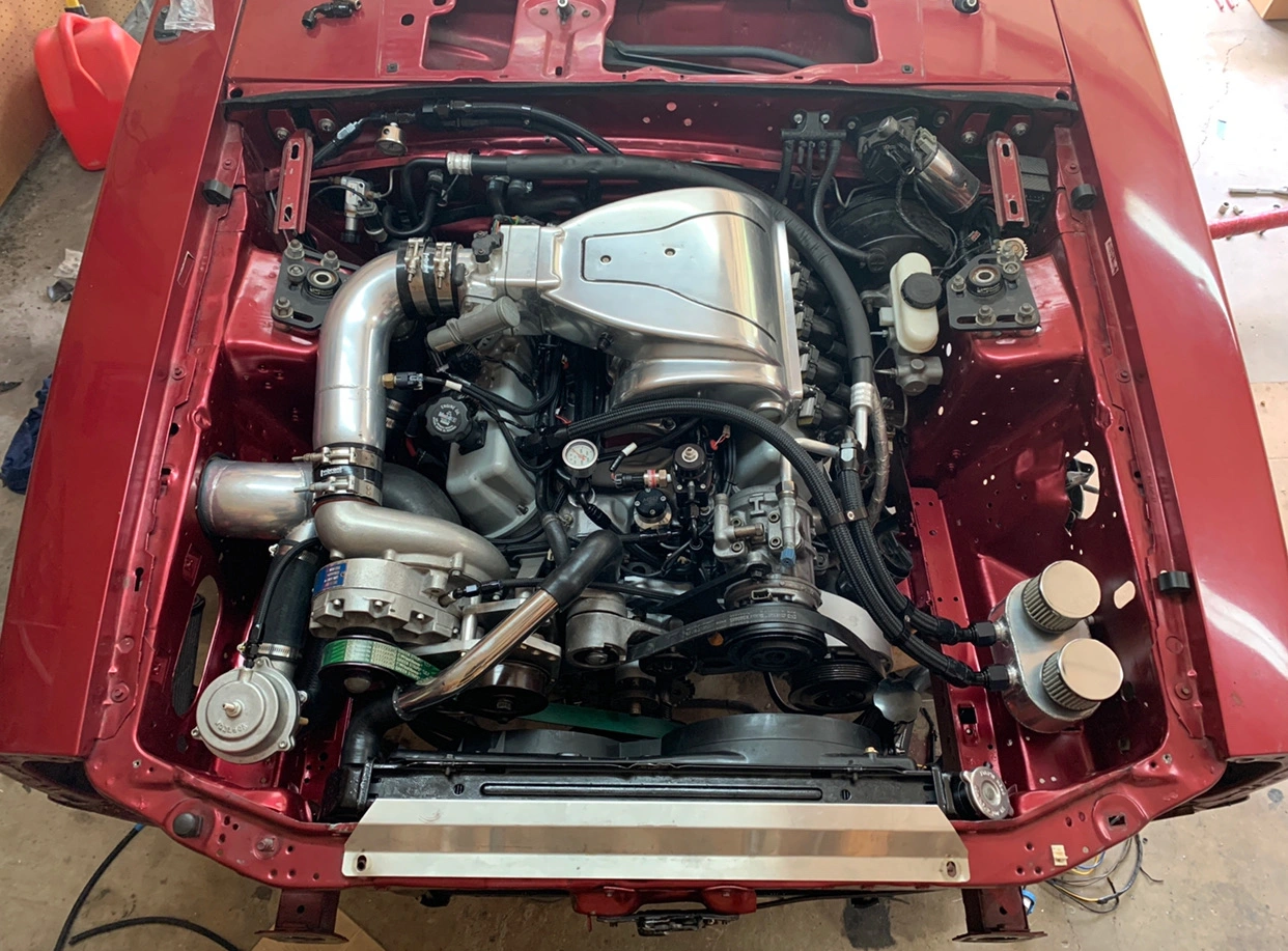

I can’t remember if I posted but I did get my oil feed and return lines made for the supercharger

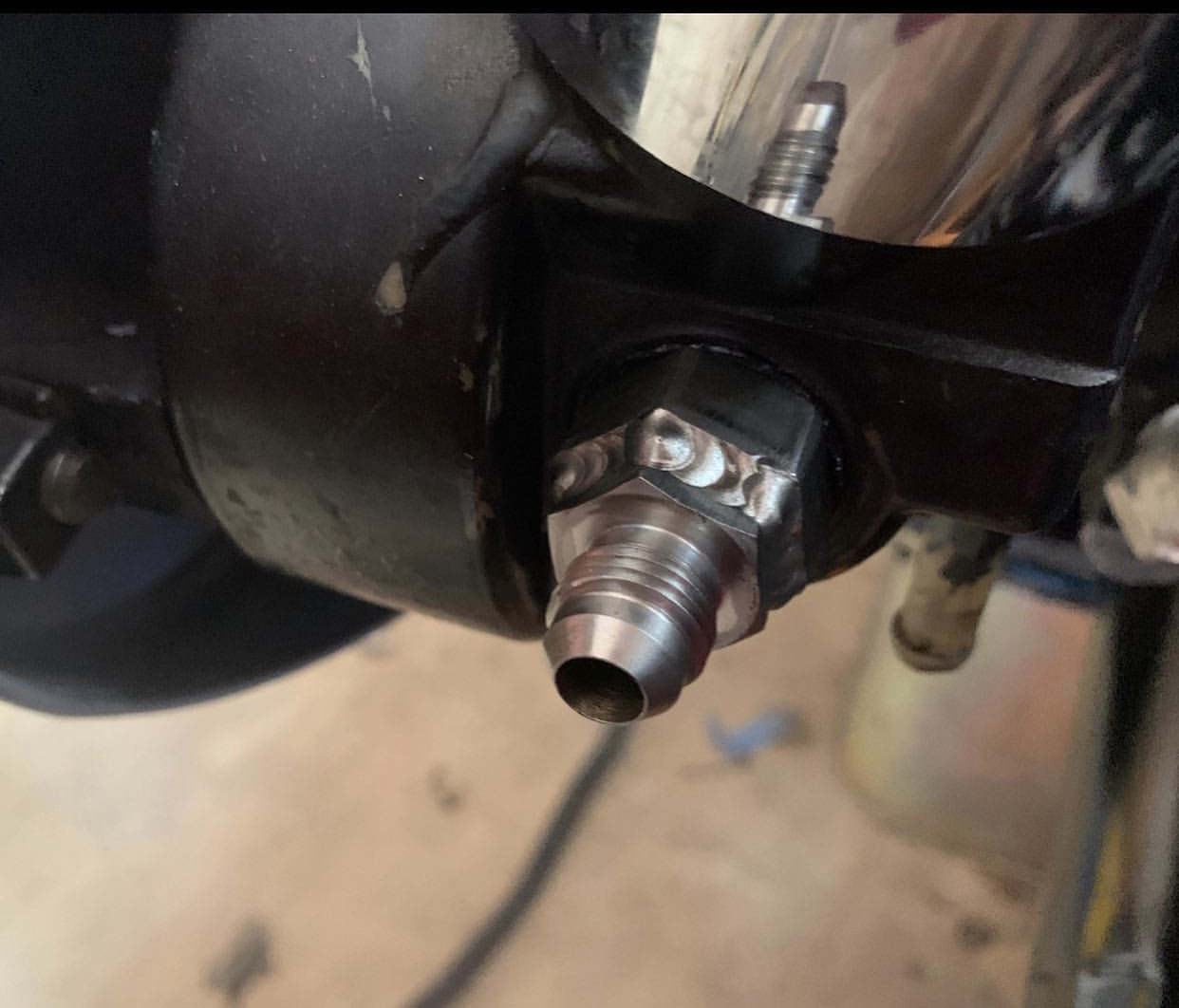

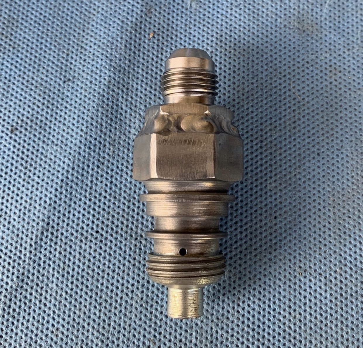

Also had a 6an fitting welded on to the fitting for my power steering pump. It’s a screw in adapter but I wanted to have it welded so I never have to worry about a leak there
