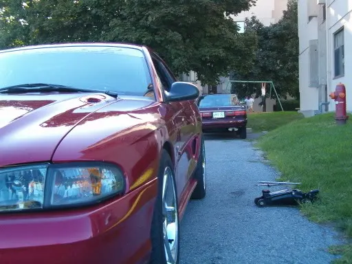

The spacers are huge, I'll attach a pic here....I honestly don't know about the threads/turns issue, but now that you mention it, I would like to know this as well, for safety sake. thanks for the thought though....would suck to lose a wheel on the highway
