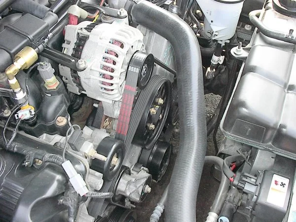

I have to admit when I installed mine I went out and bought the biggest impact wrench I could find,...it worked. I use that wrench a lot now to loosen other large fasteners. I like you tried everything to get that big crankshaft bolt out!

The crank pulley on the 4.6's isn't a balancer, it's a dampner as our engines are internally balanced. Unless you buy a really fubar set of pulleys then vibration shouldn't be a problem. Steeda pulleys come with an SFI approved dampner. Most of the piggyback pulleys work well to but they interfere with the use of timing adjusters(some of them). Underdrives are a proven power adder going way back. The gains seen on a 4.6 won't be as big as say a 5.o or the 3.8 is due to the fact that the factory pulleys are designed to be quite effecient from the factory. I put pullies on my buddy's 98GT and it was a pretty easy install and he's has zero problems with charging and heating-and we are in Texas where it's already in the high 90's.
