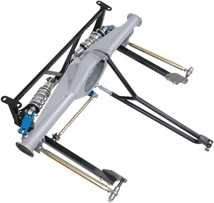

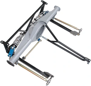

Can you be more specific about the goals of the project and any limitations or guidelines you need to adhere to?
Horsepower?427 cid 650 hp on motor, it will also have a nitrous system
Drivetrain? 5 spd
Tires type/size? street 275/60 BFG drag radial, track 28x10.5 slick
Target 1/4 ET? 9.50
Target 60 ft times? The best possible times
Cutting, welding OK? absolutley
Is appearance important? yes
Will the front suspension be set up to drive well on the street or made to better transfer weight for drag racing? the car has a rod and custom front suspension
with adjustable coil overs
Do you want a street car that you can safely run at the track? Or a drag car you can safely drive on the street? Sounds silly but there really is a very significant difference.
650hp, 9 second street car? parallel 4 link
To use the g-Bar system safely in this application, you would need to tie the suspension cradle directly to the roll cage. I'm not worried about you hurting the suspension system, but my concern is the area of sheetmetal (upper shock and pinion mounts) that the cradle attaches. As an example, Fox Mustangs used in drag racing or even road racing commonly have to reinforce the upper arm chassis mounts to prevent tearing the sheet metal. And this is on a vehicle that was designed to carry heavier loads in that area. Our cradle increases strength in this area by adding a partially boxed structural plate where the tubing meets to spread load to a much greater area. Better? Yes, but welding/bracing the cradle against the roll cage is a much better way to do it. You'll still gain the instant center adjustment you don't get with leafsprings, and the additional welding to tie-in the cradle shouldn't complicate the installation too much.

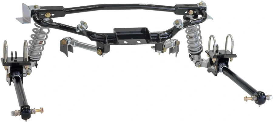

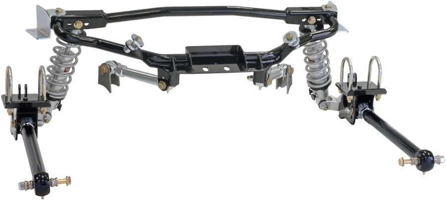

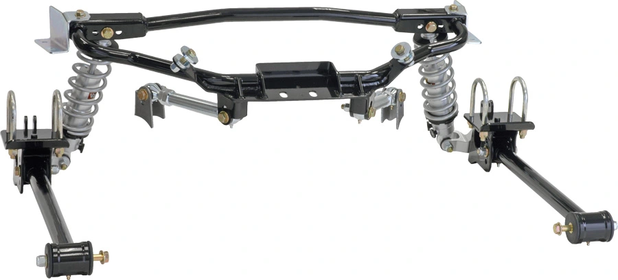

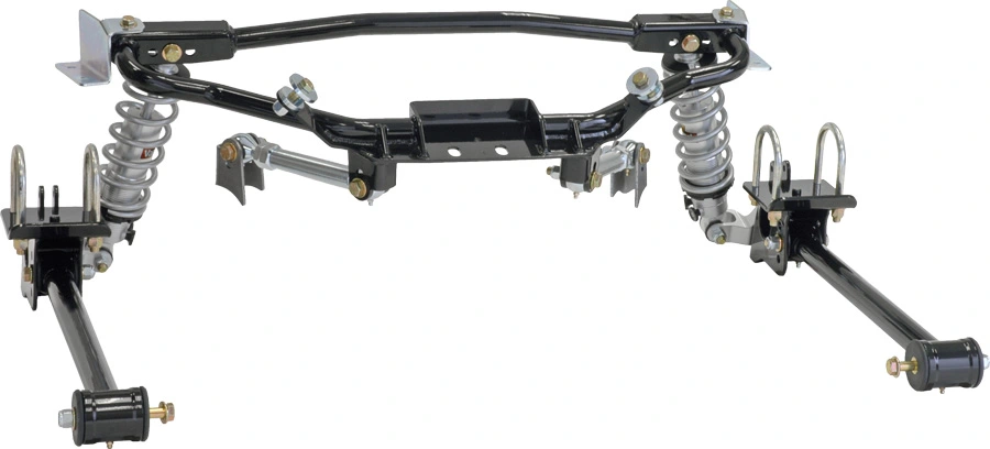

The addition of the g-Bar system and it's many configurations has allowed us to narrow the recommended performance envelope of the pushrod coil-over suspension to predominately track handling use, for which is was originally designed. The pushrod coil-over still offers the best housing control and handling performance, but the g-Bar system's scalability and additional suspension travel make it a much better choice for a vehicle seeing regular street use.
Just to put the "performance per dollar" scope into perspective...
The pushrod system is priced at $4989 and includes everything pictured (with double-adjustable shocks), except the bolt-on driveshaft loop.
The g-Bar system starts at $1739 for whats in the picture (single-adjustable shocks). You use your existing leafspring housing, and subframe connectors are not included.
A fully optioned g-Bar system with billet pivot-ball arms, FAB9 housing, double-adjustable shocks, housing mounted anti-roll bar, and subframe connectors comes in at about $4500.
