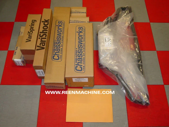

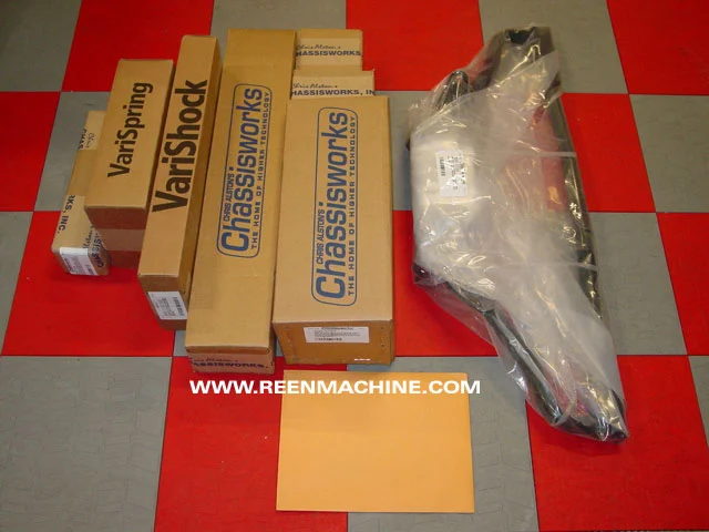

I just received two g-Bar systems this morning and the hardware looks awesome. Everything was packaged extremely well -- I've never had to use a pry bar to open a cardboard box before. Definitely nothing to worry about for international shipments.
I'll try to post some pics later after I get everything unpacked.

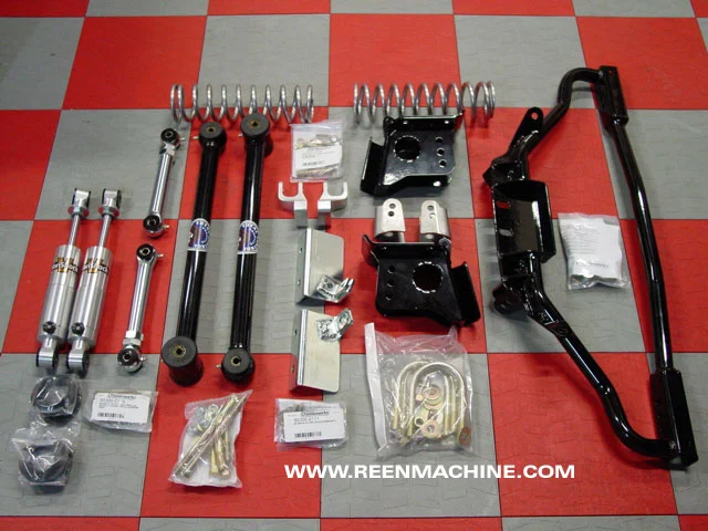

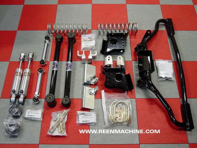

So here are some pics.
Like I said before, the packaging was bombproof. All of this stuff was sealed into one large 89-lb. box and packed so well that nothing would budge.
Here's everything unpacked. The quality of the components is outstanding. The powder coating is very nice and every other part is either aluminum or plated so nothing will corrode down the road. Each box and bag has a bill of materials describing the contents. This looks like a class act all the way.
I kind of find it hard to believe it sells for $1739.
