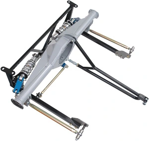

The addition of the g-Bar system and it's many configurations has allowed us to narrow the recommended performance envelope of the pushrod coil-over suspension to predominately track handling use, for which is was originally designed. The pushrod coil-over still offers the best housing control and handling performance, but the g-Bar system's scalability and additional suspension travel make it a much better choice for a vehicle seeing regular street use.
Just to put the "performance per dollar" scope into perspective...

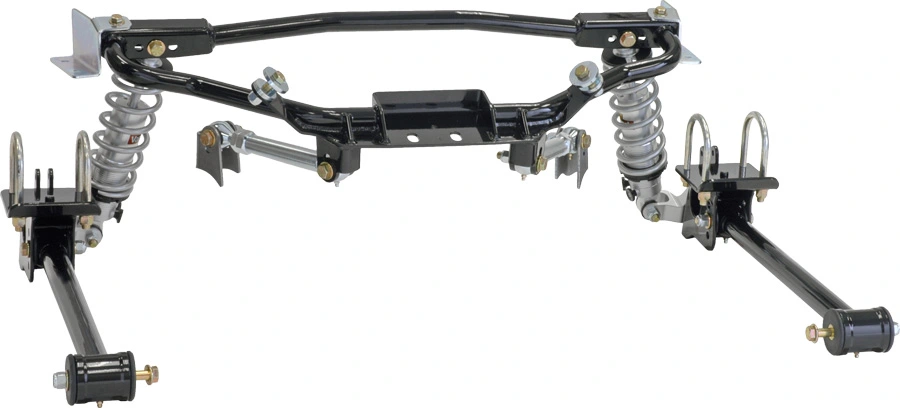

The pushrod system is priced at $4989 and includes everything pictured (with double-adjustable shocks), except the bolt-on driveshaft loop.

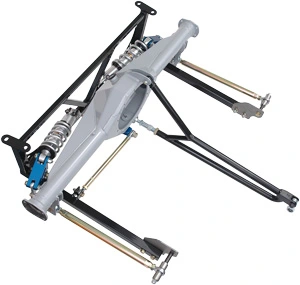

The g-Bar system starts at $1739 for whats in the picture (single-adjustable shocks). You use your existing leafspring housing, and subframe connectors are not included.
A fully optioned g-Bar system with billet pivot-ball arms, FAB9 housing, double-adjustable shocks, housing mounted anti-roll bar, and subframe connectors comes in at about $4500.
That's what I was thinking - I remember the pushrod system being talked about in terms of racing all the time. Also I hadn't realised you get the subframes and cross brace with the system - I always wondered whether you could get the setup with no mounting point for the torque arm - pretty stupid thinking I guess. The package doesn't seem all that much more expensive.
