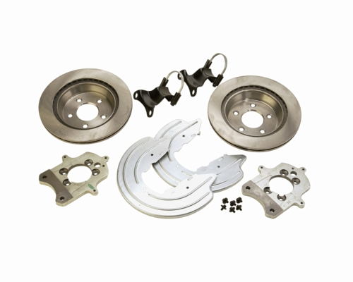

Might be a better deal to buy the FRPP M2300M Cobra rear disc conversion kit from Ford. It has the backing plates, splash plates, anti-moan brackets, and two new rotors. Then just sell the rotors by themselves to recover some $$$$. The kit runs like $180. Just something to compare the individual prices to. Most likely the individual prices for the backing plates and anti moans will be over $200.
Good luck!
