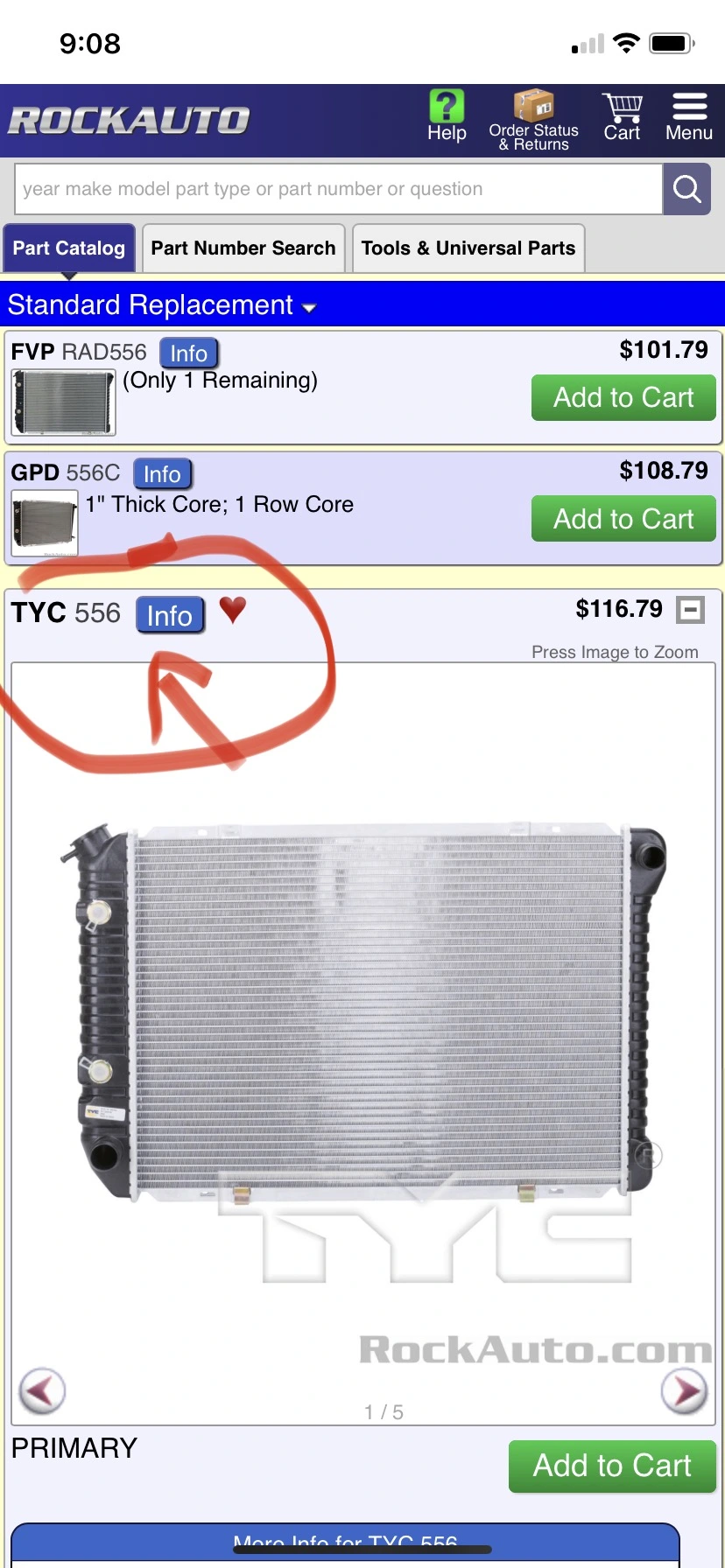

I replaced the stock radiator in my 1991 two years ago with a stock replacement from RockAuto and it’s been great.
Not an upgrade, but if you’re open to a stock replacement keeping it all the same then this is an option. It worked out great for me…
RockAuto part TYC556.

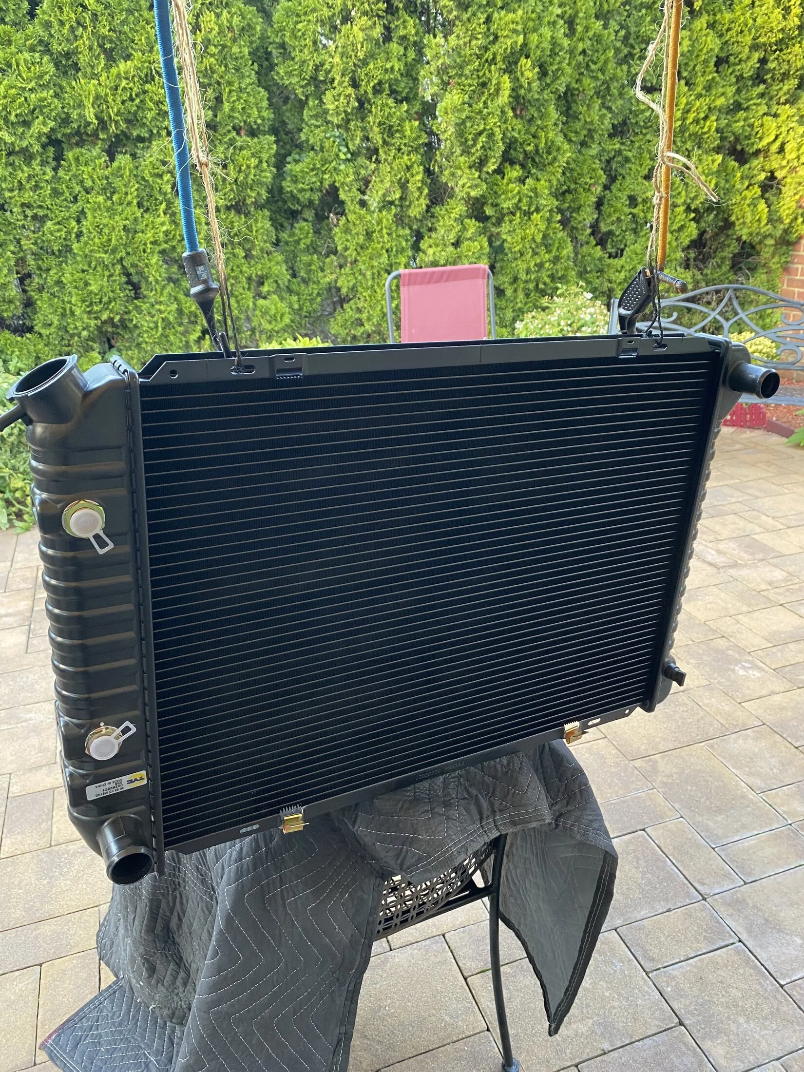

I sprayed it with Eastwood Radiator Black before install.

I ended up doing just this. I opted to use high temp engine paint and it turned out great and looks stock.
