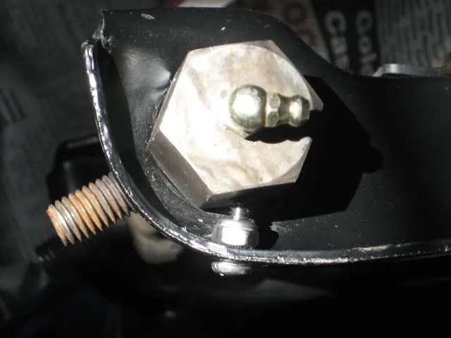

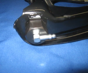

Make a small, narrow grove across the TOP of the shaft like this (I use a thin cut off wheel on a die grinder). It gives the grease a path to where it's needed most. It helps a lot to de-burr and pre-lube everything. Put the shaft back in and make sure it's centered in the arm. Snug the big nuts down and back them off one flat (1/6 turn), then weld on a tab or put a nut and bolt in place to keep the nuts from moving.
You should be able to find something that will work for an O ring at a hardware store, if not, let me know, I have some.
TAB
Nut-N-Bolt

The nut and bolt shown either is shallow does nothing, or a groove compromising the strength of the shaft must be cut. A few tack welds takes far less time, and adds a little strength. Welding on a tab to block the hex cap won't work in extreme cases, it doesn't unscrew, it works it's way straight off. Just weld the caps. It's quick, easy, and lasts. And if you ever need to rebuild again, a few quick shots with the whiz wheel and it comes right off.

I will either tack weld the caps or install a nut and bolt.
