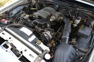

Some guy posted a photo many years ago with it on the driver's side. His engine was out of a town car I think. It looked very odd.

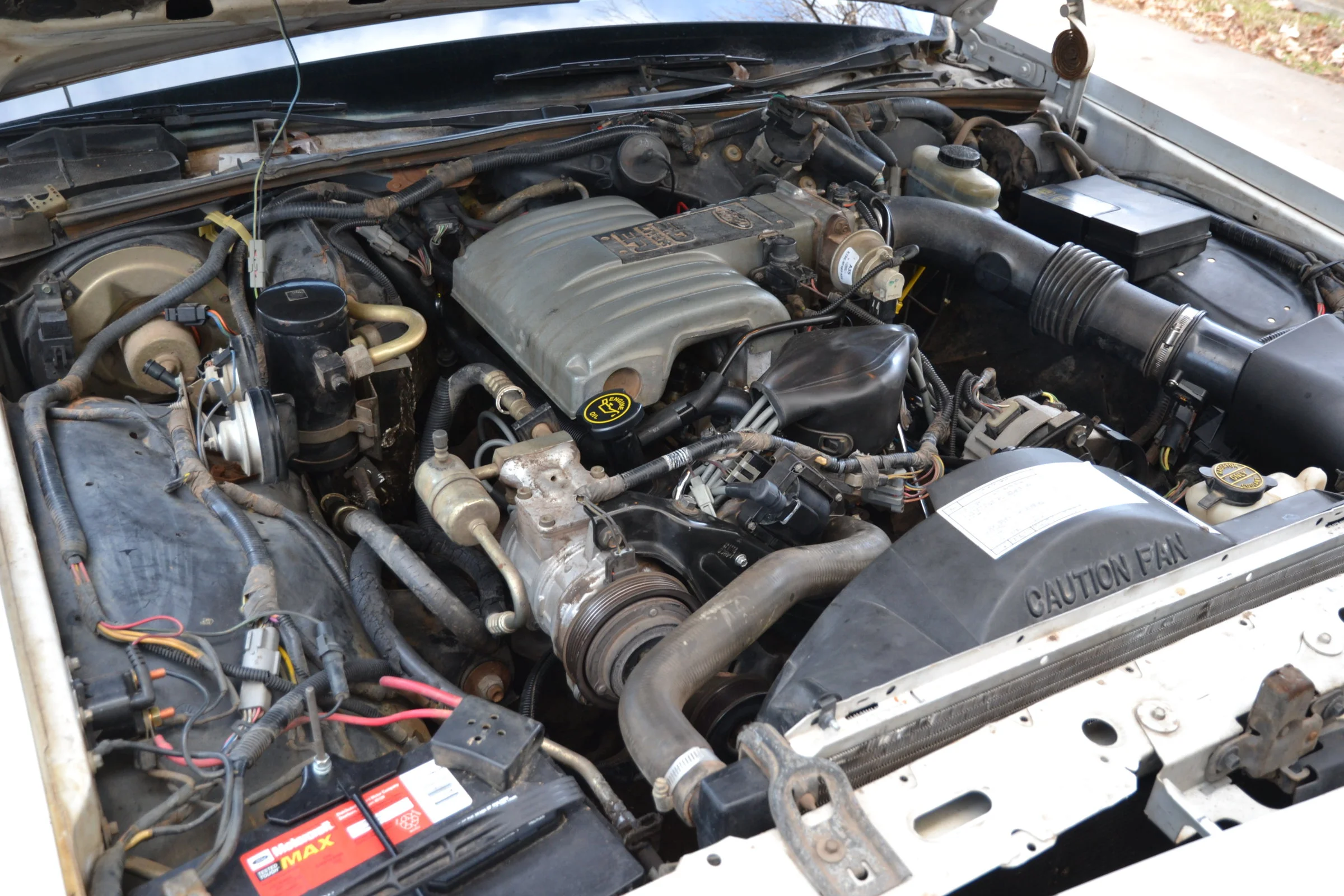

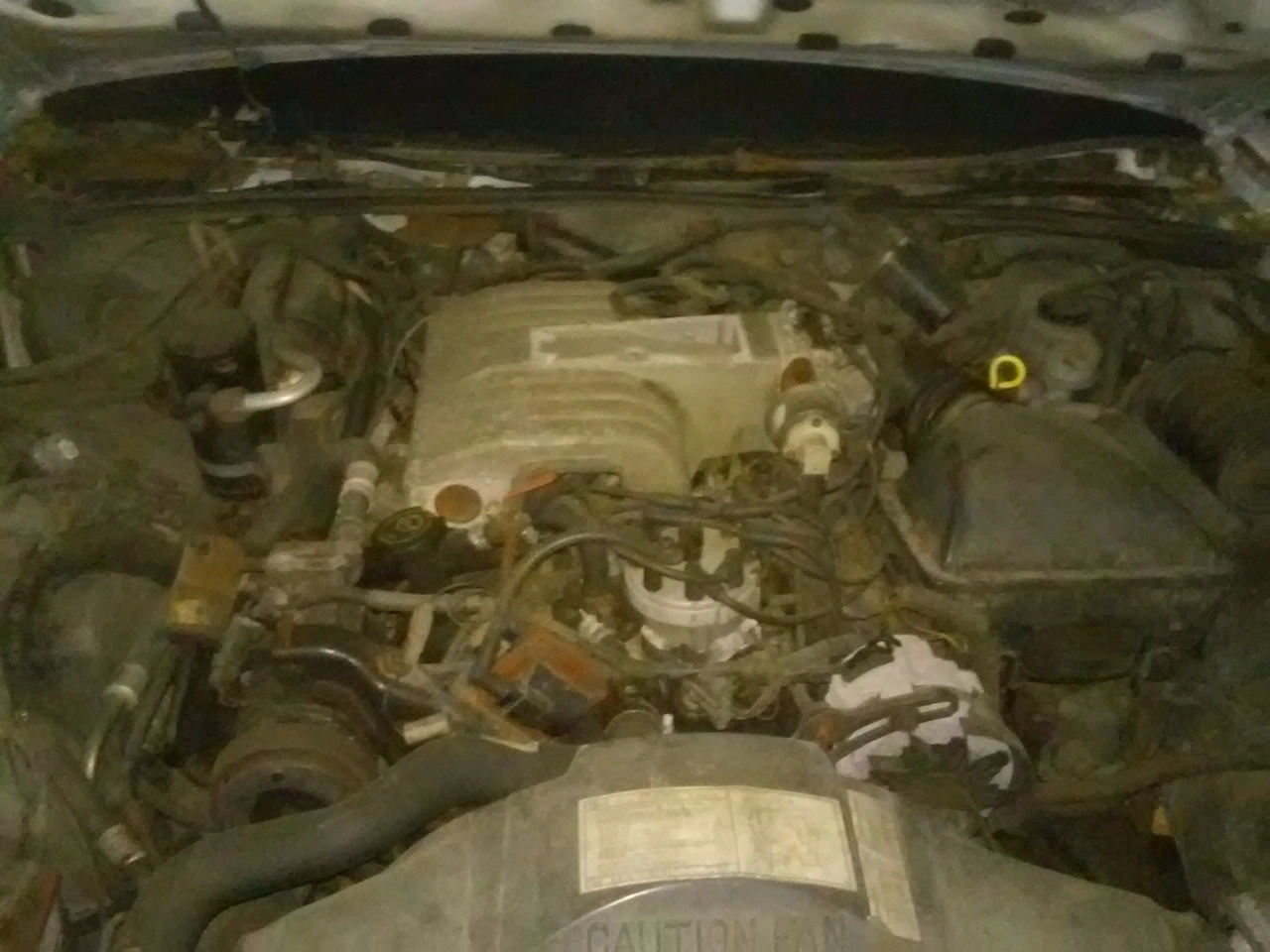

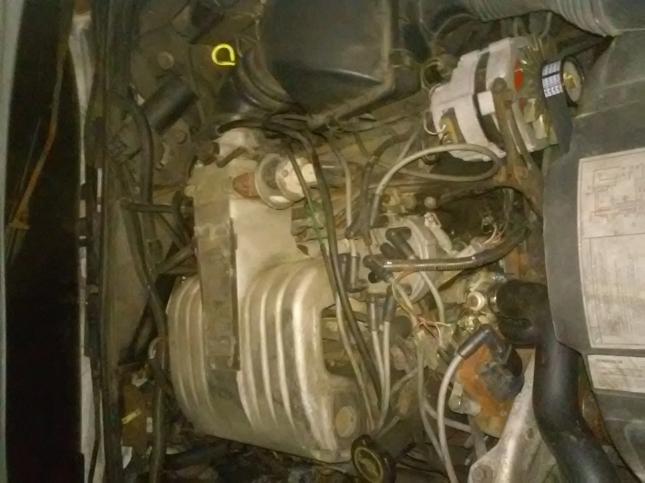

Well, these are in LTD wagons, an 87 and 89. Both breathe through the driver's side and battery is on passenger. The 87 is the first pic and is Canadian.
Ok not dealing with a mustang, that threw me, intakes can be installed either way I would think, just pay attention to vac lines, what intakes are you looking at?
Yes, it's that simple. The stock HO upper intake can simply be flipped around and bolted to your stock lower. The lower intake on your car is the same as the stock Mustang HO lower.

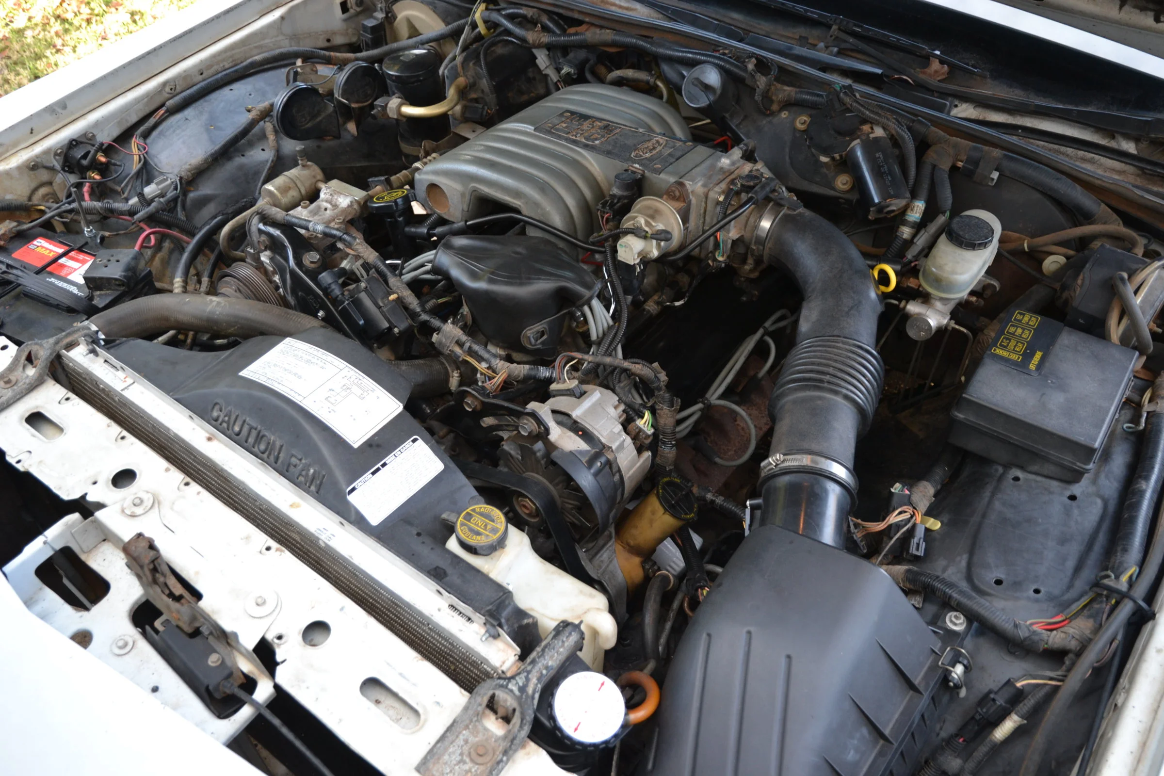

Below is my '90 Grand Marquis. Not sure why Ford did these and only these cars the way the did. I think it has something to do with the placement of the A/C compressor, lines and box in the engine bay.
