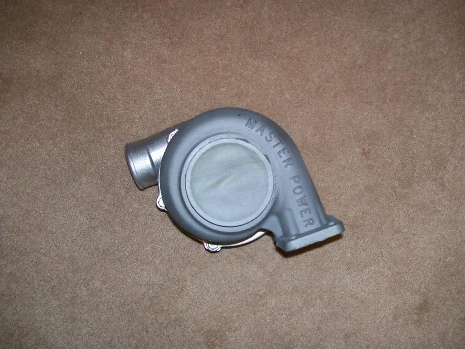

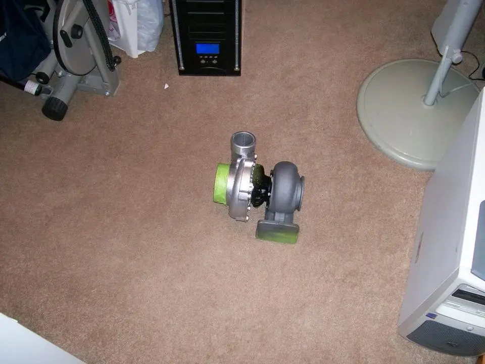

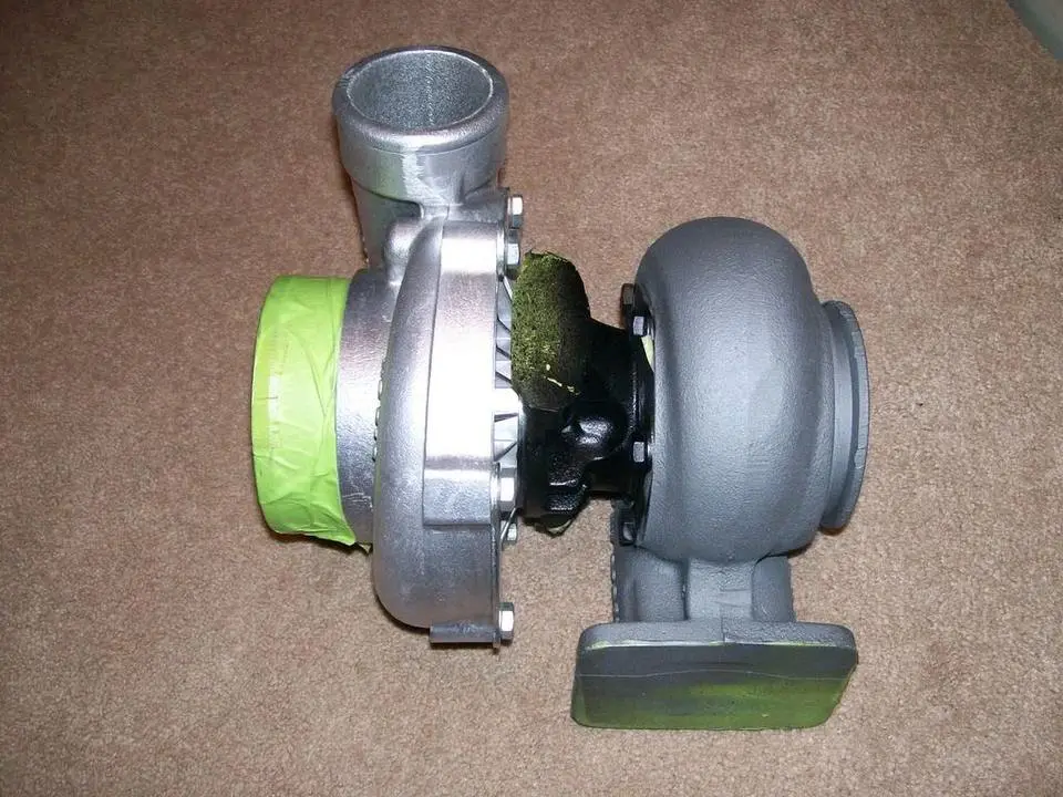

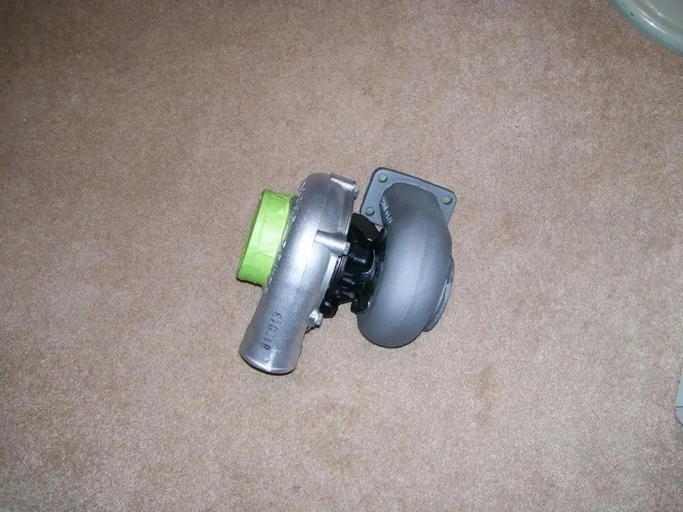

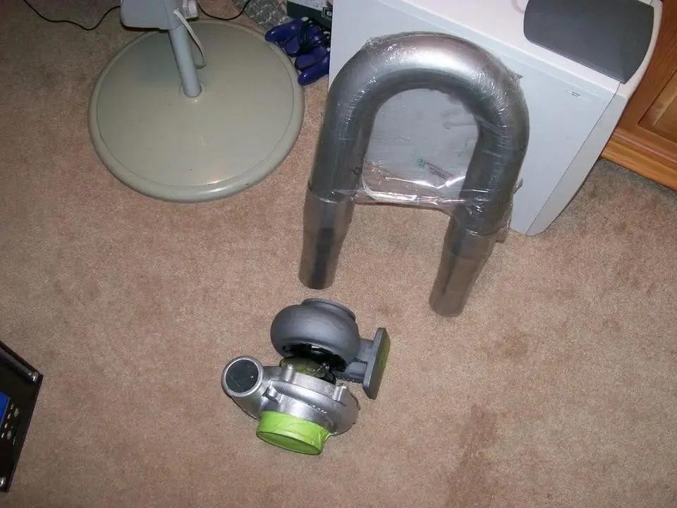

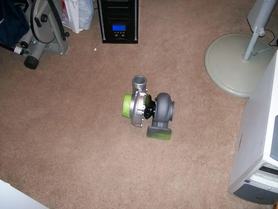

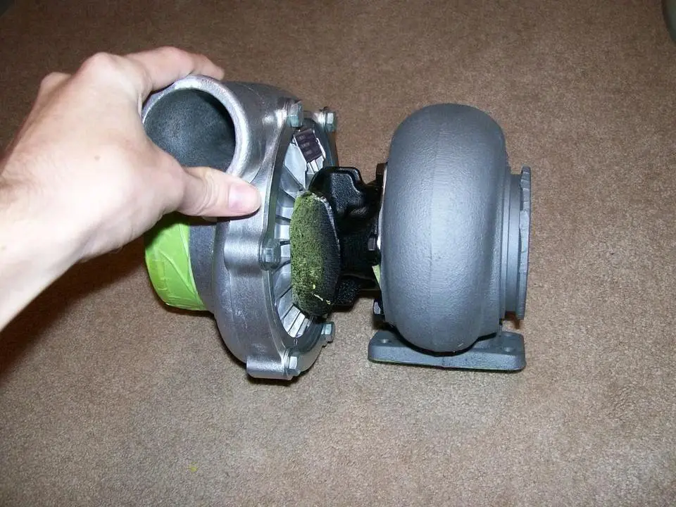

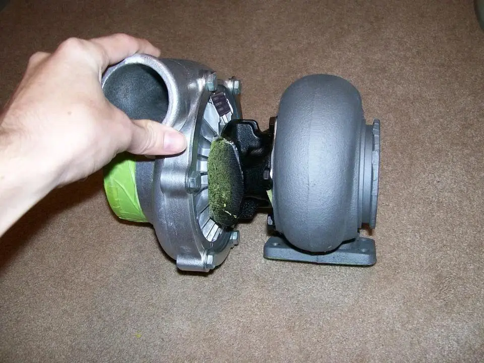

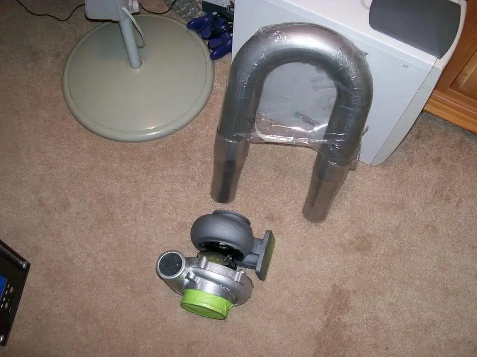

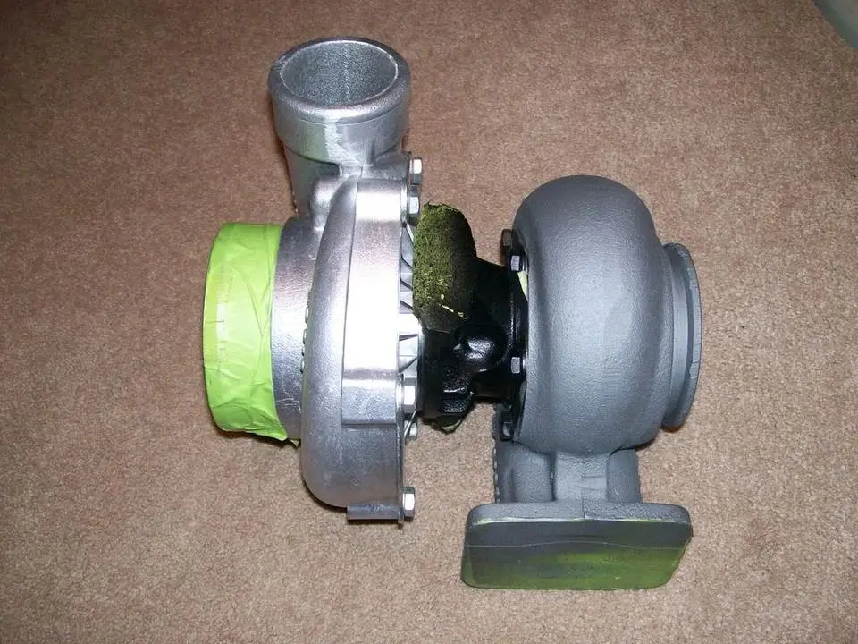

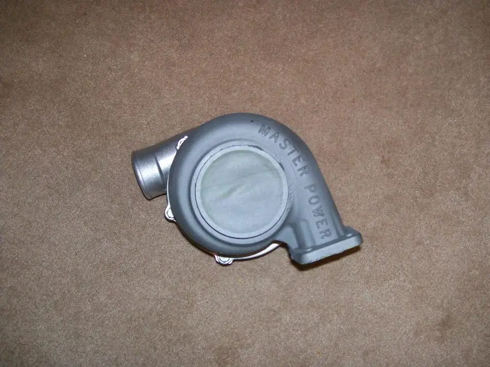

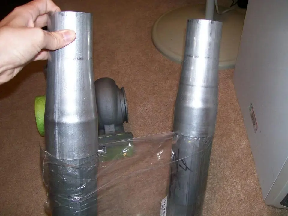

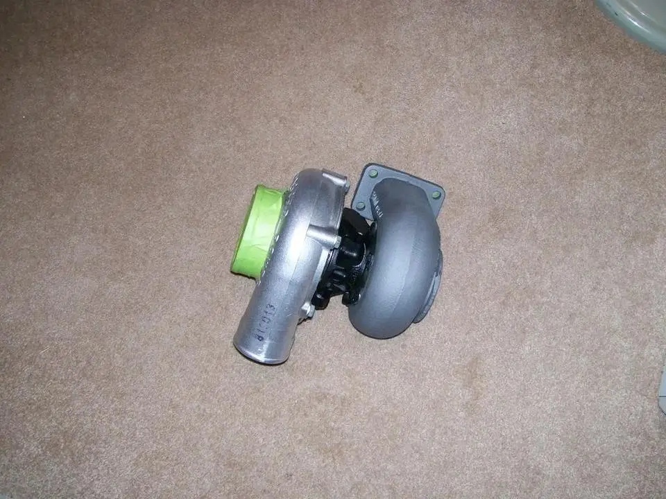

Ok as promised, pics of the now painted turbos. VHT "flameproof" ceramic spray on teh hot side, and black high heat engine (500*) paint on the center section. Hot side helps keep heat in, which helps also with spoolup....also prevents rusting. But last time I made the mistake of not painting the center section and it rusted on me :( . So im definatly not making that mistake againt.

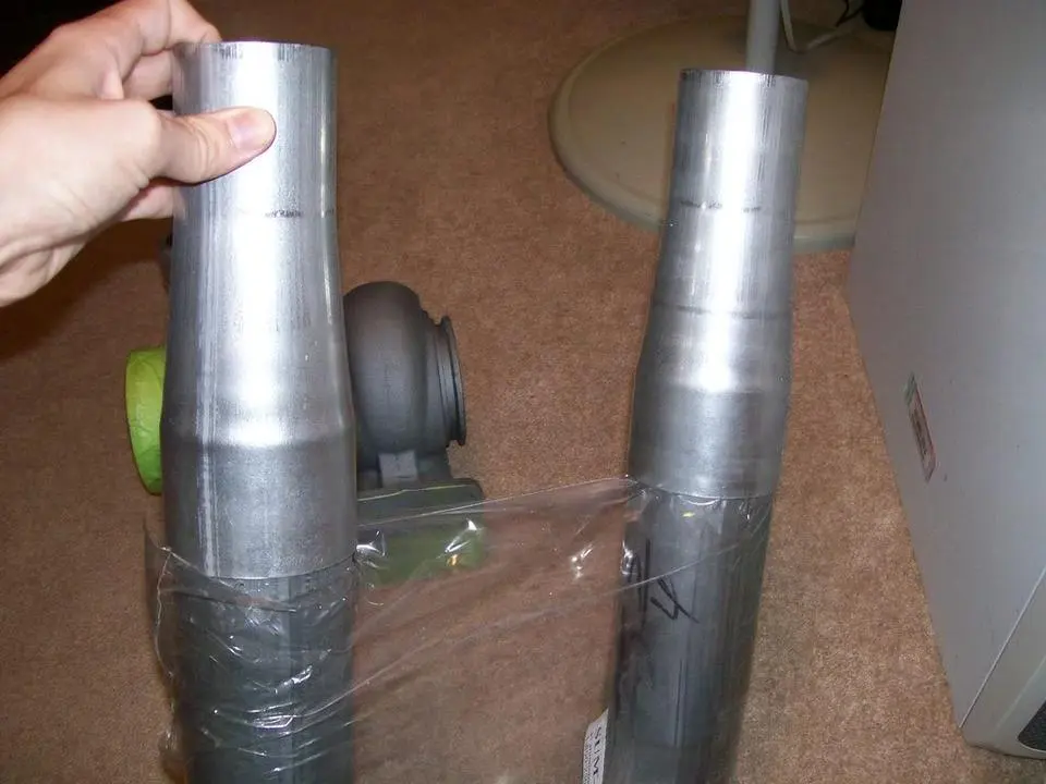

And the 3 inch U bend (future down pipe), with a reducer cone to tie back into the 2.5 inch exhaust.
