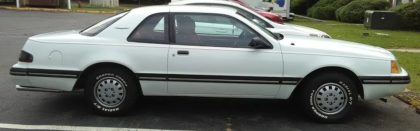

Im currently doing a motor swap in my 88 Thunderbird Sport for a 1990 HO Mustang motor but keeping the stock 7:5 rear and AOD. Will this setup be sufficient with the increased motor power ? Also swapping stock 2:73 gears for 3:45's...

Thanks for the helpful info...no, i have no plans of racing the car. Maybe just a little fun with burnouts now and then lol. My big concern is the transmission being 30 years old and stock....it still works great but with the added HO power i hope it keeps up. I am adding an aod cooler to it as well. Ive also kept Lucas treatment mixed in with the type F fluid
