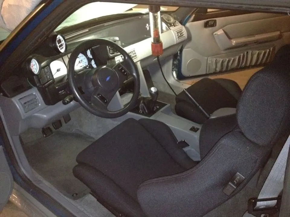

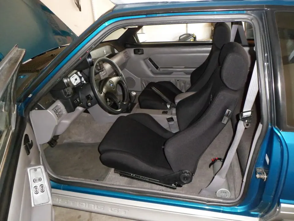

I put a tilt column in my 93, I scored a complete tilt set up from the local yard for 60 bucks. I also got a nice SVO wheel to complete the look.
No grinding for me it just bolted right in.
88 wheel
SVO wheel
