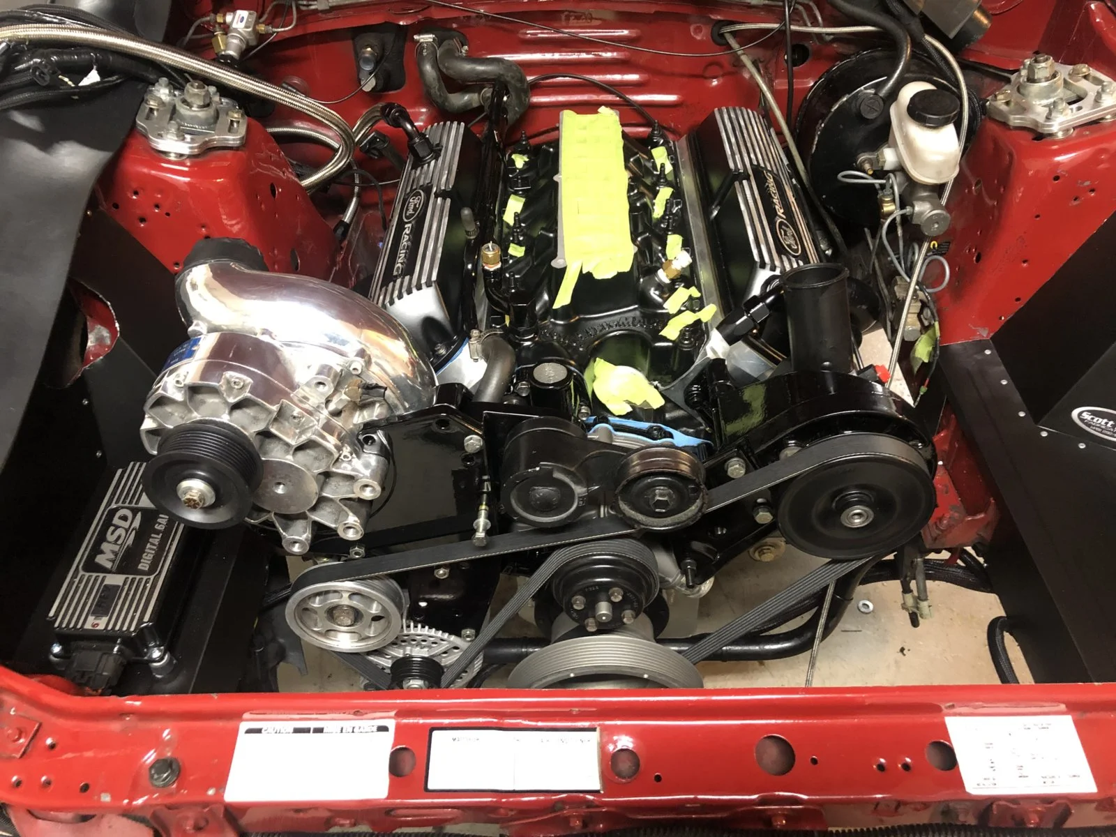

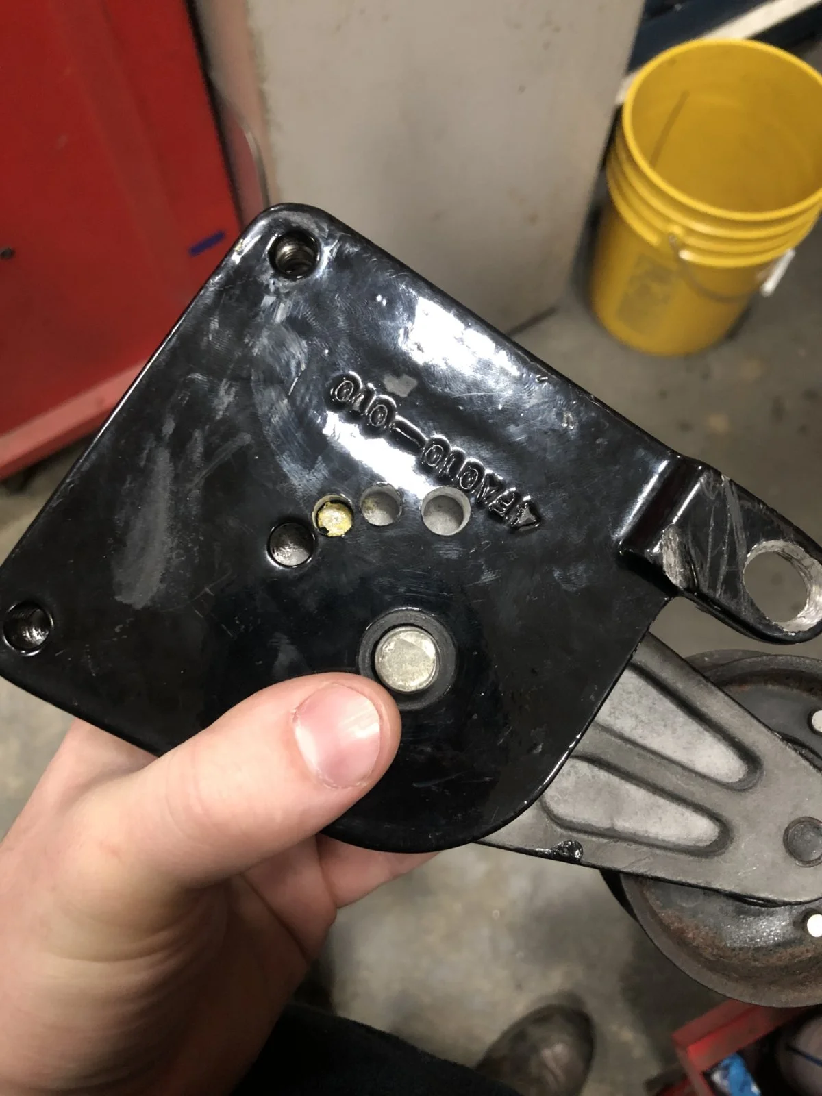

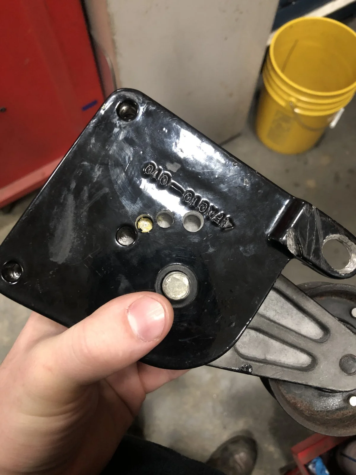

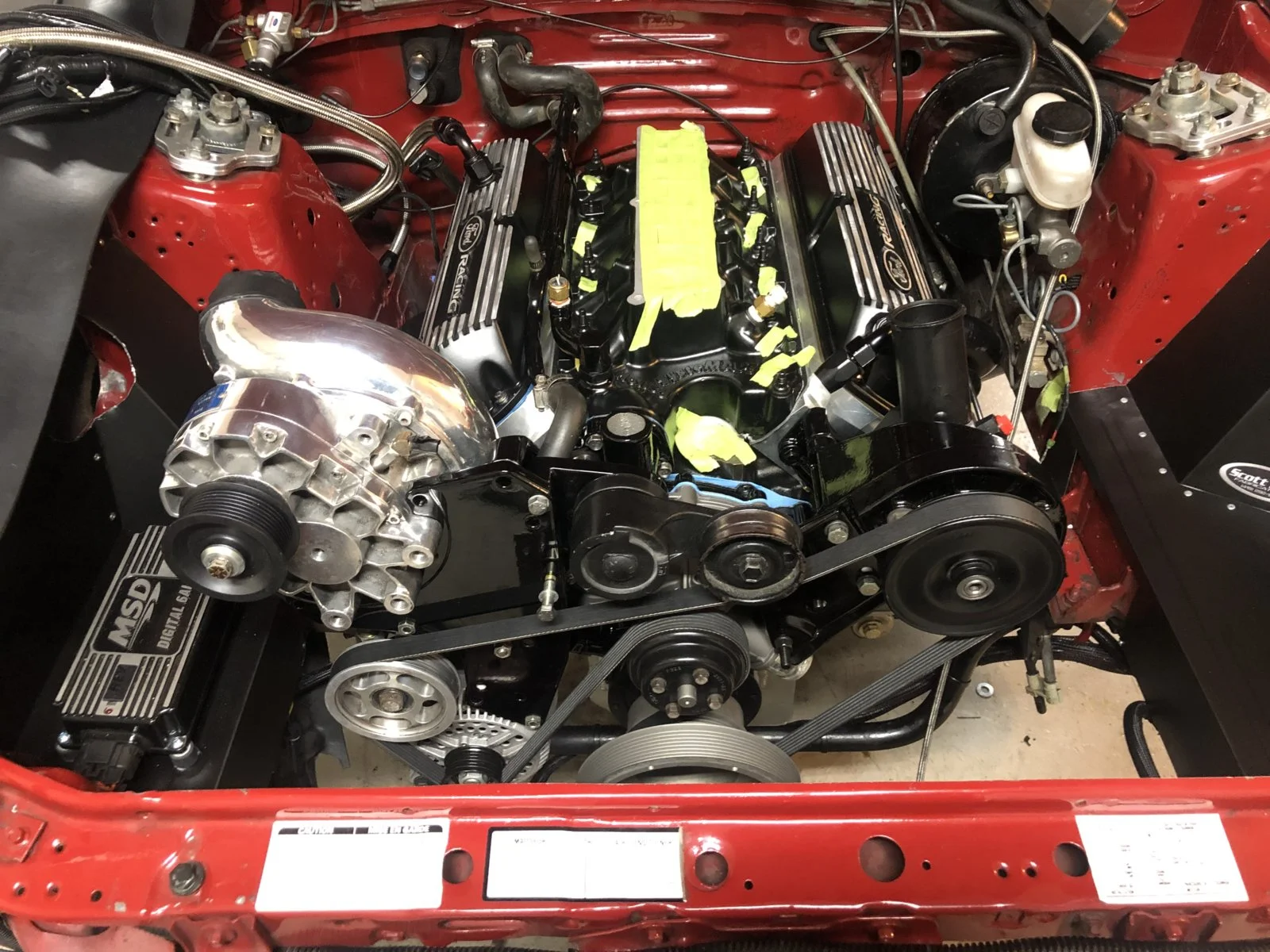

In order for the belt routing to be correct you need to run a smog delete pulley . If you’re running no ac and moved the pump up like I did with a factory delete you need to make another dowel hole in the belt tensioner to get it right or just take the nub off .
Here’s some pics before the rest of my bracket went on .
