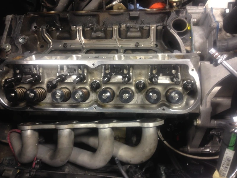

i have one side in,as luck would have it the parts store that had 2 gaskets in stock was closed because of a wind storm we just had!....only was able to get one side!.....and long tubes suck!!
very nice- those parts look like new. I'd tape over the distributor opening. You don't want anything falling down there.
I can speak from experience on that one, had the brass nut from my autometer temp sender fall down that hole when i first put tge explorer motor in. Needless to say i was pissed i had to take off the pan again before even being able to start the thing.
thanks for the tip!
