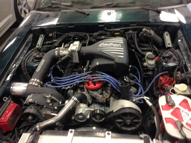

V3 Almost!
This pic is better:
Check for gaps and fill from behind/beneath the head surface.
thanks for looking out for me.....i put a bit under the tab of the head gasket,and on top.....also put a big bead of right stuff where the cork supposed to be....so i hope im good...!

ok,its back together!.....ran it for 20 mins and "so far" oil is clean!....i didnt have time to take it for a drive,so ill check the oil and coolant level tomorrow and we see!......i hope i got this **** beat!!!

ok....think im on my way.....cars holding water....temp in the shop 180-190.....and oil is clean!
thanks for the help on this one boys,i appreciate it..
one thing we have to talk about though? now that im really looking,i do notice some sweating under oil cap?....the breather side is not as bad,and i just ran some new oil in it,havnt drained and flushed yet but we see,not sure if it like that because i have no more pcv?....but for now im winning anyway!

Short trip? You'll get a little condensation under the oil cap if you don't run the car around for a while at full operating temperature. Short trips will tend to build up a nice, creamy goo under the cap after a while, making the owner thing there's an issues...when reality, you've just got to drive it around for at least 20-minutes.
