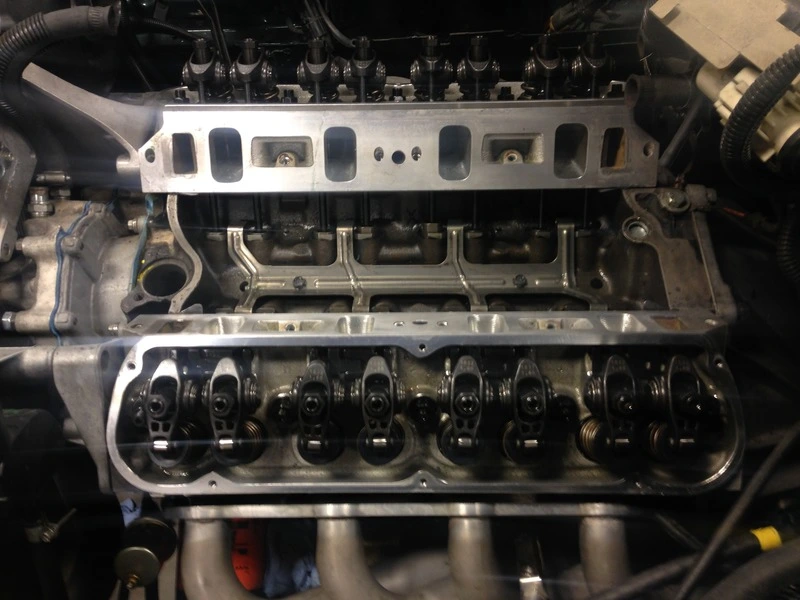

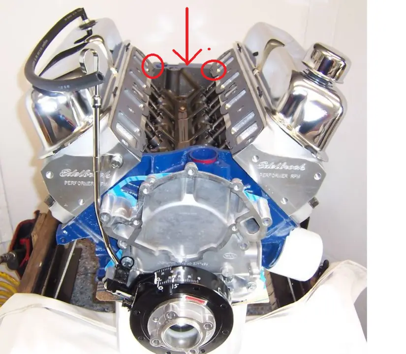

smkshw said:
im not using cork gasket just a bead of the right stuff?....do i still need to seal it?.....not sure exactly what you mean?
On the engine block, the strip of metal that you would normally house the cork gasket.
If you lay a credit card flat against the surface with the arrow and slide it left and right, you will often find a little gap that many people forget about. It usually exists with aftermarket heads.
If you take the intake gaskets off of the picture, you might be able to see that gap from this angle. That gap needs to sealed from the beneath the bottom surface of the head (from the back side) and yes... Right Stuff would be perfect.
Just look for any gaps between the heads and the block surface looking from the center, outboard.

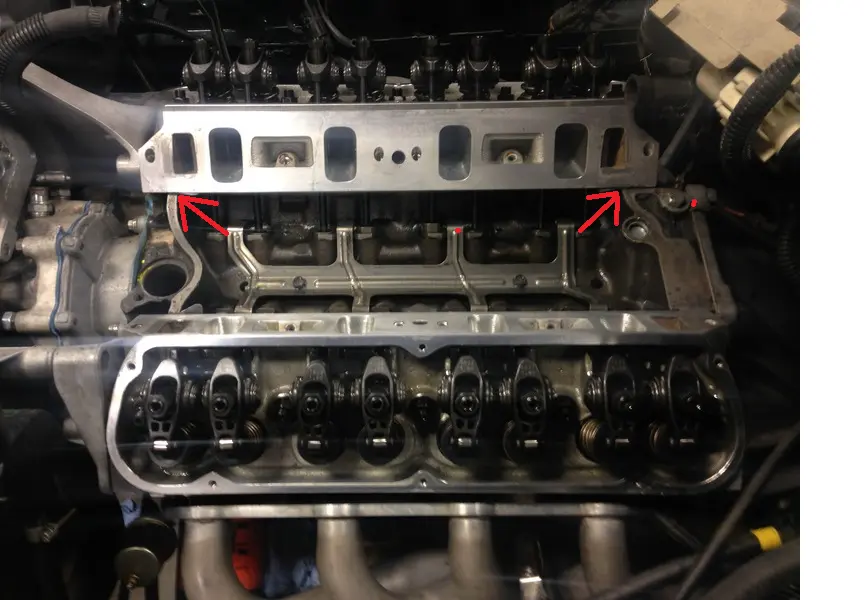

Admin Dude
Jan 4, 1985
43,428
21,634
Box behind Walmart
Sep 2, 2015
#420
  • Sep 2, 2015
  • #420
This pic is better:
Check for gaps and fill from behind/beneath the head surface.
