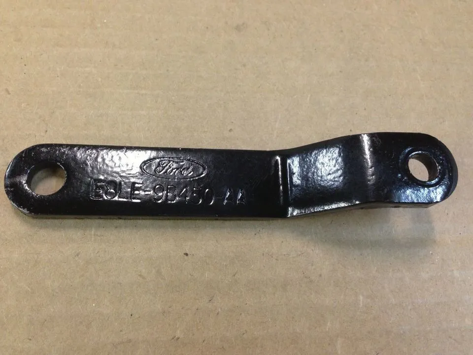

I seen where you had to buy a smog pump delete pulley kit in order to run your accessory belt. I did away with my smog pump years ago and can't remember how the thing bolted on or where any of my mounting hardware is. Did you need this little smog pump bracket or does the delete kit bolt right onto the vortech setup.

Delete pulley just bolted in,thanks though,my smog stuff is long gone,dont even remember what that was for...lol

Cool. I knew all that got relocated, but I was worried I was going to have to hunt down some hardware and that little bracket for the smog pump delete kit.

Mine bolted up,but with the delete pulley i had to bend the braket straight for it to work....

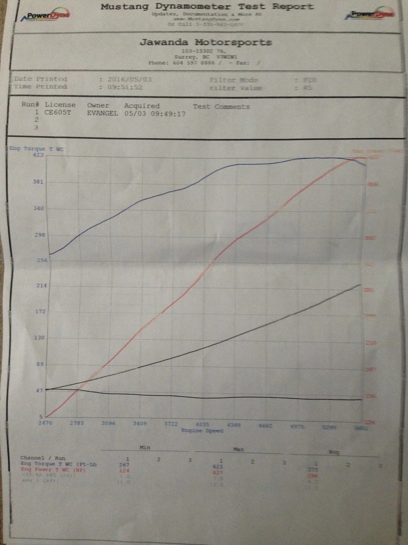

Hey guys,its been a while,but happy to report my ride is in full working order finally!
This is where it was at before i changed the injectors,10psi,and still with the head leak!

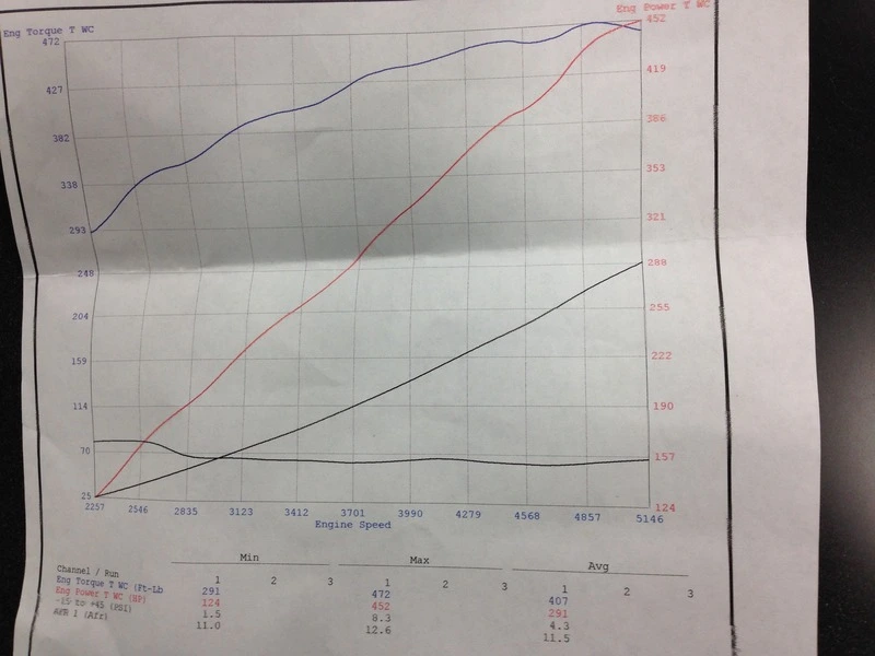

And after all my head aches,i decided to go with max 7psi to be safe for now,i upgraded to a aem 2 stage meth kit,and changed out my crap msd distributor to a stocker....

So,i did drive it with multiple tunes lol,of coarse it was more explosive before,but im just happy its working perfectly now!....and its respectable still cant complain!....the felpro mls gaskets worked great also,im glad for that!
