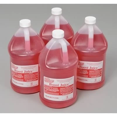

Yeah that's washer fluid for extreme colder temps more commonly sold in colder winter northern states. It has a higher methanol content than average washer fluid to keep it from freezing. Unfortunately it's hard to find in GA.
So, I buy Boost Juice from my local Summit. It's 49/51% meth/water. It's around $35 a case of four gallons. That's what my car was tuned with so I'm sticking with it.
It last's along time. I usually have to top my 1/2 gallon reservoir off about once month. It all depends on how I drive it.
