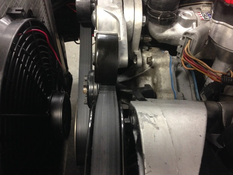

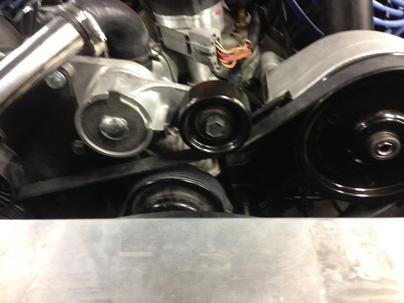

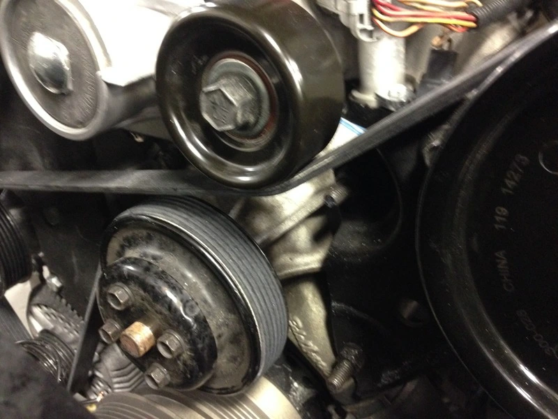

As long as it's in the groove straight on the other pulleys I don't think where it rides on the tensioner will affect it
well when the tensioner is not on its straight as an arrow?....but when i put the tensioner on the belt looks crooked to the power steering pump?.....i really dont like that eather,im going to go to the wrecker and see if i can find the liped idler pulley like it used to have and see if that helps
That's what is on mine
