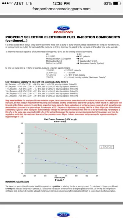

Duty cycle on a forced induction engine brings down the horse power rating on pumps greatly coupled by pump being rated to run at x psi when raising pressure changes the rating as well.
Page 3 and read the part in red
http://fordperformanceracingparts.com/download/tipspdf/properlyselectingeficomp.pdf
Reactions: A5literMan
Calculator says at 6psi of boost with your 50 lbs of fuel pressure you're at with a .65 Bsfc (typical for supercharged application ) for 350 flywheel hp as a guesstimate that you need a 30 lb injector which you have and a calculated pump of 213 lph minimum which puts the reccomeded pump size at 255lph .....
