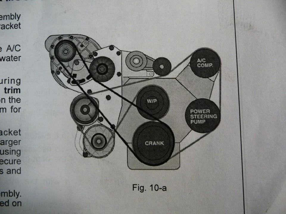

Kit instructions show the alternator stay connecting to the smog pump. I previously removed my smog pump. So now, how do I secure the alternator? Do I have to put the smog pump back in and just skip running the belt around it? Is there an option to secure the alt without having to put the smog pump back in?
84Ttop
5 Year Member
Jul 2, 2009
5,222
3,254
204
South Jersey
Oct 7, 2015
#54
  • Oct 7, 2015
  • #54
You will need to either put the smog pump back in and leave it disconnected or use a smog pump delete idler.

Looks like I need to run a pulley there no matter what. Look at the diagram. If you try and omit running a belt around a smog pump pulley, the belt route will interfere with the water pump pulley. So I'm shopping for a smog pump idler. Im surely not going to drive a smog pump that's serving no purpose.
Next question is, which smog pump idler assembly has the threaded boss built in to accept the alt stay bracket that came in the V3 kit? Pictures online dont always show exactly what you get if you know what I mean.

Here we go >> 1979 1995 Mustang 5 0L Billet Aluminum Smog Pump Eliminator Delete LX GT Cobra | eBay
84Ttop
5 Year Member
Jul 2, 2009
5,222
3,254
204
South Jersey
Oct 7, 2015
#57
  • Oct 7, 2015
  • #57
This is exactly what you will need
JD1964
there is enough sticking out to grab on to
Jun 28, 2013
3,432
1,524
194
Maryland
Oct 7, 2015
#58
  • Oct 7, 2015
  • #58
On order as we speak. Thanks everyone for all the help!
