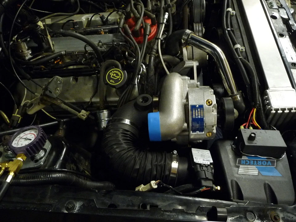

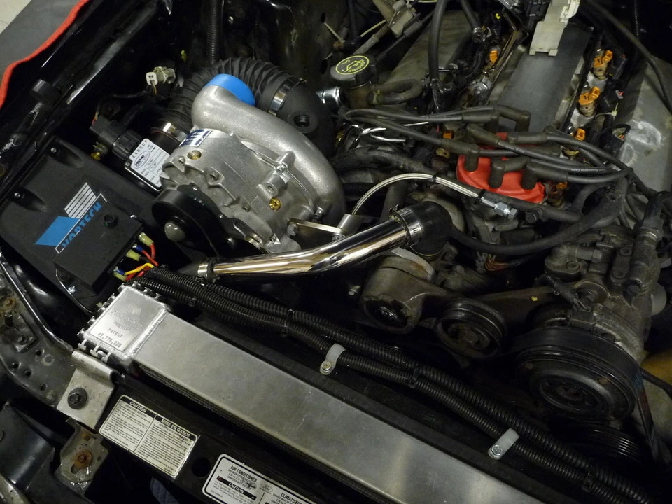

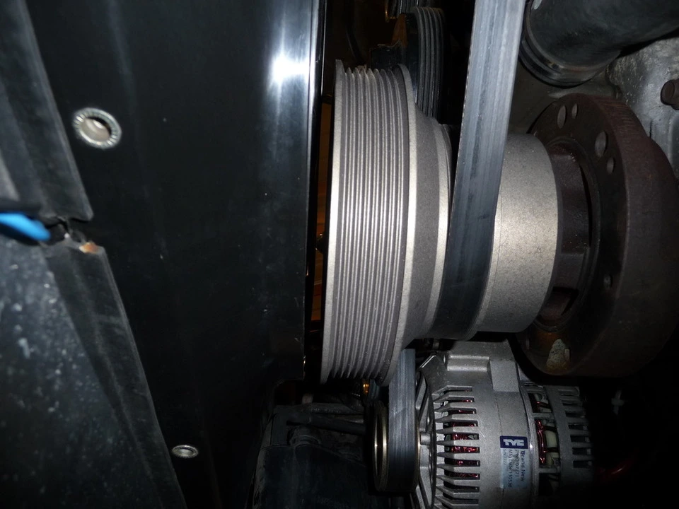

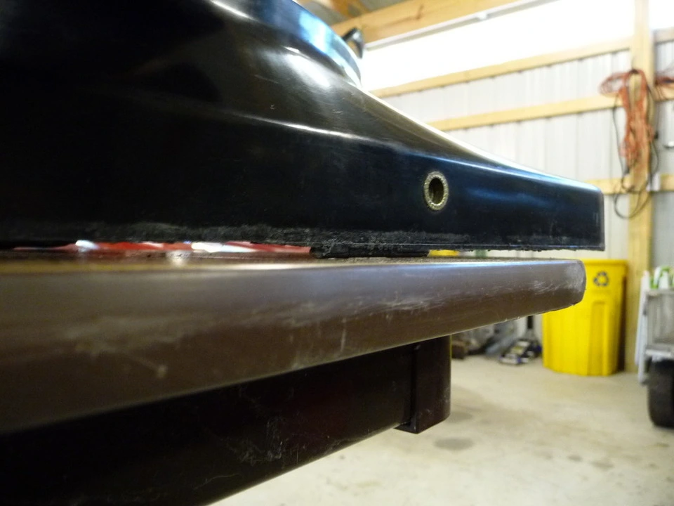

I got the pulley in was able to get about 3/8" clearance all told. The final effort in gaining more room was trimming the edge of the fan shroud so the rubber boot fits down on it further. I need to get a longer blower drive belt since the new pulley is larger. Going from a 6" drive to a 6.87" drive equated to a 2" longer belt.
Here's the remaining bit still on the shroud so you can see what I mean.
Here's the final clearance.

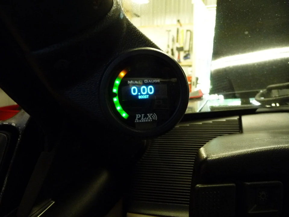

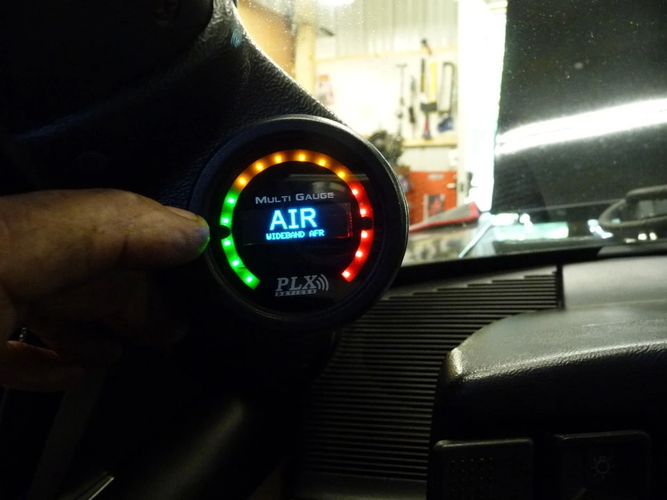

PLX single gauge pod. Boost, then tap screen and get wideband 02.

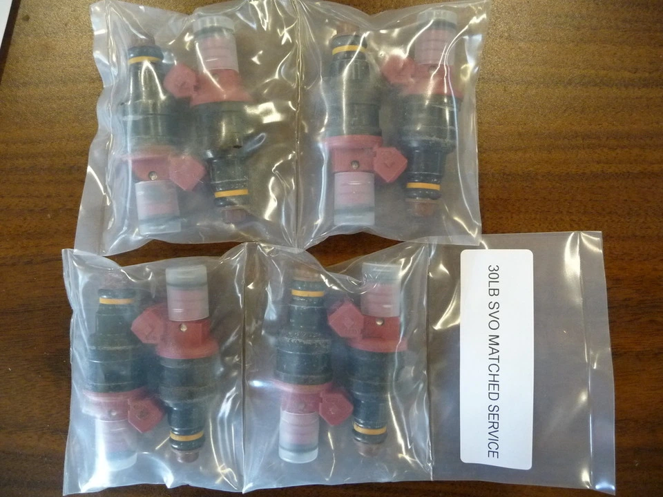

Injectors are are the only thing left to do. I haven't gotten them back from the rebuild service yet. I think I'm gonna give them a call tomorrow to see if they can give me an ETA.

I've been happy with the wideband 02 so far. We shall see how the boost module goes. Once you do the initial install, adding other modules is a snap as long as you keep the first module easy to get to.

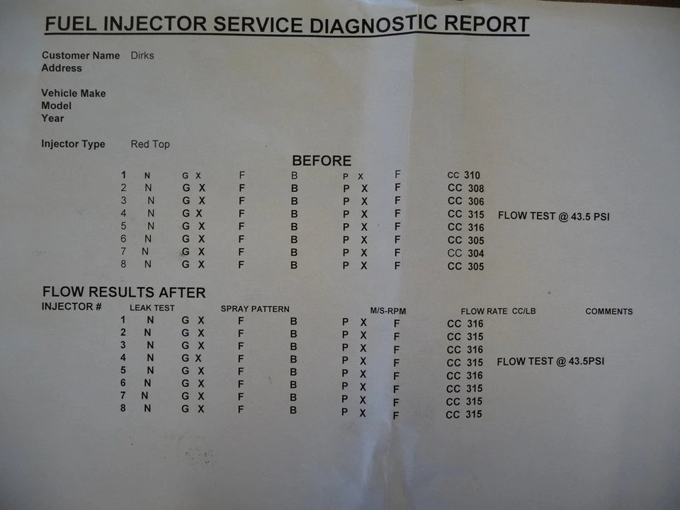

Have refurbished injectors in hand. I should have this thing together today for the initial startup. I posted a picture of the flow test results. Looks to me like the injector service was money well spent.
Reactions: A5literMan, a91what, stykthyn and 1 other person
