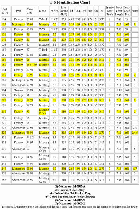

As mention in the title, I heard through the grapevine that the 4Cyl. T5's and the V8 T5's are both the same except the input shafts? Is this correct. If not, where's the best place to find a used T5?
I'm thinking of doing a C4 to a T5 swap in my 66 and I thought you boys here on the 5.0 forum would know the most about the T5's. So I need all your expertise! :D
No, see the chart, but it'll work.

Ok, so the gear ratios are different (which could be a cool thing), is there a strength difference between the V8 and the 4 banger?
Sorry if it seems like I'm beating a dead horse but it's hard to find a god deal on a V8 T5 and you can find the 4bangers for like $150 up. Don't get me wrong, I don't want to throw a 4 banger in my car because it's cheap and then tear it up. I would only like to do this once, but for as cheap as I can because my money tree is wilting. :nonono:
The 4 cyl is rated at 240 ftlbs and the V8 at 265-330 depending on the model. Several will say to stay away, others have run one with great sucess and no issues. If you have access to a very good 4cyl T5 and your not gonna pound on it daily or run it with slicks at the track, I say go for it. If it last a year, thats a year you have to save up for a good V8 version or somthing better.
