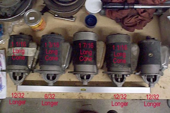

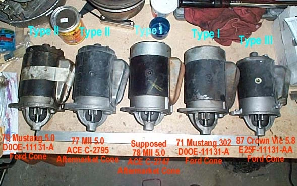

I forget where I got these pictures from, but I am glad I kept them.
Thanks to who ever made these pictures.
Damn, pics saved. Thanks.
It makes you wonder what car engineers are thinking(or what type of drugs they're on) when they change stuff for no apparent reason.
I thought I had installed a M II starter in my Bronco, but judging from that pic, it looks like it's from a 87 Crown Vic instead. Kind of rounded on the end and small. Works great in the Bronc, too, no grinding, and tons of clearance.
The one thing I don't like about the pics is where it says "aftermarket cone" Hmm I wonder how accurate to factory specs those are.

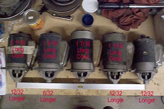

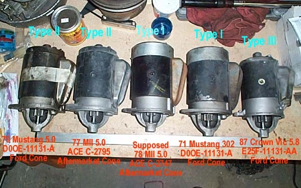

That would be "I." You found them. :nice: Been looking for the originals in my computer since I seen this thread. I have no idea what happened to them. Glad somebody saved them. Quite awhile back I started snapping pics and cataloging II parts and other odds and ends. These pics should have been there with them but this being my 3rd computer now, it's possible that they could have been lost in the harddrive swaps.
I was having the exact same problem others were describing. The starter that gave me the most trouble was that center starter, which sported an aftermarket cone. It was a brand new starter from Napa, said to be for the '78 MII V8 Auto. After doing a few depth measurements and comapring starterand wear patterns, I found that the center starter was just 'barely' grabbing the flexplate. Maybe 1/8" contact wear on the flexplate. I'm using a D2AE starter which, basiacally, is the same as the DO0E starter.
That '77 starter never made noise either, even though it was an aftermarket cone. It came out of a running, drivng car.
