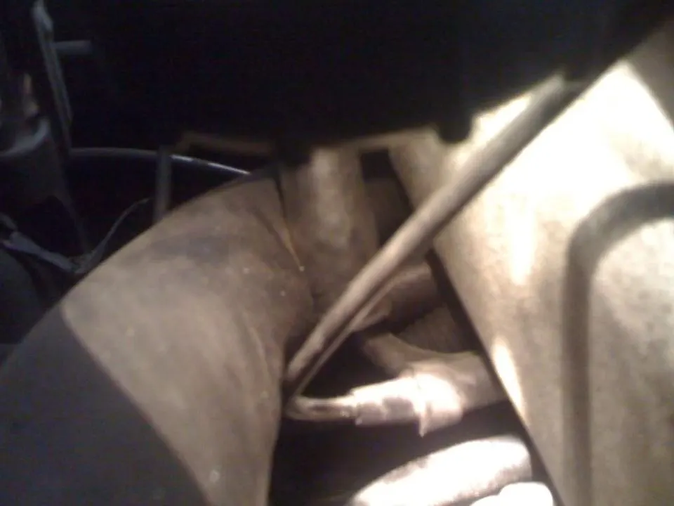

I may have found my vacuum leak then.....but I also have a vacuum line going from the manifold towards the passengers side that is capped off with a screw. I don't know where this line goes or what it was for. I'll take and post pics of the lines I'm talking about.
A picture will definitely help.
But if it's a black vacuum line it went to rubber block where other emission vacuum lines ( air diverter valve, air bypass valve and EGR) were also attached.
That is the vacuum line I was talking about.
The end your showing with the screw in it goes here.
I'll assume that you all your emission related equipment is either removed or capped off, and what someone did to that line was to stick a screw in the end to act as a plug to stop any vacuum leak?
