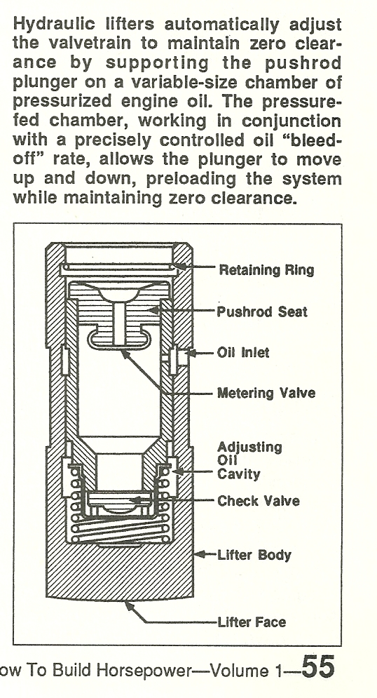

I noticed that when adjusting valves, some of the adjuster nuts would offer resistance when doing the half turn past 0 lash. Others offered no resistance.
Before doing the procedure, I made sure to loosen all the rocker arms and let them sit overnight to let the lifters return to their most expanded state.
What could cause this to happen?

Yeah I do have stud mount. And I mainly was concerned that some of my lifters weren't working right. If you loosen all rockers, shouldn't all of the lifters bleed down?

What makes you concerned that your lifters aren't working correctly? Does the engine lack power? Run unevenly? Do you have rocker noise?
Lifters bleed down over time, or if the check ball/disc is loose or faulty, or the lifter is made poorly or worn out.

Hi tx,
This is a new build, and I haven't really been able to get it running smoothly. So I wanted to reset the valve lash to eliminate that possibility.
I set #1 TDC and loosened all rockers and let it sit overnight. When I adjusted them, some were pumped up, a few weren't.
I was wondering why some bled down and others didn't. None of them had load on them.

The return spring is only partially responsible for extending the lifter, engine oil pressure also acts to extend the lifter during operation.
Normal stiction within a good lifter can catch it & keep it from extending just under the force of the return spring (loosened rockers w/ engine off). Also, if a few lifters have more oil within them than others (e.g., the non-compressed lifters at the time the engine was turned off), the force required to squeeze out the extra oil can make certain ones feel stiffer. You notice the oil resistance effect if you run the engine (fill the lifters), then re-adjust them a few times w/o running the engine again & they feel looser the second time through.
