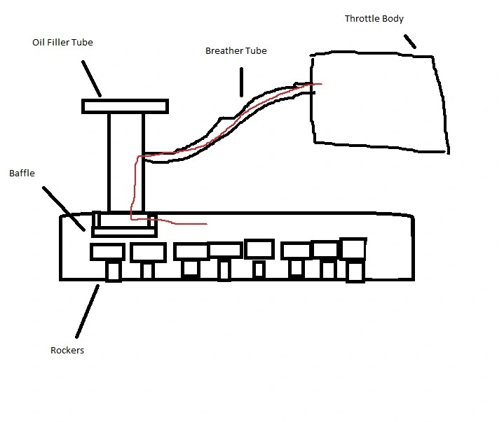

Here is a elementary school diagram of the valve cover in a cutaway view, the red line represents how the air travels through the valve covers into the t/b. You can see how the baffle will block oil from going up through the tube.

I actualy ground away a little bit of the mounting surface for my baffles on the inside of the cover, then made a new one out of a piece of tin. Worked fine for keeping oil out of the intake. The only drawback, was that I had to pour the oil into my engine extra slow when I did a change, as it wouldn't drain past the baffle, into the engine quickly enough.
