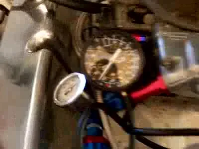

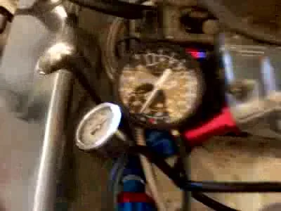

My initial timing is set at 12 degrees with vacuum advance disconnected and plugged. I put a vacuum gauge on it and I'm pulling about 19" of vacuum at idle with little needle fluctuation. And when revved the needle moves steady not jerky (see attached video). Total timing seems to peak at 29 degrees at 3K rpm.

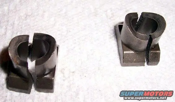

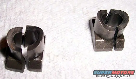

I just went through and checked/adjusted the lifter preload. Some of them did need to be shimmed and I have them all torqueing at about 1/2 turn past zero lash. It does rattle less today than it did before, I found 2 of the rocker saddles were cracked.

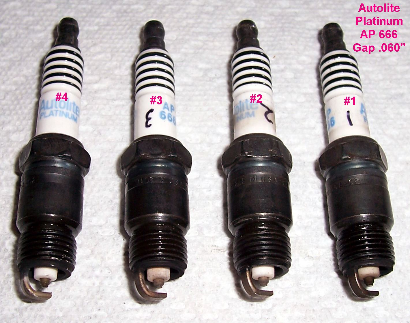

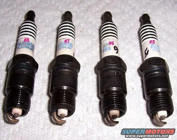

I tried backing the timing to 10 and it still pinged/knocked and was harder to start. As for the lean mix I adjusted the air/fuel with a vac gauge and think I've got that OK, larger jets maybe in the primary not sure whats in there now. Dynamic compression what is it and if it's the cause of my detonation what can I do about it?

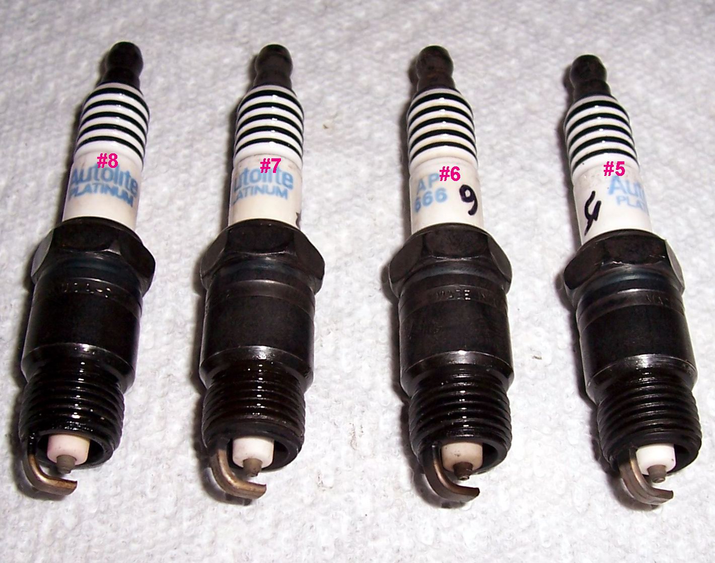

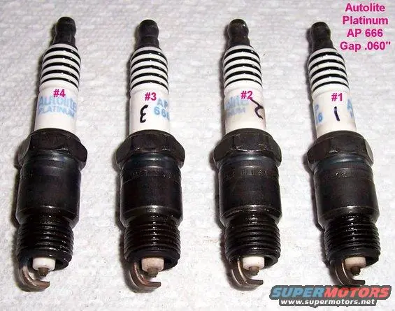

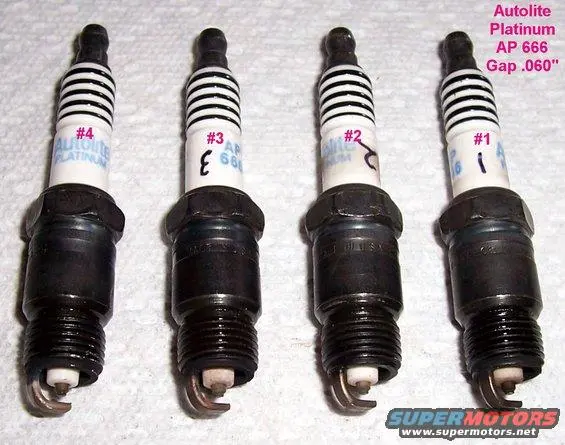

4 of em are leaner than the others, but you really have not run it long enough to be accurate. Fill the tank with premium and see what happens. If you can't back off the timing anymore, then that's your only choice other than richening it more, and that's not going to guarantee it'll solve it.

Reading plugs on unleaded gas with an MSD is hard (so much energy it burns the garbage off), but you can do it. You need to do a plug check under power, and kill the engine cold. When I lived in Corcoran I could drive a half mile and be in the country, so I'd drive out and let the engine warm up, go through the gears, kill it and coast, and pull a plug. I'd usually just do one hole to see if I was close.

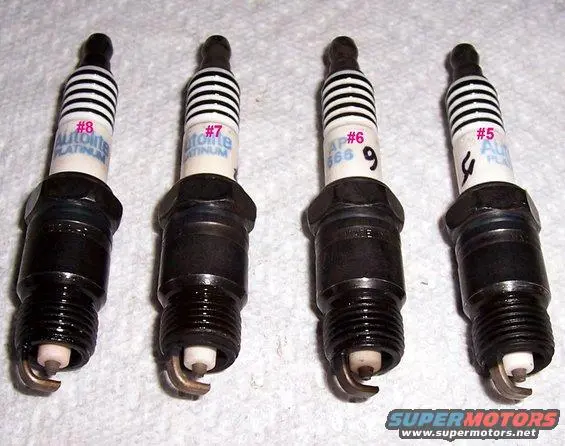

Could it be I'm running the wrong plugs? The AP666s that I'm running are what's called for the in 78 heads I used to have on the engine. Since I'm now running E7s from a 90GT that car calls for AP25s, I haven't gone to the store to look at the difference but could that be my problem?

Here's a pic of the broken saddles for CraigMBA.

:rlaugh: Good one !!:rlaugh: :hail2: I don't know the plug diffference either but both heads should use the same style plug, one may be hotter than the other with the different number. I don't think you've run it long enough though to tell a need for a change in heat range.
52's are one range hotter than 42's, I do know that much. The called for heat range though is more related to the vehicle application than the head that it's used in. A 1978 application would also have an 8 to 1 compression ratio where the 90's all were in the 9's in that regard. You could run a hotter plug with less compression.
