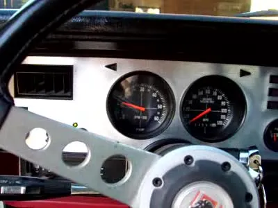

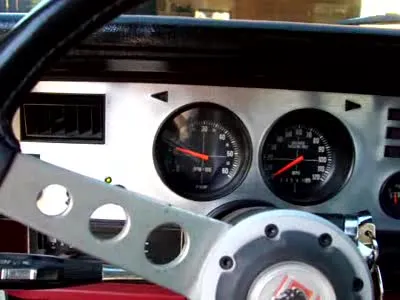

OK, haven't made time to get any 91 yet but what I have done is sat in the car and watched the tach as I press the peddle. So far I have just been revving the but not slowing raising the RPM and holding it to see if there was a rough spot in the RPM range.
It revs smoothly to 1500 then it starts to miss and stumble and by 2000 it's pretty rough. Now granted this is the first time I checked this way and haven't verified that it does it at this RPM every time. Maybe it's time to replace my timing light, I'll get/borrow another and check mine against it. Does it still sound like a timing issue or more of a carb issue. Maybe I can get a friend to help and move the dist while at the higher RPM to see if the stumble goes away. I have attached a video so you can see/hear what I'm talking about.
