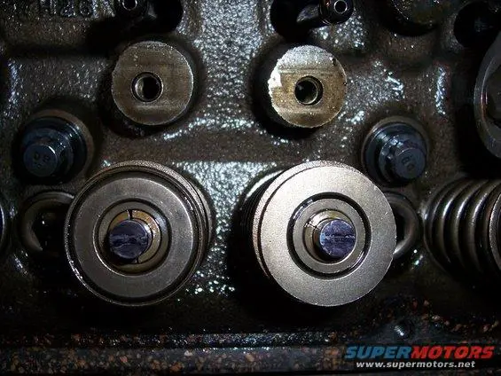

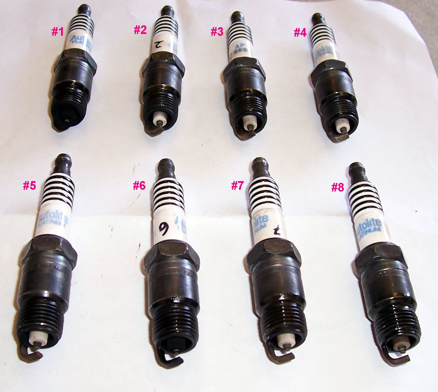

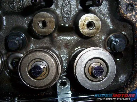

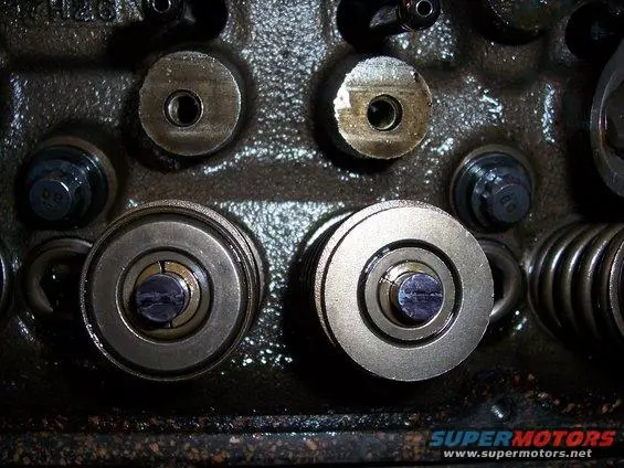

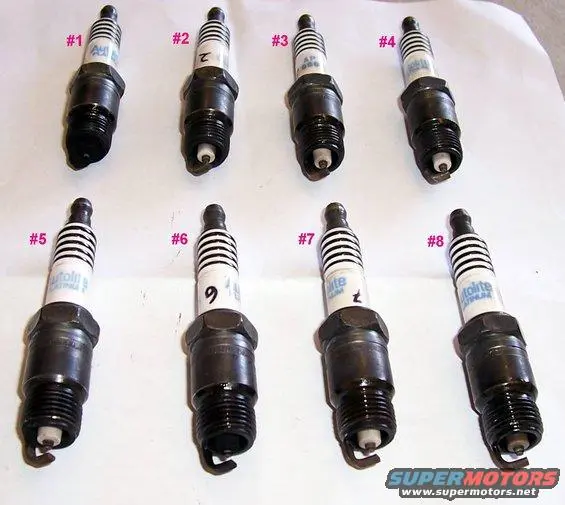

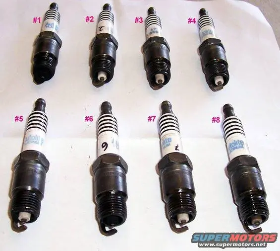

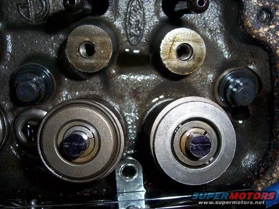

I was reading up some on the MSD website and they say to use Copper not Platinum plugs so I went to Kragen and picked up some Autolite 25s and gapped them at 0.050 and installed them. When I pulled the Platinum plugs the #1 and #6 were black the rest looked OK (see pic below). Then I pulled the VCs and rechecked torque on all the rockers. I pulled the rockers on #1 and #6 to see if I had cracked another pedestal but no damage. I did however change from a thick shim to a thin shim on the #1 intake. Then I used a marker on the valve tips and reinstalled the #1 and #6 rockers and rotated the engine through a few revolutions to mark the top of the valve tips (see pics).

Link to fullsize pic of plugs http://www.supermotors.net/getfile/566259/original/100_1933.jpg
#1 Valves
#6 Valves
