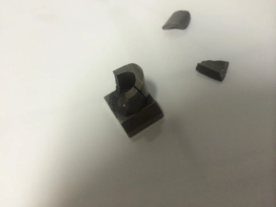

So I believe I've found my problem. Broken rocker pedestal. Now why would these break and where can I buy just a new set of pedestals?
