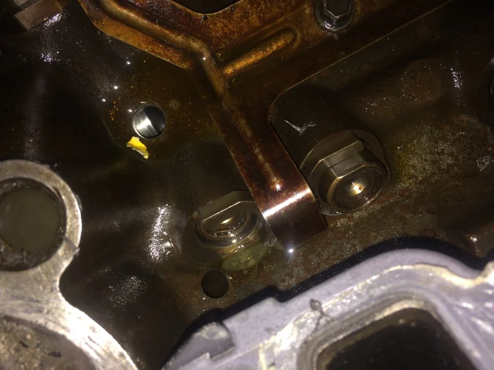

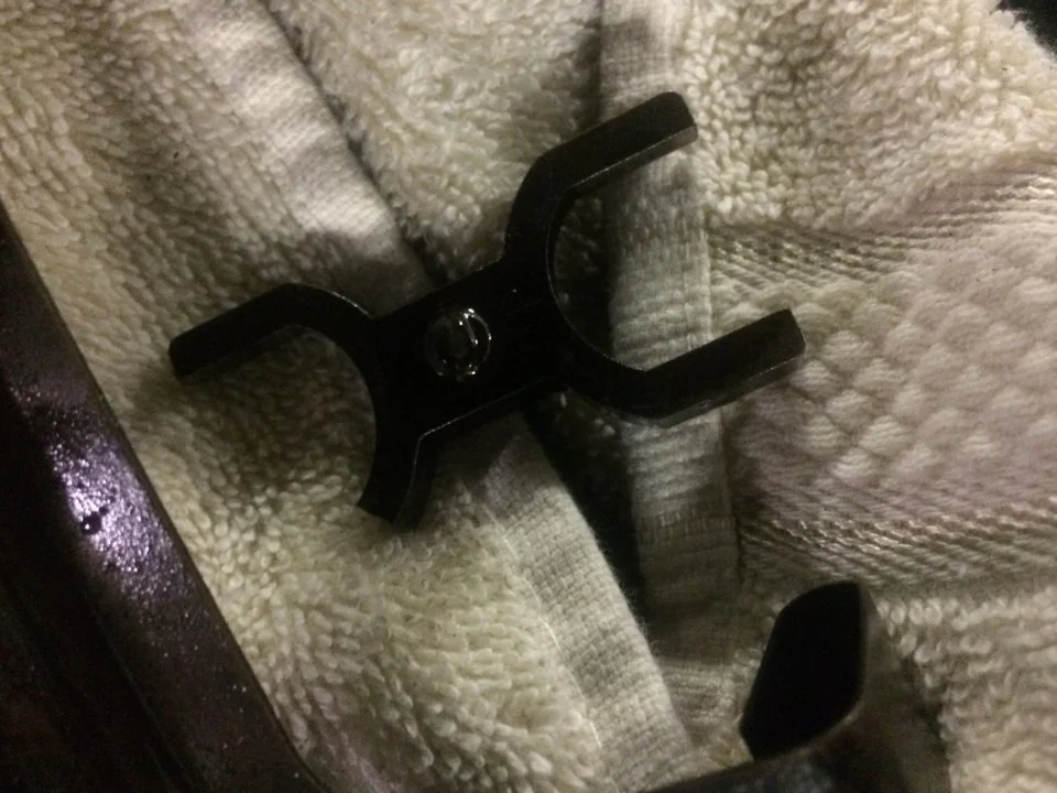

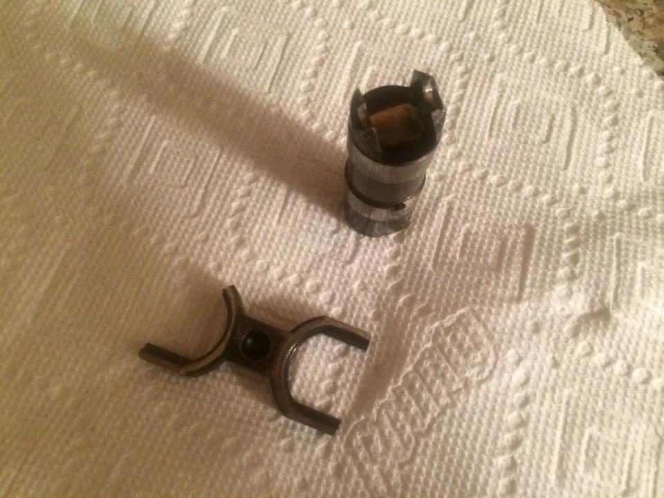

This is the suspect lifter. What is going on here?

There's a good chance you could find it in the oil pan, but there's probably other damage already taken place in the motor... Damn that sucks!
Now what I would do (take it with a grain of salt), is get a good lifter, piece it back together and put on the rockers, and hand crank the motor to get an idea of where you might be at. Might give you an idea of whether you can clean things up externally before committing to a tear-down.
