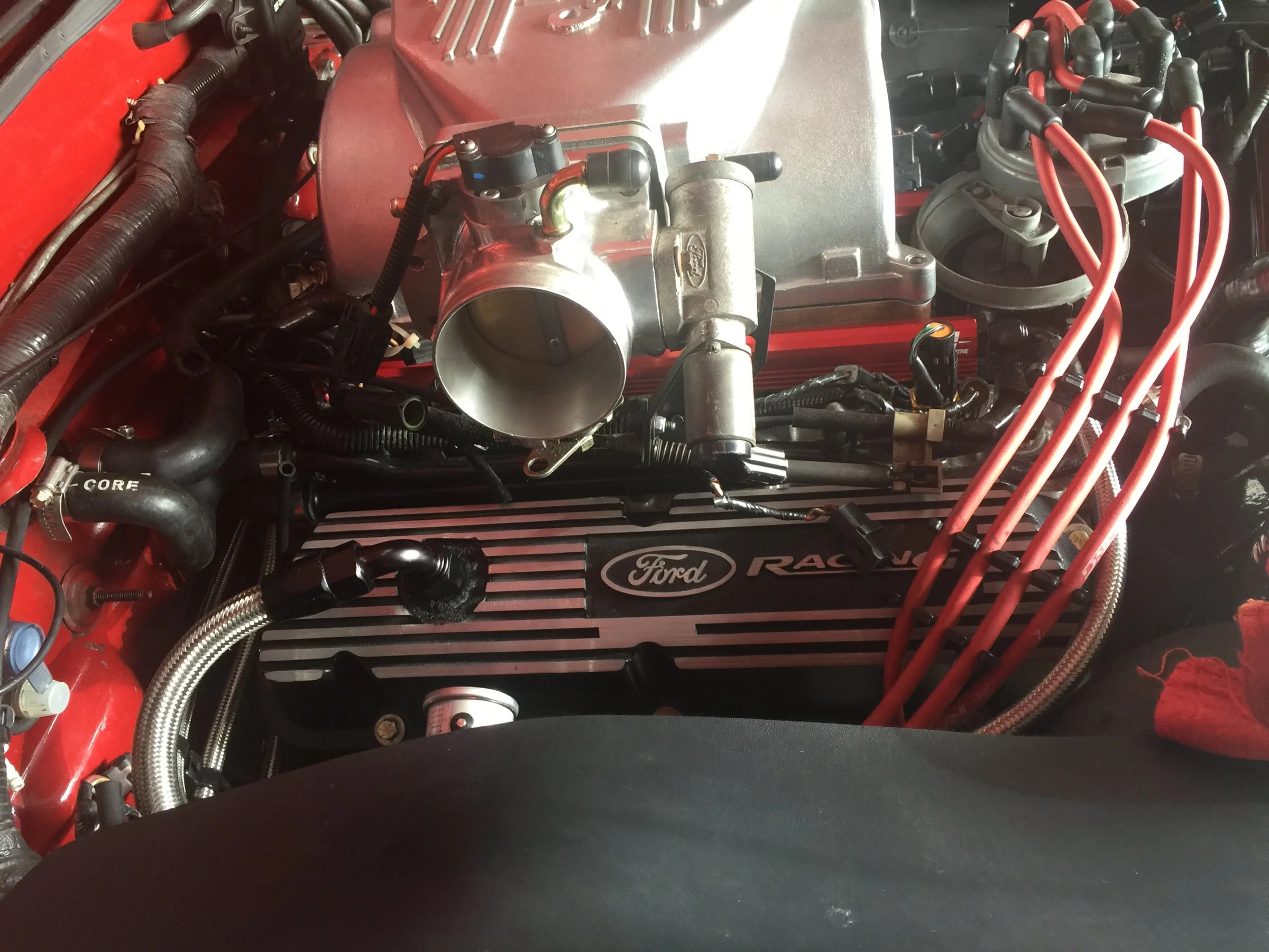

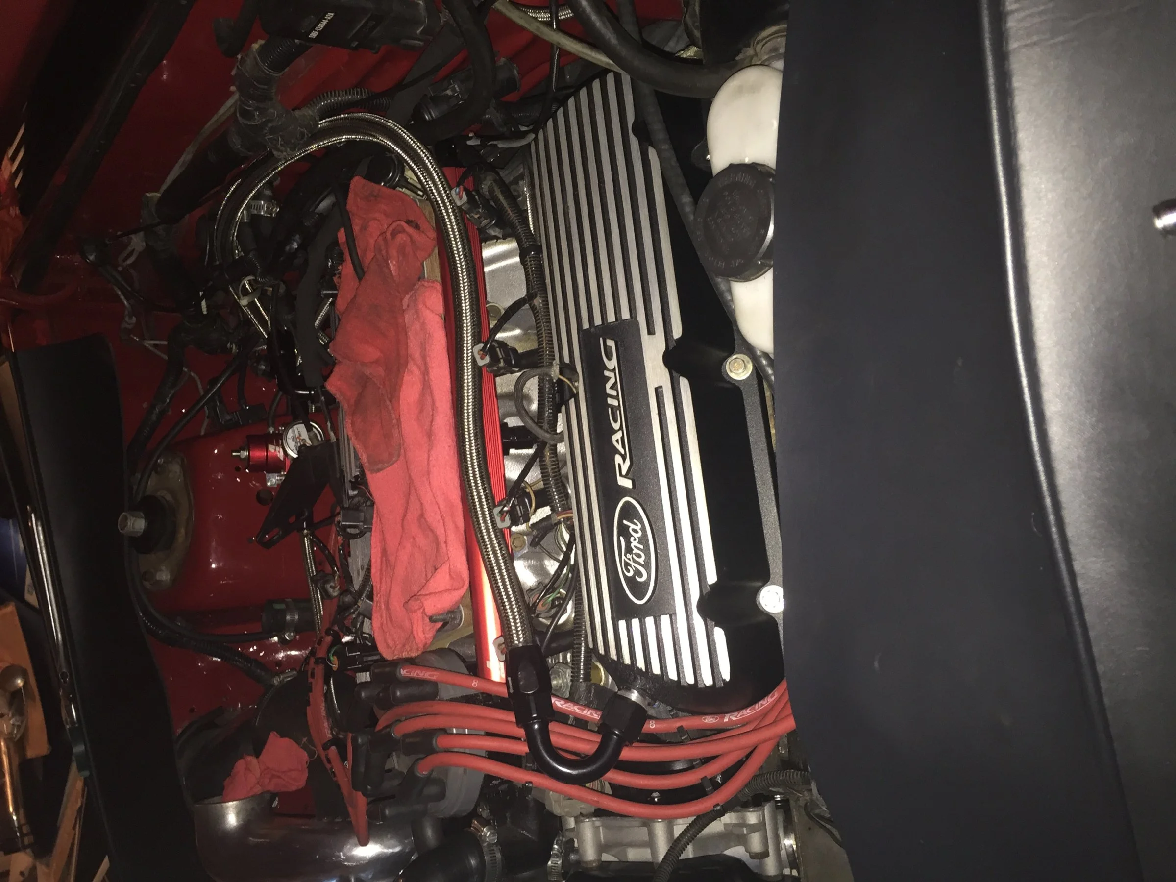

When you do it's one or the other, either open with no pcv or a closed system like factory . I have a An fitting welded into the front of my vc and the line goes to a catch can behind my headlight .
I will post some pics later . The wifi on this flight isn't strong enough to attach in here
Thanks.... hopefully pics will help. I have no baffles in these valve covers. I don't want to push oil out. The joe's racing filler tube and filter is baffled on the passenger side. Just trying to figure out pcv or breather on driver side.

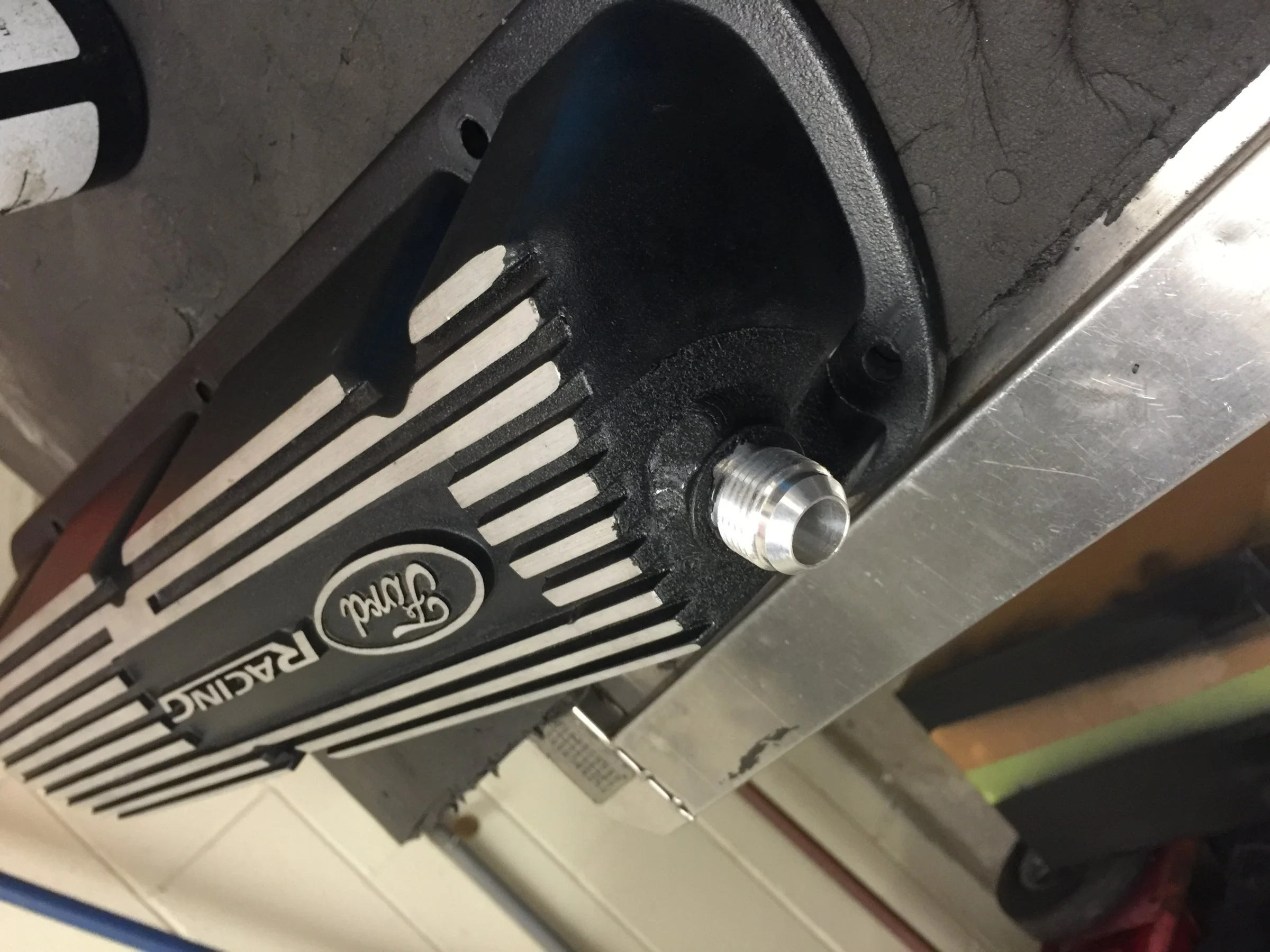

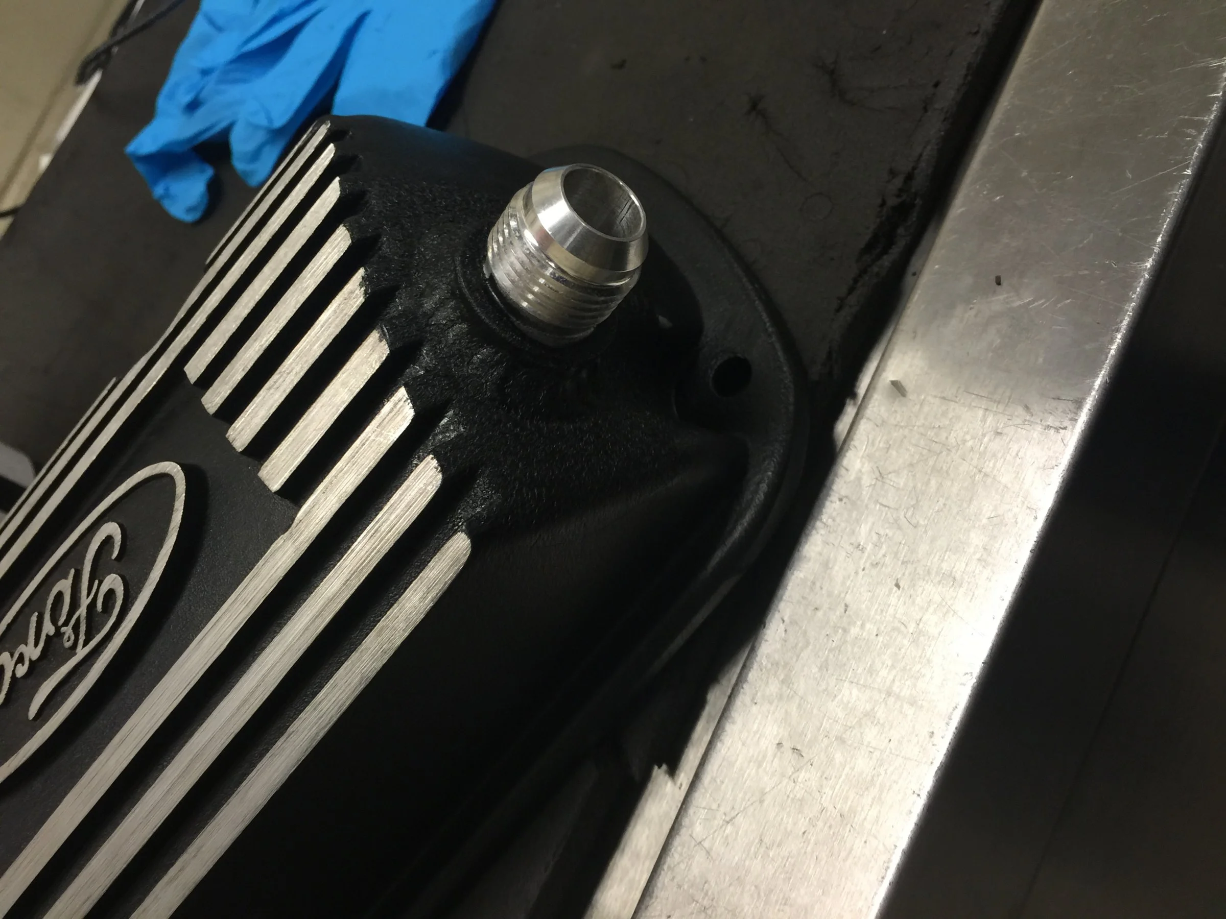

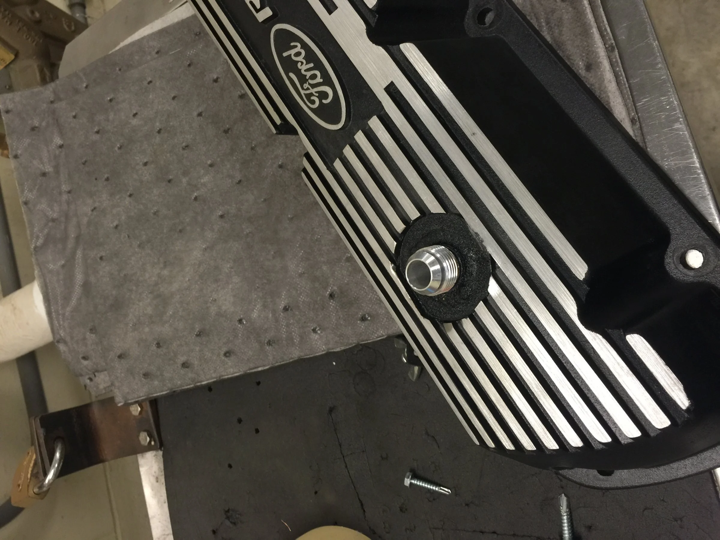

One side I have no baffle as there is no room for it. The other I used the carb baffle that was already in the cover . I had 2 sets one efi set and one carb set to do this
On driver side it will not fit an ac compressor there if you have one . You can always move the fitting to the same spot just in the back which is what I should've done originally
Any problems under boost pushing out oil with welded in bungs and no baffling?? Clean setup for sure.
The driver side is the only one with no baffle due to the angle of the fitting and the rocker being there.
No issue at all . It will only puke up a minimal amount of oil and that's usually after a long highway pull or a full 1/4 mile pass . Usually just moisture pulled from the crank case more then anything else
