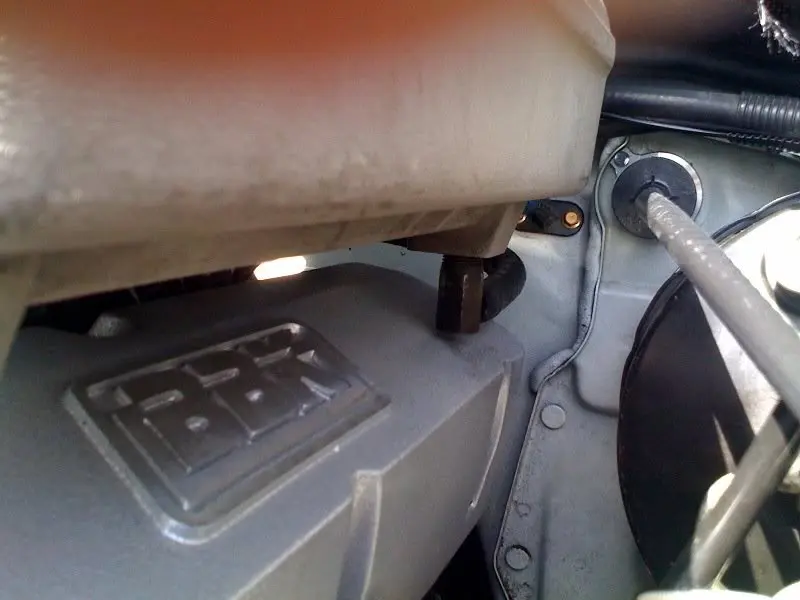

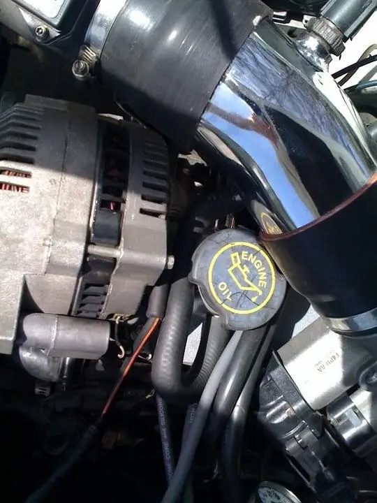

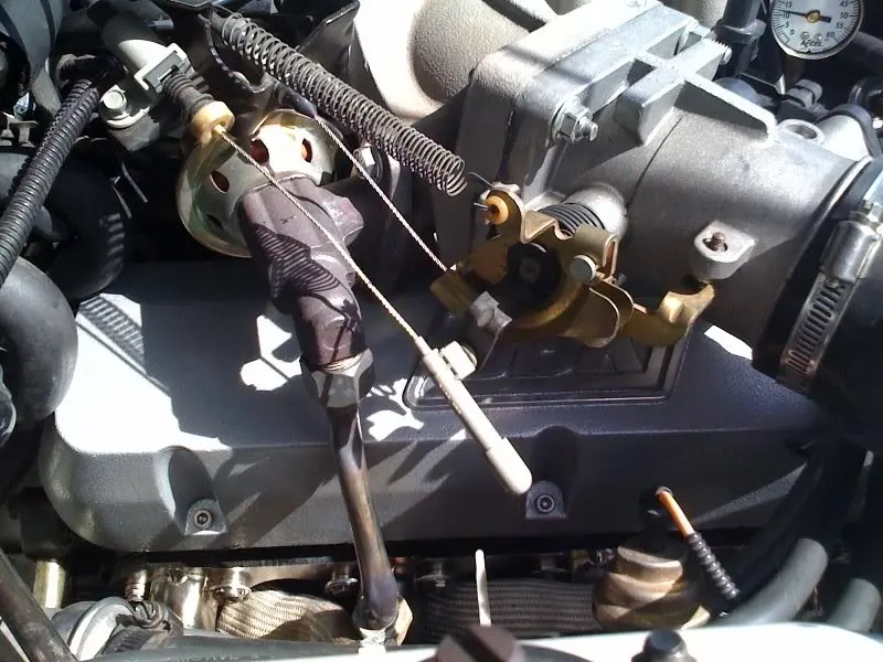

I just recently had the BBK valve covers put on my car and that was a headache. They look sick, but grinding had to be done for the alt, modified egr for me and i needed a intake spacer. I have a cobra manifold, gt 40 heads and it sucked for (the shop) to get it all on but it LOOKS GREAT!
About 1/8 of an inch from being a problem
Changing engine oil is fun....
The only grinding was done behind the ALT at the bottom screw. Coulod'nt get a clear pic on that tho. These VC's are the Thickest ones out there. So if you need to grind with these you have room to do so.
