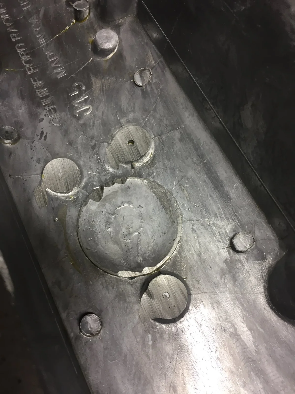

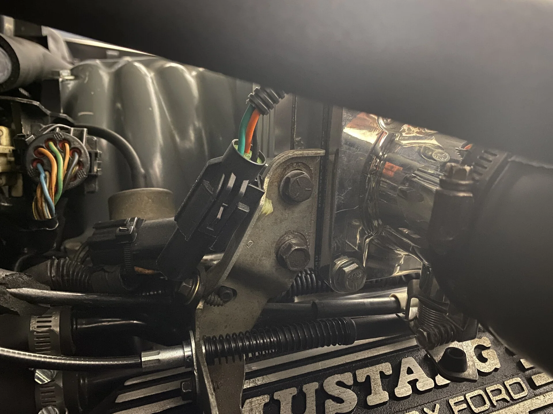

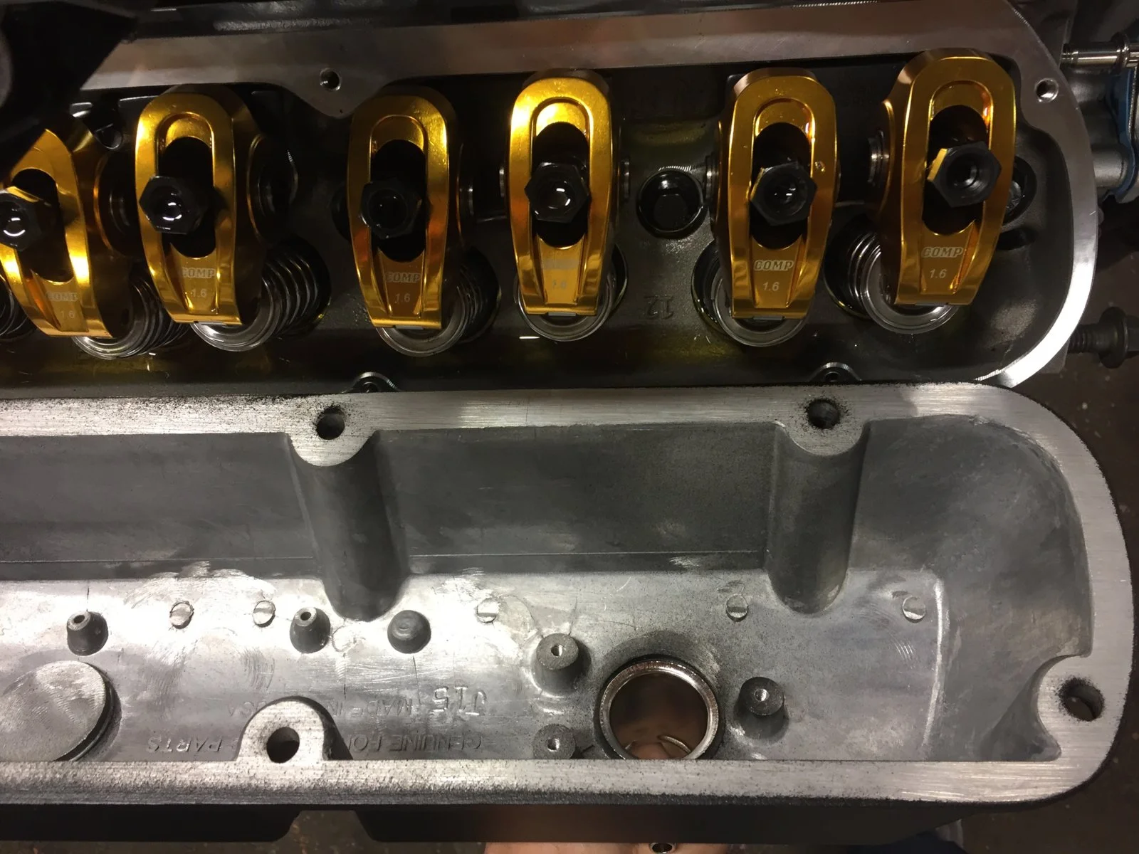

Mustang5L5 said:
Here’s what hit. The boss along the center line was contacting. Like said, only 2 actually hit but I took my grinder and took down more than needed just to be sure. After grinding, need to really clean the shavings out.
With a 3/8” intake spacer, here’s my clearance.
If i slotted the throttle bracket, and eliminated the PCV connection under the plenum, probably could have gotten away with no spacer.
Did you get to leave the baffle plate in ? I’ve read about people having issues spitting oil into tb.
No. I had to leave the baffle plate out. I have not noticed oil into the TB yet, but if it becomes an issue i'll just install a small catch can.

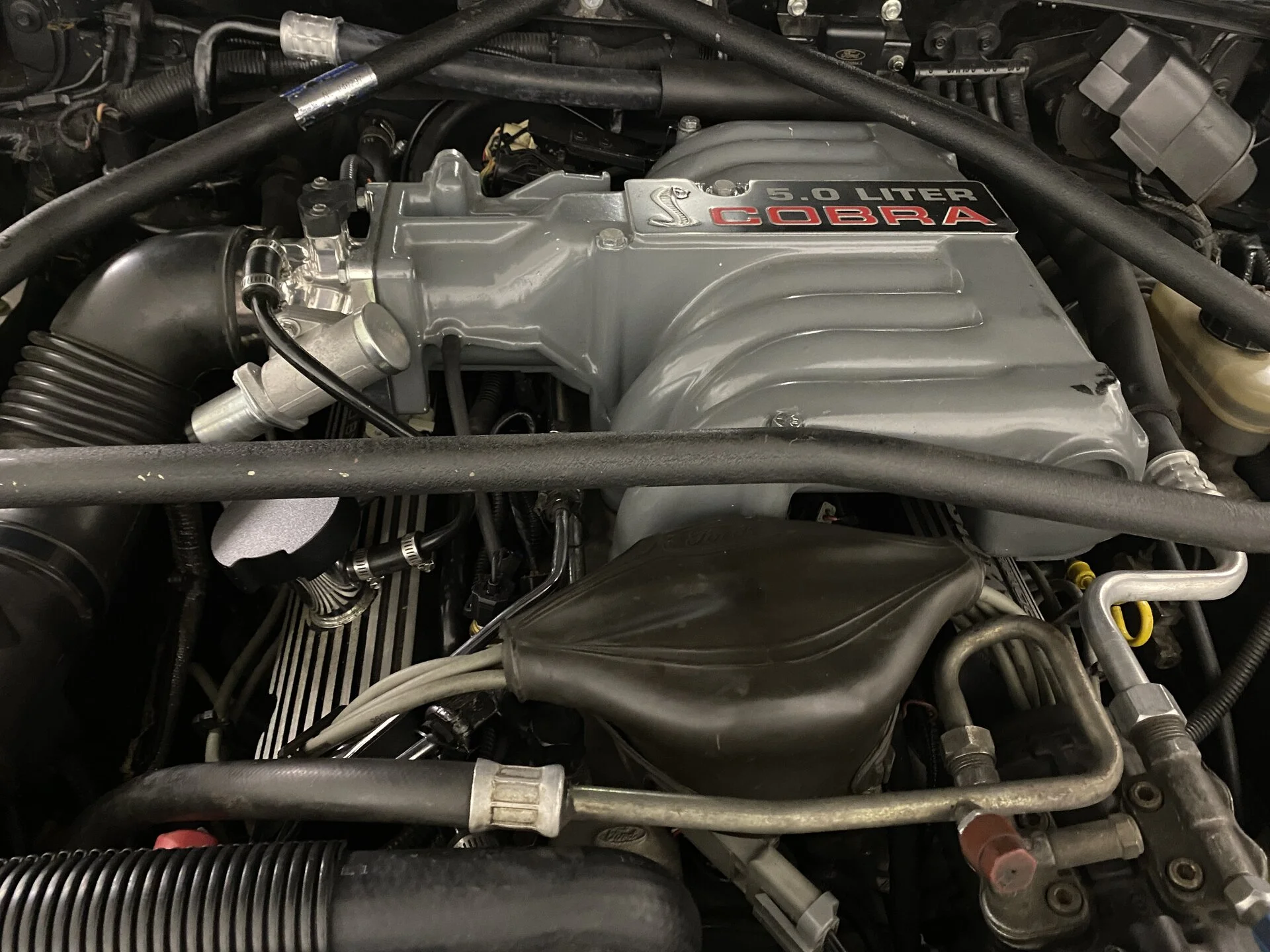

I have the same valve covers on AFR heads and didn’t have to clearance them at all. I’m running the low profile Scorpion stud mount roller rockers. I’m also running a Cobra intake with no spacer. I had to slot the bolt holes in the throttle bracket a little so I could raise it up to clear, but that’s it.
Dan02gt
mazing how much gas smell came from that tiny hole
20+ Year Stangneter
Mar 2, 2003
909
415
113
Greenville, NC
Feb 15, 2022
#26
  • Feb 15, 2022
  • #26
Here’s a few pictures
