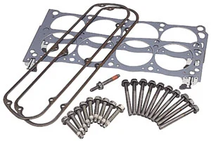

If you want the best gaskets use the Ford Metal Gaskets. They are metal and come with just a raised lip of rubber on each side. They came factory after 91. They look like this.
You can reuse these over and over again and have no leaks! :D
I used to have a solid roller cam and adjusted the rockers periodically. I used these with ARP rocker studs for over 2 years and they never leaked.
those are what we used. we may have put a touch of locktite on the bolts too.
