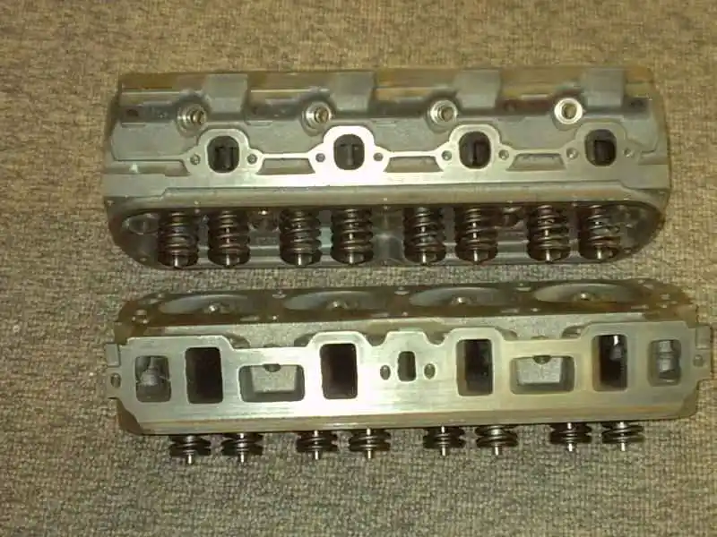

Mike- I'm about out of bolt on power parts for my car. I'm not going to change my H/C/I setup for a few years now. Once I get out of college, I am going to build a 331 combo with all new stuff. A friend who ported his heads out to gasket sizes said he felt an increase. My exhaust ports are so small that I don't see how they couldn't benefit from an increase. He's not going to just open the ends of the runners up, he's going to work the whole head to get better flow. It's more of a home done porting that uses the gaskets as a guide. I don't see how opening up airflow in the intakes and heads can be bad...
This is what they look like now:

"said he felt an increase" -- you don't really want to spend hard earned money on a testimony as weak as this do you?
If you're talking about actually doing port work on the heads - that's another thing. But even then, have your 'porter' flow test before and after so you've got documentation that things actually improved. Just getting in there and removing material may not be much helpful if the person doesn't know what they're doing. Alternatively, I've seen amazing gains in flow just from a little bowl work, and a nice 3-angle cut on the valves. But just port matching - I'll promise you, it's only worth it if things are WAY off. And unless there's been major cutting of heads or block, they're not misaligned enough for port matching to make much difference.
