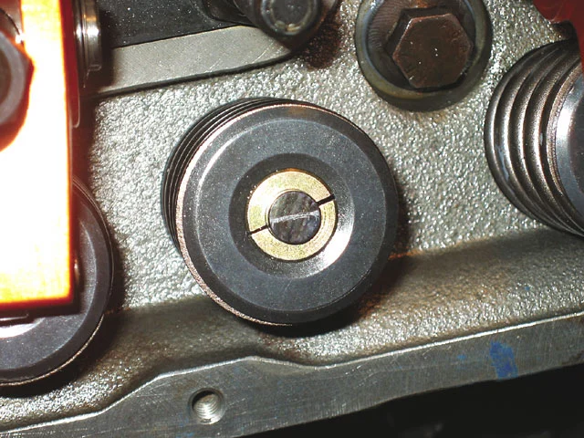

How to check Valvetrain Geometry Procedure:
1. Have all of the components installed that you will be using on your "new" setup (eg. heads, head gaskets, cam, lifters, etc etc).
2. Take a marker, such as a sharpie, and "color in" the valve stem tip on one of your valves.
3. Go ahead and install a pushrod (it's ok to start with stock length here, since this is just a measurement and not necessarily the final setup) and rocker arm on that valve. MAKE SURE to follow the rocker arm adjusting and/or installation procedure for that type of rocker arm before you continue.
4. Turn the motor over by hand through a couple revolutions (to allow the rocker arm to push down on the valve stem tip at least a few times).
5. Now REMOVE the rocker arm. The tip of the rocker arm will have worn away some of the marker you had filled in on the valve stem tip, and created a "witness mark". The thickness and location of this witness mark will TELL YOU if your pushrods are creating a proper valvetrain geometry, or if the one you used is wrong and you need a different length.
6. Ideally, you want the witness mark to be a thin line, mostly centered on the valve stem tip. If the witness mark is too far out on the "exhaust side" of the valve stem tip or too far out on the "intake side" of the valve stem tip, then you know you need different length pushrods. Now would be a good time to purchase a pushrod length checker tool!!! :nice:
Example of witness mark thin and centered:
