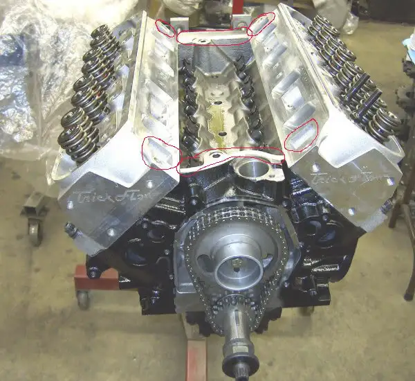

okay so i want to glob silicone where?
best pick i could find of a longblock if some one could put like yellow circles on ms paint or something really fast to show me where to put the stuff exactly?:
http://www.hekimianracing.com/331FordLongBlock.jpg
ps. its leaking in the rear left,pass side, coolant not oil, no other leaks i was having a leak up front on the same side, but now its only the rear.....:shrug: maybe i did something good up front :shrug: or that just proves a bad surface on either my heads or manifolds:(
ok so let it dry overnight i dont even think i let it dry for an 20mins:shrug: im impatient with this thing now and my carelessness is costing me time and money. i already scratched up my freshly painted valve covers:notnice:...
anyways do i want to put the thing to together and let it sit for 24 hours w/o adding water or just let the stuff dry in certain troubled areas for 24 hours,then put the manifold on? more details please, i want do do this right....
and if anyone gotta a better torque sequence or what ever i did the 1st @ 20lbs 2nd @ 23lbs and 3rd time @ 25lbs*
any opinions...... and help with the pic is greatly appreciated both my heads and manifolds do seem visaully fine and the gt40 irons were clean....with no oil leaks or gasket problems:shrug:
thanks````
Get everything cleaned; put the RTV, new gaskets, and manifold on; let the RTV set for 20 mins; torque it down and leave it alone for a day. (Meaning don't add water or start it.)
When you put the RTV on the front and rear sections of the block, lay it down thick. I'm talking like 1/2" thick, so it oozes out when you set the lower down. Are you making sure to use some studs to guide the lower intake down, so you don't shift the intake gaskets? You'll get leaks for sure that way, too.
the wholes that the manifold bolt goes into....i already put silicon on them,i light glaze :( and now thinking that was not a good idea....
i used a lot of silicone, like a whole tube.....the silicon oozed out and i let it sit for at least 20minutes then torqued it down.... then to my surprise about 30mins later checked the torque/bolts and they went down further, i guess this is the silicone? if it leaks this time there is definate head or manifodl problems....i guess ill try another manifold first or take them both off and to the machine shop???
The spots that LiquidGT pointed out in the picture are a common spot for leaks, there is a decent size gap there most times. Being that I have gone what you are going through once before I know how irritating it is. Remember; its a hobby, its suppoed to be fun. Take your time, apply the RTV in excess to those areas so that it splooges out when you set down the lower manifold. I think you just did not let it sit long enough, it was probably still wet if you only let it set for 20 minuits.
