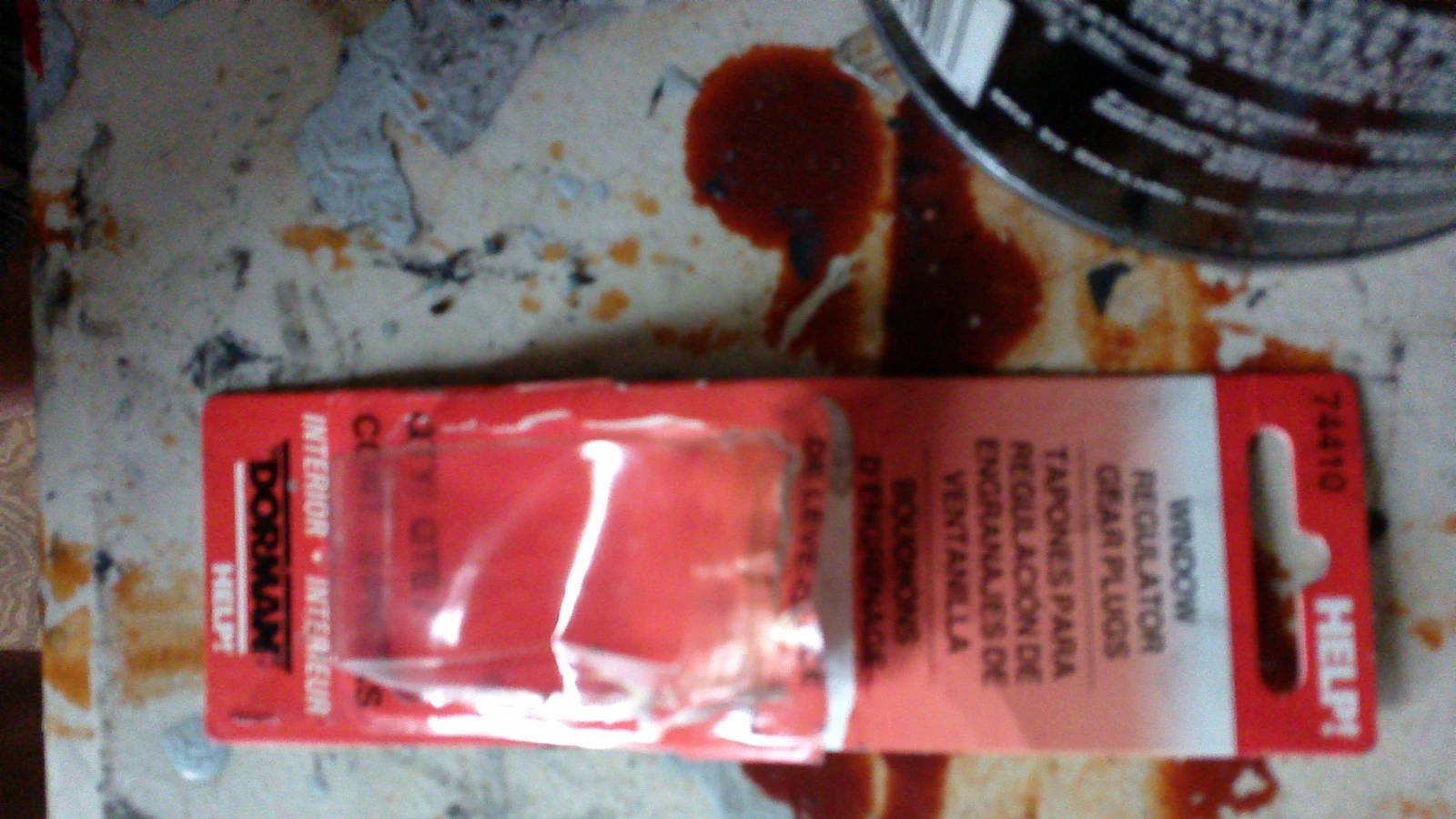

my quarter windows stopped working, the motors ran but not the windows, figured it was the motor gear drive bushings... went to autozone and picked up a pack of the 3 nylon bushings.... had to go across the street to advance for the second "help" pack each store had one 3 pack Lol......

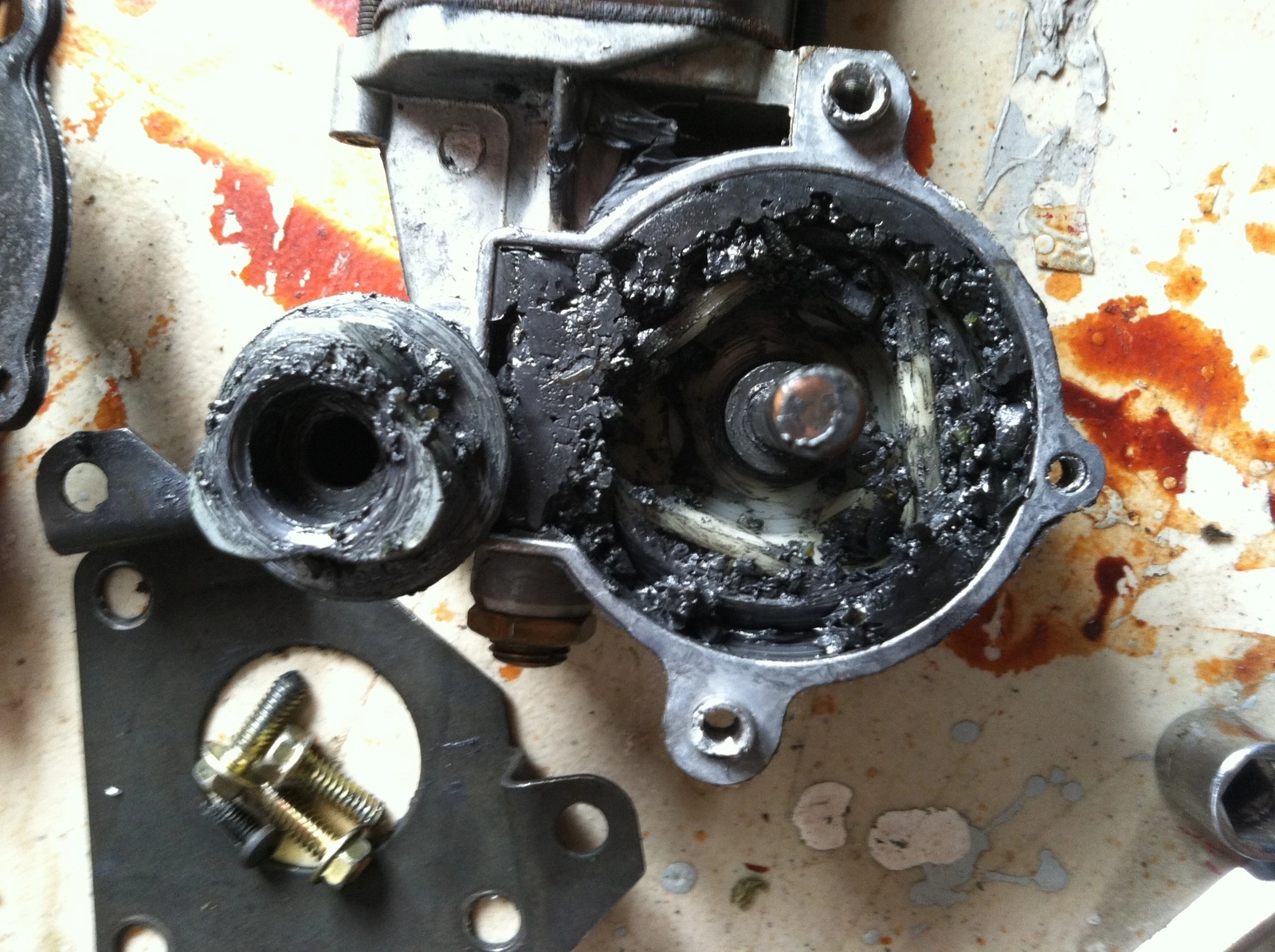

opened the gear casing 1 screw and 3 bolts and found this mess
pulled out the window gear and plastic gear/bushing housing - cleaned it all up, allot of new grease new bushing (they fit really tight - did the half way in and push drive gear into the plastic gear together as an assembly then insert it back into housing...more grease....
