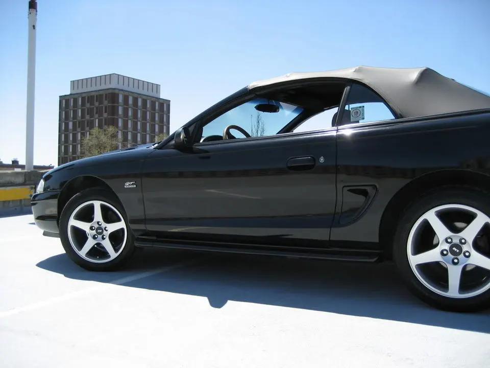

vert rear seat delete?? help me find one...
Mar 31, 2005
427
17
I know ive seen a rear seat delete for 94+ convertables for sale somewhere... now that i actually NEED to get one, i cant find it for the life of me, does anyone have a clue, or could you give me some kind of direction as to what dimensions i should cut it and what all is involved in making one? Thanks, Kyle
