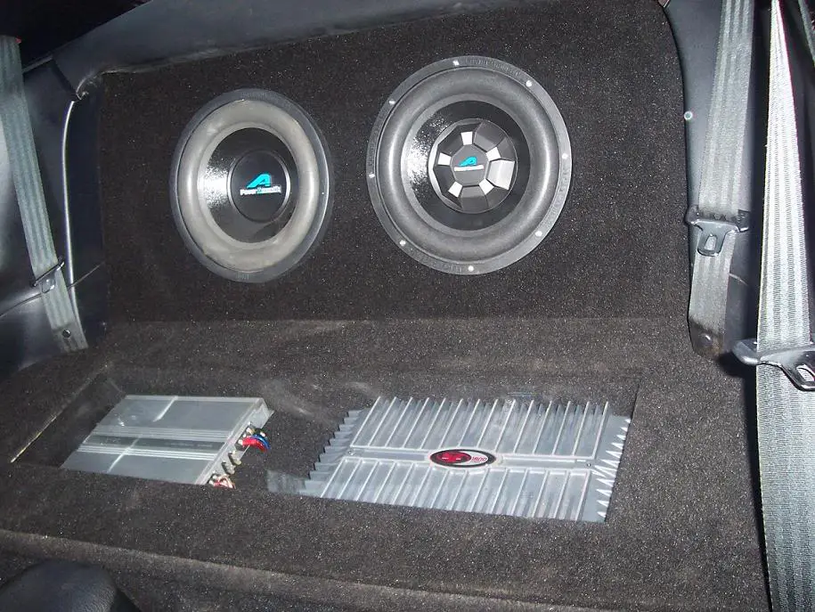

you can see my eclipse amp in this pic :hail2: :hail2: :hail2:
