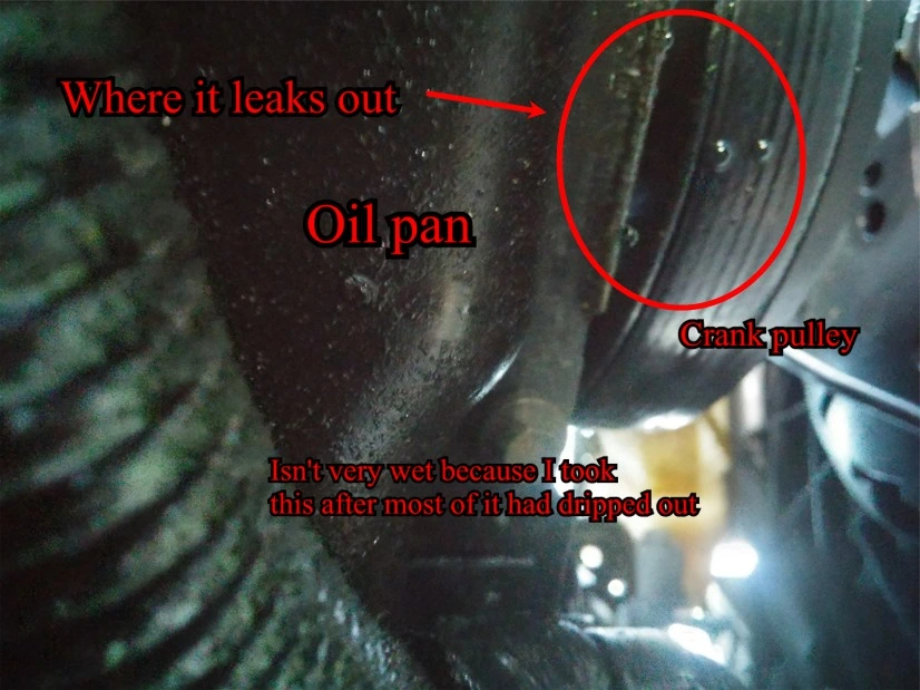

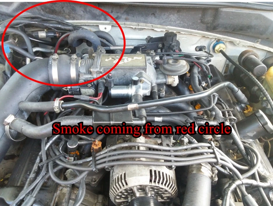

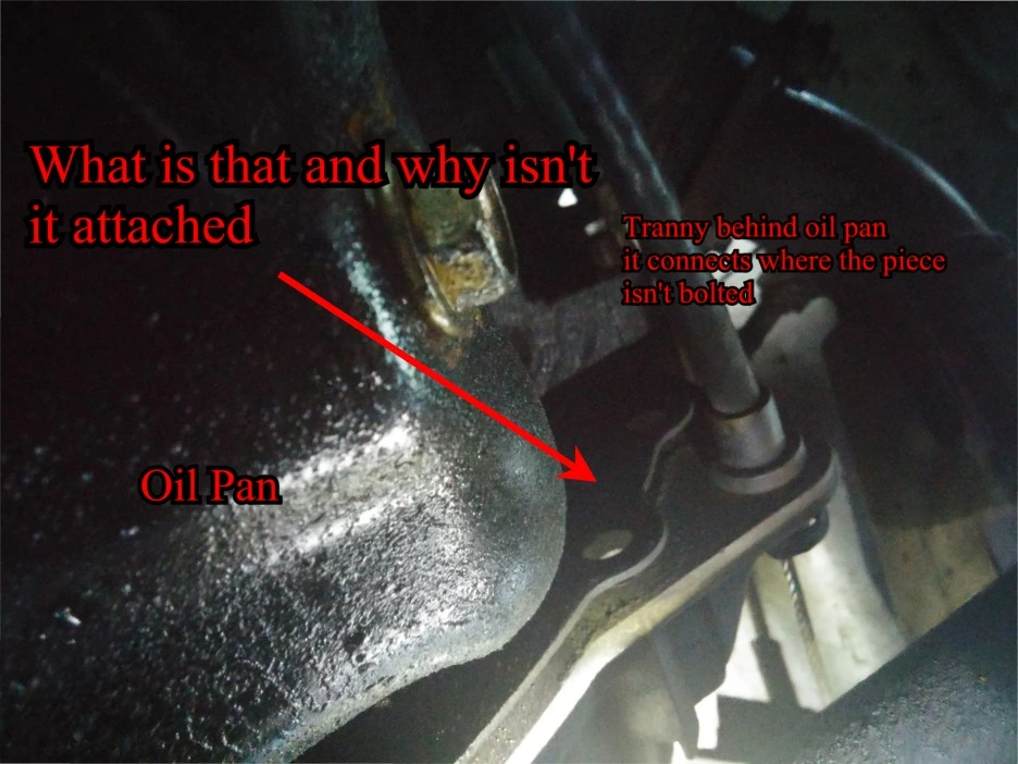

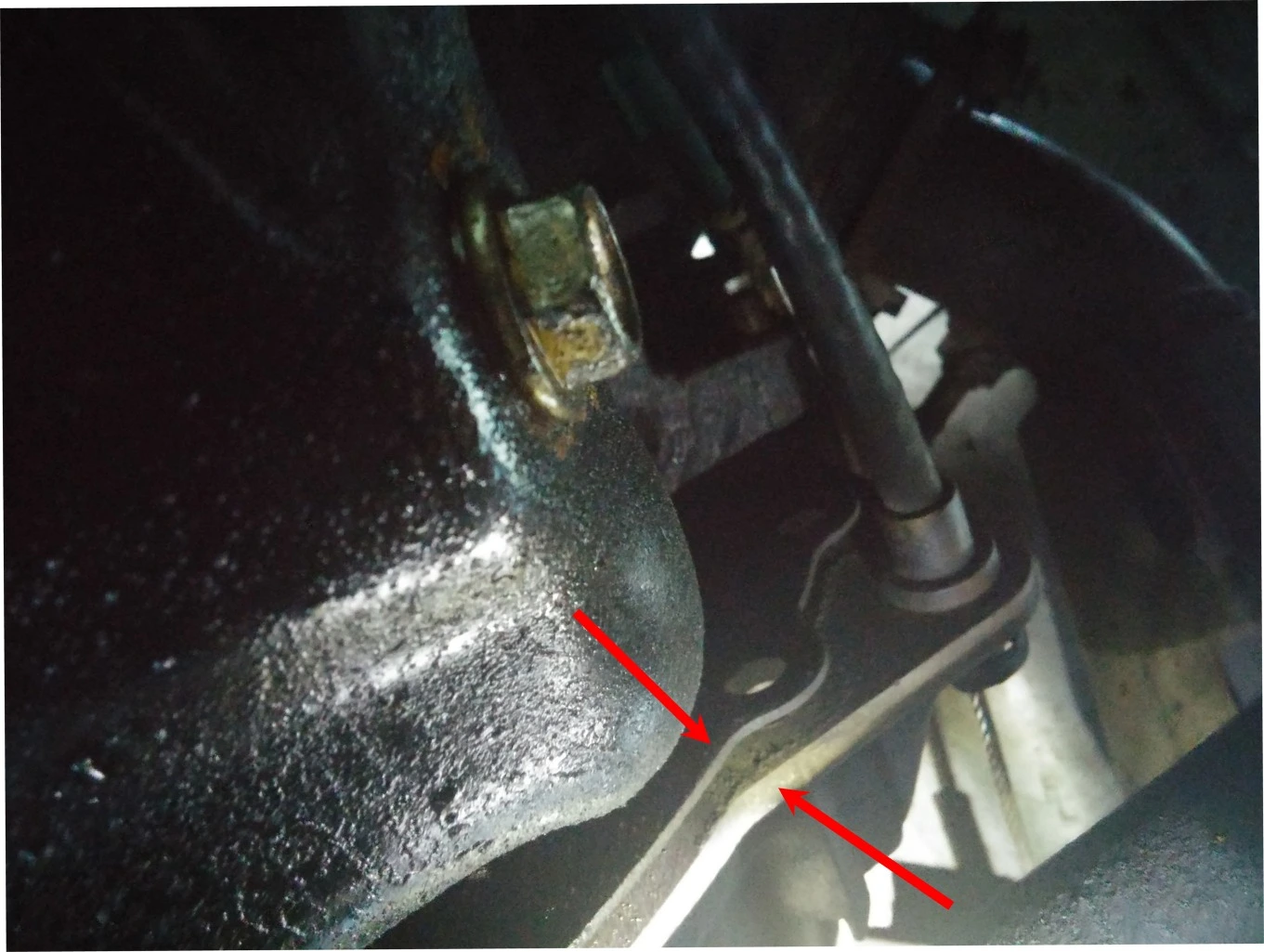

1998 Mustang GT. So I have a coolant leak. I recently changed the timing cover gasket and that fixed my oil leak problem and everything was fine for a couple days but now I have a coolant leak. At first the coolant was leaking slowly out and I would need to replace it every other day and then it got worse and worse. Now as soon as I put in coolant it immediately pours right out, even when the car is off. The leak is coming from right under the crank pulley where the oil pan gasket is but I am pretty sure that isn't possible for it to originate there. Also it is coming from where the trans meets the oil pan and a little further back. It is spilling out very steadily. Now this next part I believe is related to why the coolant immediately comes out now even when the car is off. I was driving home and I started to smell burning rubber and then after a while I saw white smoke coming out of the hood, but mostly through the passenger side air vent (only the passenger side) well I was almost home so I said whatever and I kept on going. The car suddenly shut off and lost all power and I coasted into a parking lot. I popped the hood and smoke was coming from the back passenger side of the engine, I have attached a picture of the area (didn't take the pic when it was smoking) there was a little bit of oil leaking off of the cat but not much. So I believe that all of this crazy :poo: has to fit together somehow. I am completely lost! Please help me because I don't know what to do. I think I want to just swap a salvage yard motor in but I am not sure if I am skilled enough so I am trying to figure out if this is something easy or not. Thanks in advance. P.s I had a shop replace my clutch and while I was under the car I saw a piece between the trans and oil pan that wasn't bolted on or even had a gasket and I think the guy screwed me but I don't know what the piece is.

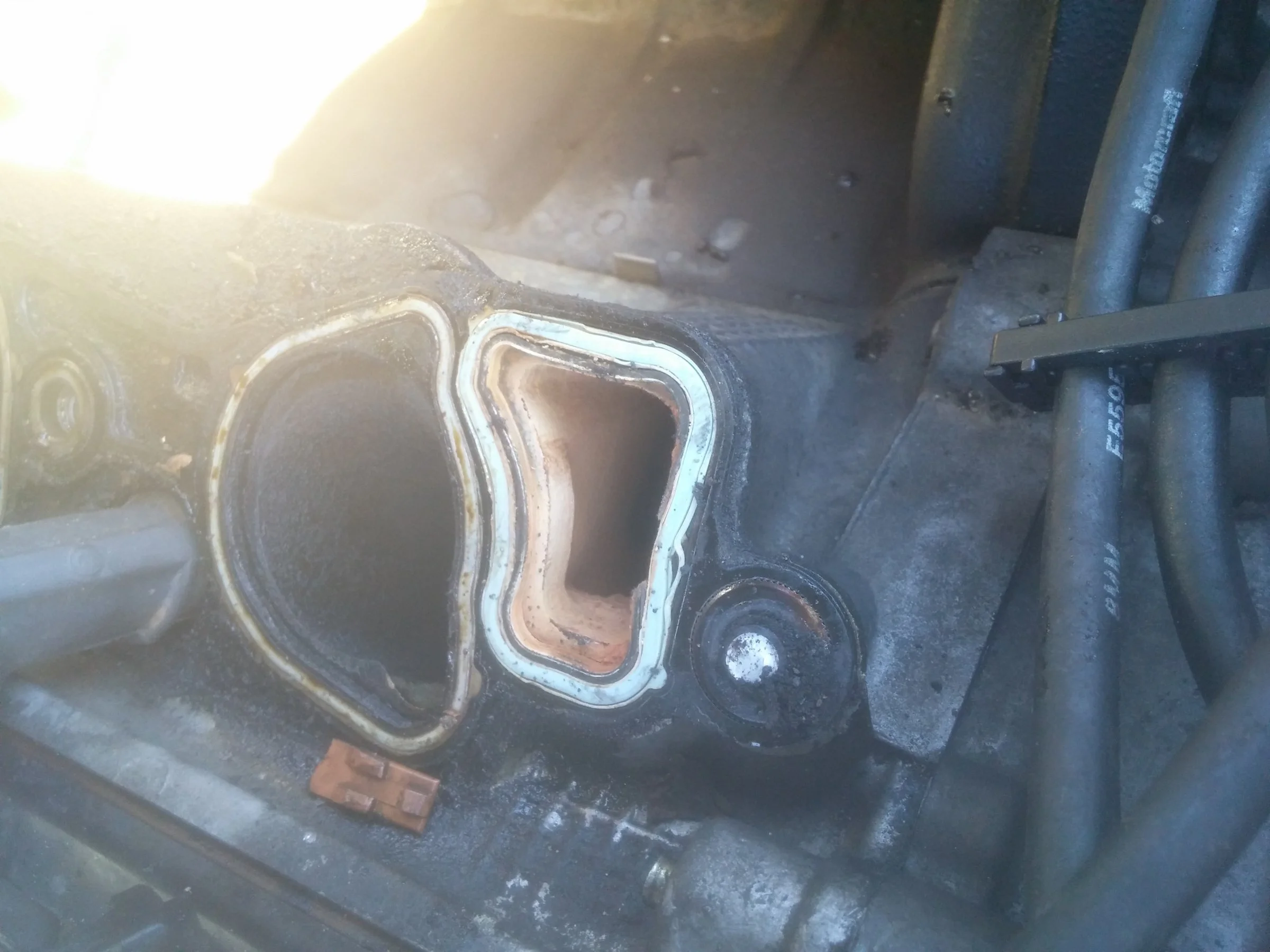

I peeked under there a little bit with a flashlight, it didn't look wet but I will pull the manifold off and check it. I'm just worried it's a freeze plug issue.
If your arms aren't too big you might be able to just pull the alternator. Easier than pulling the manifold. you'd probably have a little pool in the valley if that were the problem though.
Maybe the intake manifold itself is leaking?
I have heard that the sn95 NPI intake manifolds crack frequently. I'm confused though, if it's cracked how would that leak coolant? I thought that was simply air that ran through the manifold. I'm not a car expert for sure lol.
The front of the intake is a coolant crossover. The engine heat will allow the crack to open up more and leak fluid but not enough to effect cooling (at first). If you still have the stock manifold pull it and inspect.

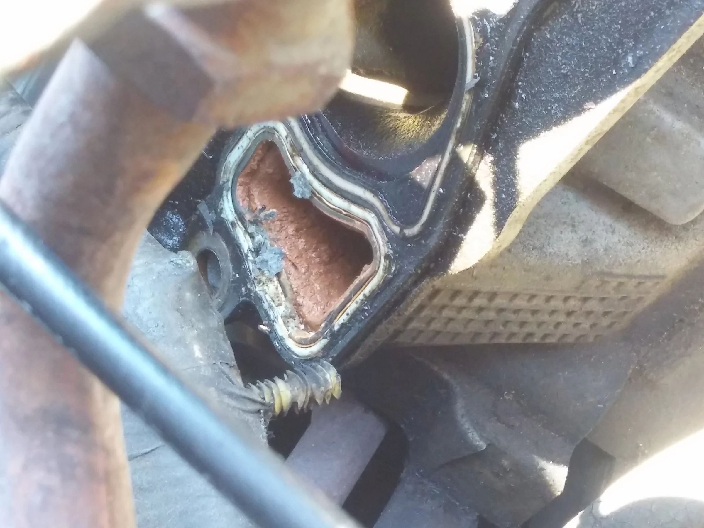

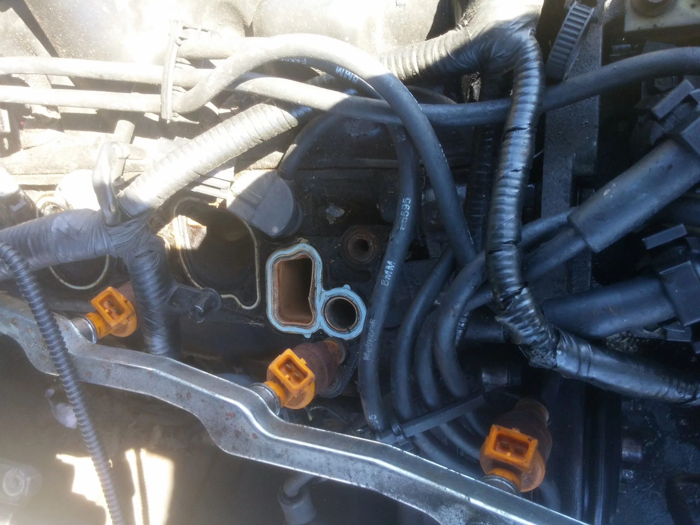

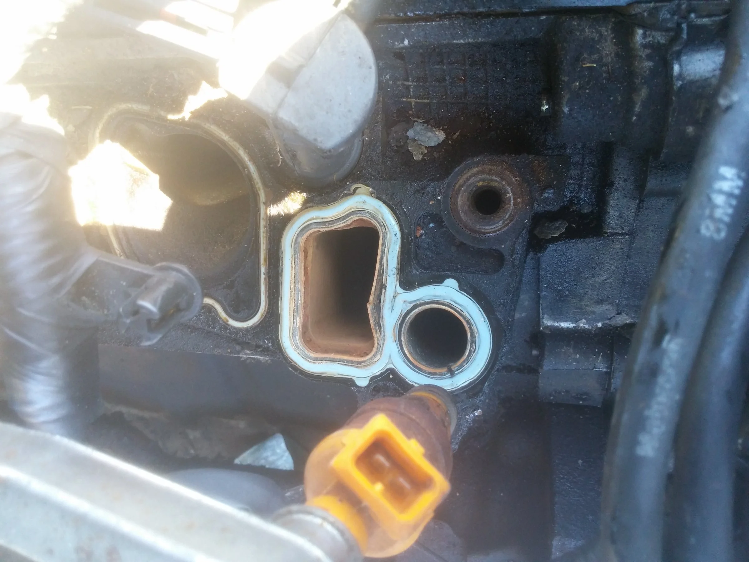

Here are all the pictures I took. It definetily looks like the IM gasket is the problem. There seems to be a tiny crack in the bottom of the IM but I am not positive. Should I just run to the j
unk yard and do a PI IM swap? Also, I just want to make sure that the gasket is the only problem because it pours out very steadily even when the car is not on.

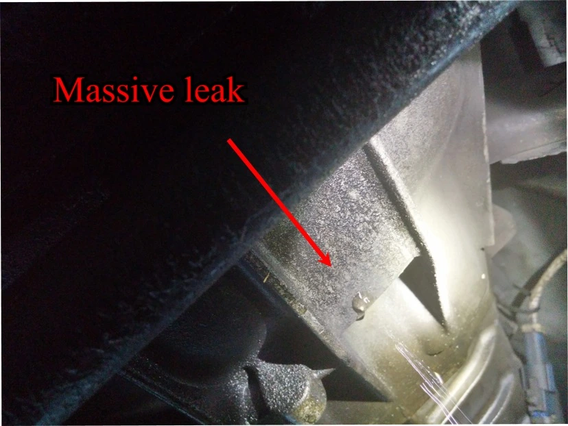

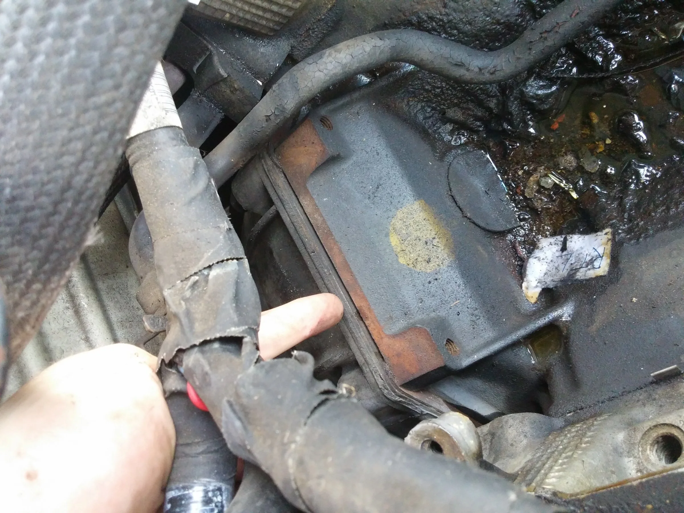

So bad news, I went back over to my car and put some coolant (water) to make sure that was the only place it was leaking. It wasn't, there is a bigger leak. I'll attach the picture, it's the same as one of the ones on my original post. Right where the transmission meets the oil pan and that metal gasket looking thing that isn't attached, its leaking right between the transmission and the metal gasket thing. I got under my car but I couldn't see anything else. I know it's really hard to understand what I'm talking about and the picture doesn't make it much better. I tried to take another picture but I was just too close to the thing to be able to see what I'm talking about. If you guys really need another picture I can try and go get another. I drew arrows to point out that it's the space in between where its leaking. It's not leaking from the side (the angle of the picture) it's leaking from the bottom and it's a very steady stream.
Sorry, I hit the wrong button and it just copied his quote. I'm pretty sure it's the freeze plugs right on the back of the engine between the engine and the transmission. I think there are 2 back there. Is there anyway to verify this or do I just have to pull the tranny and do it?
Process of elimination, you have to ascertain that the leak is not coming from up above ie heads, hoses(rubber and metal)etc. Inspection mirrors, feeling for dampness and even possibly enlisting the aid of OP to get another set of eyes on it. I would sure hate to go to all of the work to pull the tranny for nothing but of course car's can be that way sometimes. If all else fails I wonder if you could just undo the rear mount and bolts holding the tranny and get a space between the tranny and bell housing because I would think the coolant would pour out of there if it is a soft plug.

One more question (I'm sorry that I am asking so many questions) when my clutch went out the first place it got towed to said they couldn't fix it because the exhaust was welded (I don't know where it was welded) and they didn't have a person to re-weld it up after they replaced the clutch. So, I had to go to another place (the place where that :leghump:ing ******* didn't bolt up that metal gasket looking piece that attaches to the transmission, as seen in the picture where the main leak is coming from). Because I don't know where it's welded, there is a chance I might have to just cut it off. The guy said “exhaust”, he didn’t specify if it was the headers or the actual pipes. I have an H-Pipe that I hate because it’s so loud and there is a hole in one of the mufflers. If I have to cut it off will the exhaust and headers from a crown vic, town car, etc. fit my car or will I need to buy new exhaust specifically for my car? Thank you so much guys!
Pretty sure the Crown Vic exhaust is incompatible. You can look up pictures of the cat back systems to see how they connect(where they would be welded instead of clamped or both). If there is a muffler shop or welder close by you might be able to jury rig it for a short distance to get rewelded. Don't forget to remove the speedo connection and shifter and clutch cable along with the rest oh and support the rear of the engine using a block of wood and a jack since the rear mount is out and the engine is hanging on just the front mounts.I like to check out YouTube also for hints and specifics. Mark your driveshaft so you get it back the same(sometimes get vibration otherwise). The soft plugs are easy so all of the time is removing tranny, flywheel etc etc. Hard to guess your time frame but say 2 guys 2-3 hours, 1 guy an afternoon probably.

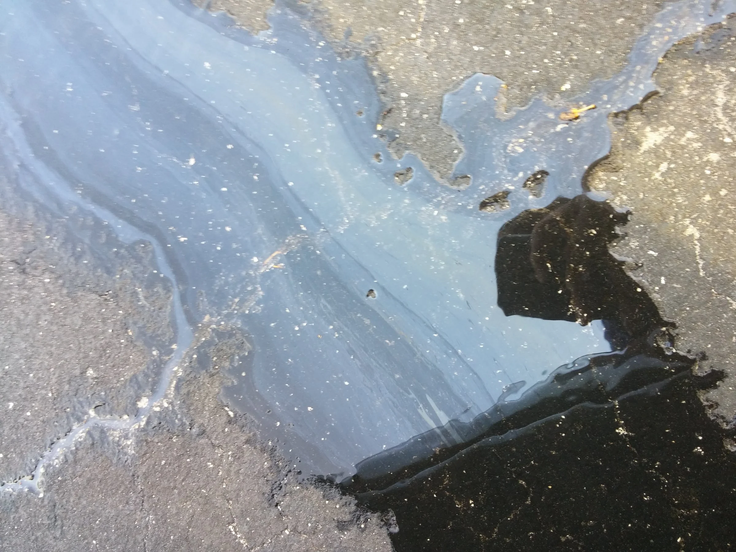

Okay so I went back over to my car today and was reaching around and I think I finally felt where the 2 freeze plugs on the back are. I went home and got some water to fill the car up and it didn't leak from the plugs so I guess maybe it is just the intake manifold gasket. My engine has 192K miles on it, it's old, rusty and there has been an oil leak up front before. I took a picture of the water that was spilling out of the intake manifold coolant crossover thing because it has a milky look, it looks like its mixed with oil. My friend thinks it's probably just some old oil stuck on my engine, I just wanted an opinion on that. I am going to repair the IM on Saturday and I will see if that stops all the leaks. Remember the old picture of the loose metal piece next to the oil pan? I did some searching and I am pretty sure that it's a bellhousing spacer plate. In one of the pictures you can see my finger pointing to a gap between the bellhousing and the engine, is that where that spacer plate should be? If so, after I fix my engine I am going to take it back over to the mechanic and tell him to put my trans back together the correct way. Is it bad that he didn't install that on properly?

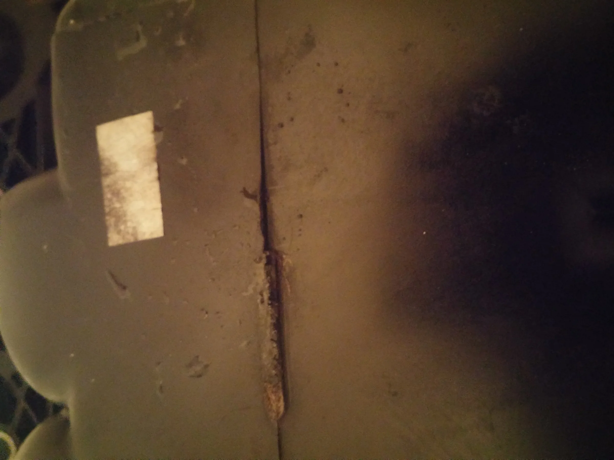

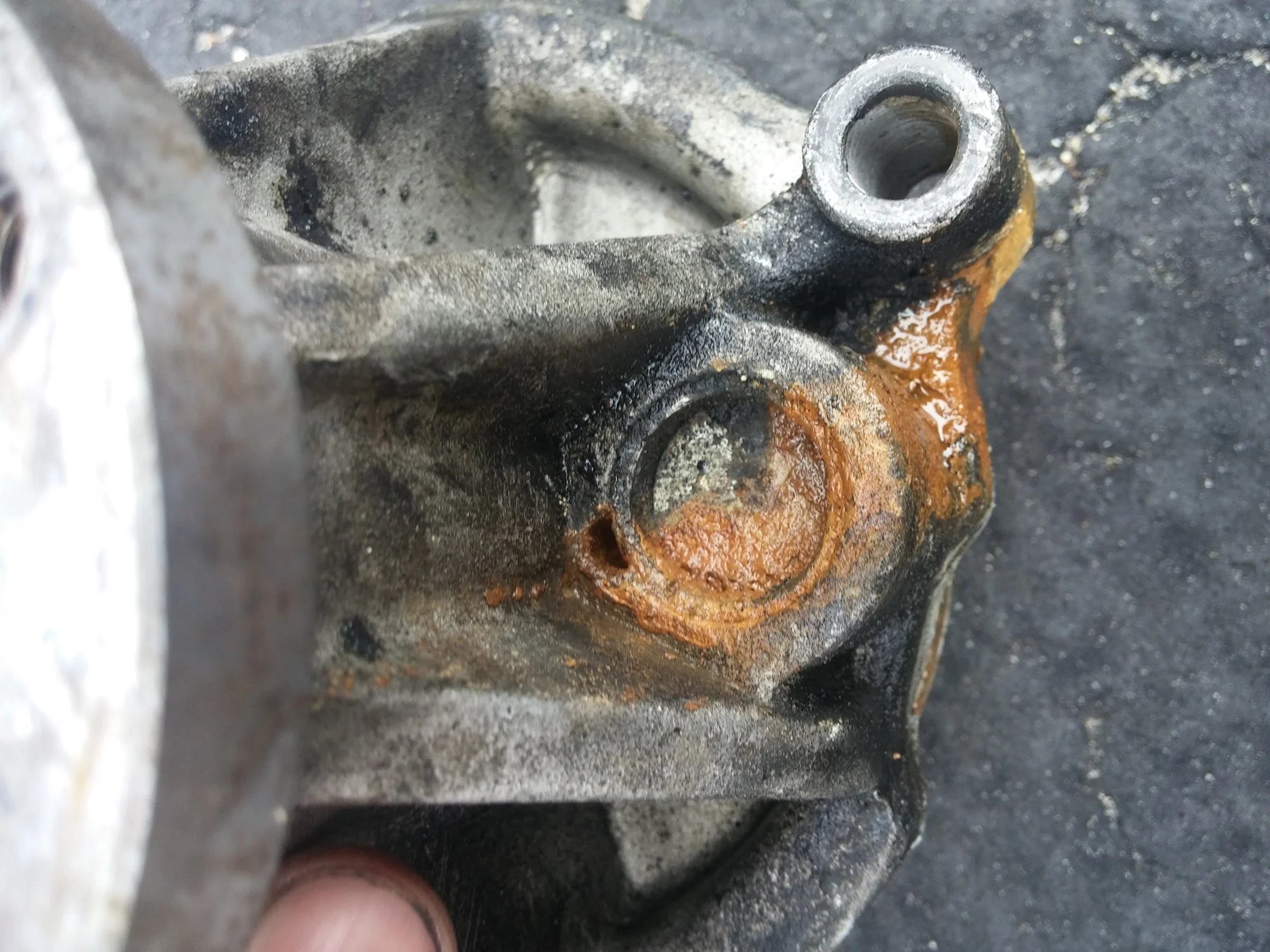

All right so I went to the junkyard, picked up a water pump and installed it. I inspected my old one and saw this little hole. I saw that it was on the other one too. It turns out that the hole rusted through to the other side and that's where the coolant was leaking
out of. It was just pouring straight out as soon as I poured it in. I have NEVER heard of anyone else having this problem, have you? Anyways, my car is fixed for now.
