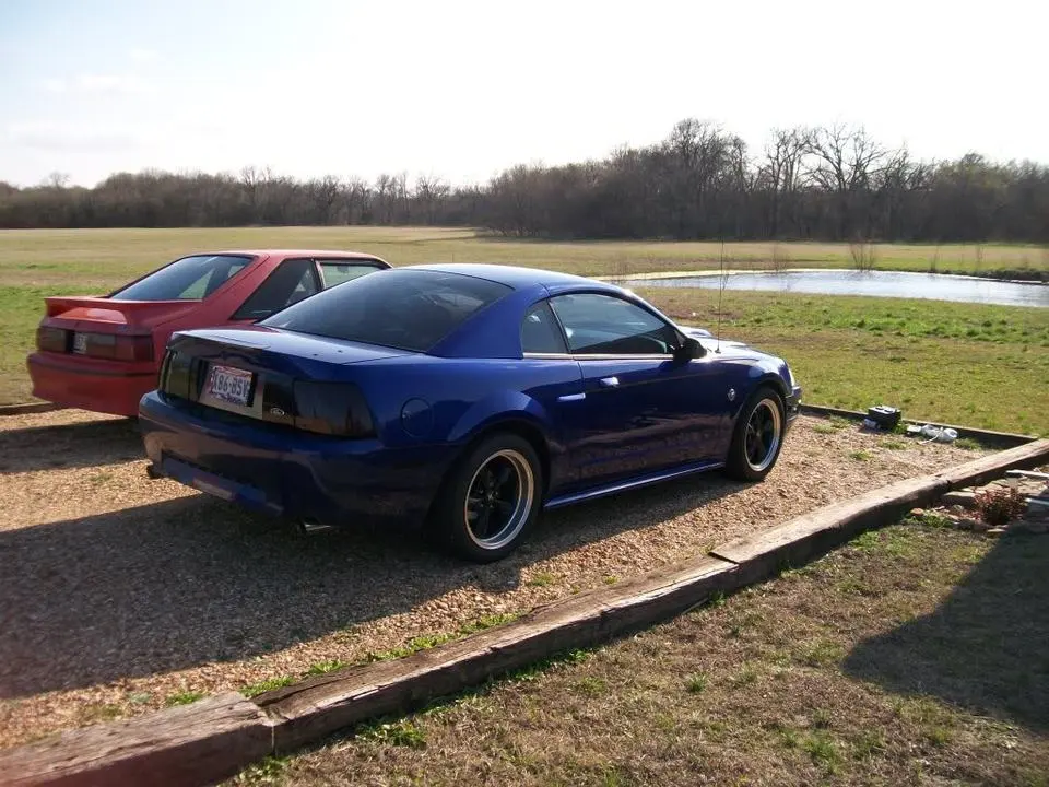

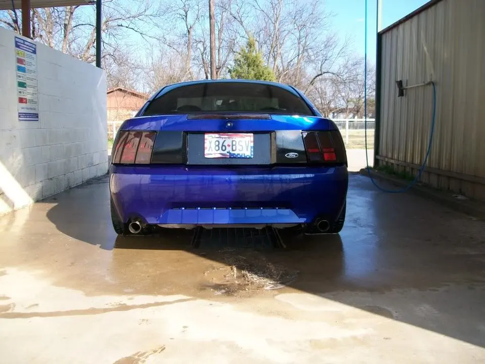

send me your lights and $100 and you will get a set of professionally tinted tails. VHT looks like crap no matter how you do it.
just for reference, here's the lights that are on my car
HorsepowerJunkies.com Forums - View Single Post - 99 - 04 Mustang Tinted Taillights

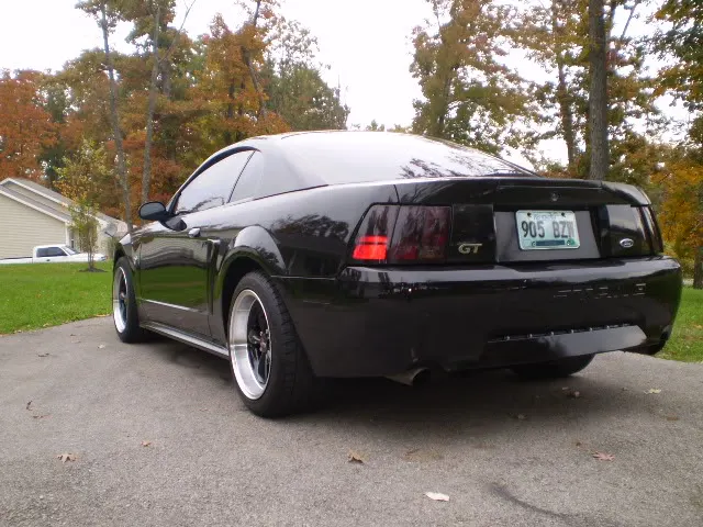

You do need to clearcoat them. I've done about 4 or 5 sets of taillights for all different cars with Nightshades and they all come out great. Lay down the amount of coats of Nightshades until you achieve the desired darkness, then lay down about 4-5 coats of clear. Not only will it give the light a glossier look, but then once the clearcoat has dried, you can wetsand and buff it. I recommend maybe 600-800 grit sandpaper, then come back and buff it out by hand with rubbing compound, then some polishing compound. Then throw a coat of wax on it. Badda bing, baddda boom! Here's my buddy's car I did this summer:
