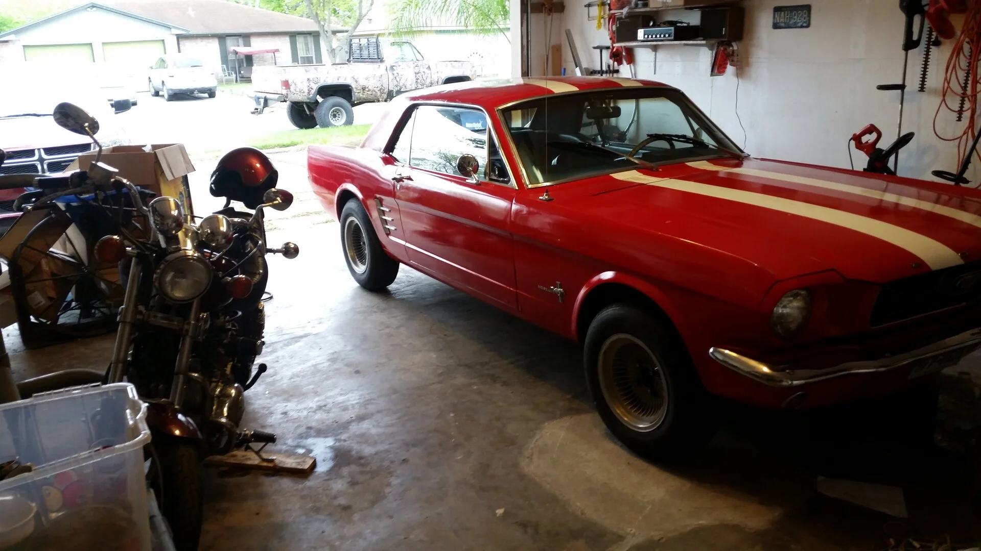

So dont let it bother you, and post a picture of your car.
Straight 6, stainless steel headers into dual exhaust, 2 barrel Motorcraft carburetor, Edlebrock air cleaner. Car was modified from stock drivetrain before I got it.
