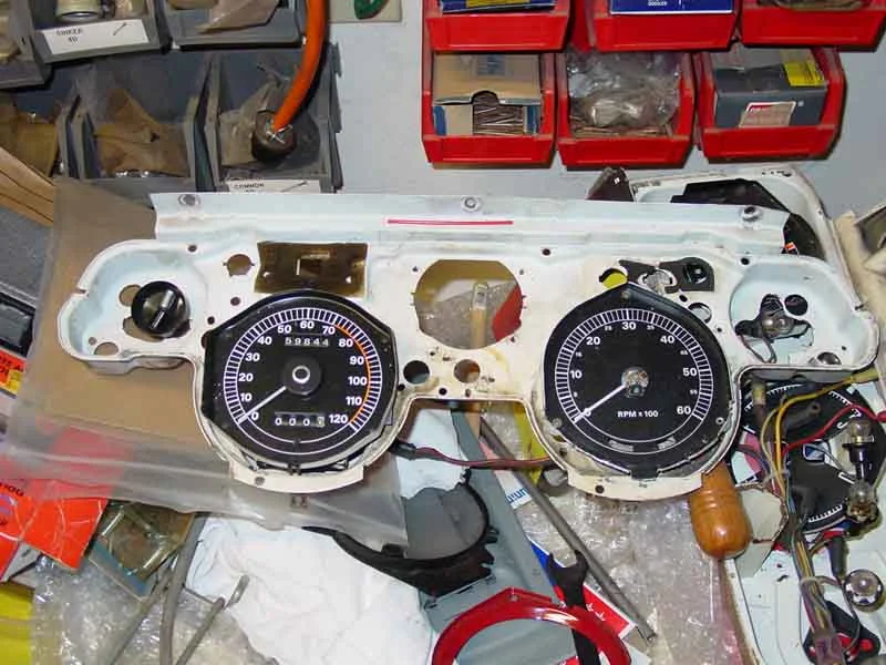

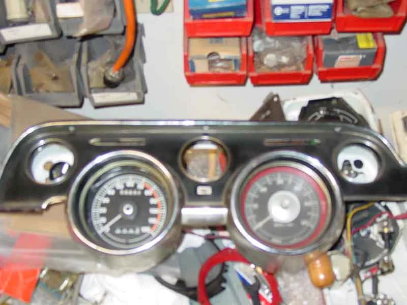

Ok, I've let this project sit for months now, but eventually I was going to make custom overlays for them and finish it up, but I'm probably going to put a t-56 in and I need an electric speedo so I won’t be able to use them. The Speedo with trip and tach are from a cougar. It took quite a bit of modification to make them fit. If any one wants to buy them, I'd probably sell them for like $80 including custom white overlays I was making for it and the speedo lense modified to accept the trip button. Let me know

Thats a pretty cool set up. I like it but what about the 2 that were in the tach spot. I belive it was oil pressure and temp. Where were u going to put them? Ive never done anything w/ my guages before so Im not really sure about all the rewiring.

The gauges arn't worth that much any more to a cougar owner. I had to cut them up a bit to make them work. I'll just finish them and put them on e-bay. Then I can make phantom cluster.

I put it in a vise on my workbench and used a reciprocating saw (small "sawzall") on it. Once it was close I used a burr grinder on the dremel. You should have the circular holes for the small gauges as tight as possible, the plastic is weak for them unlike the larger two.
