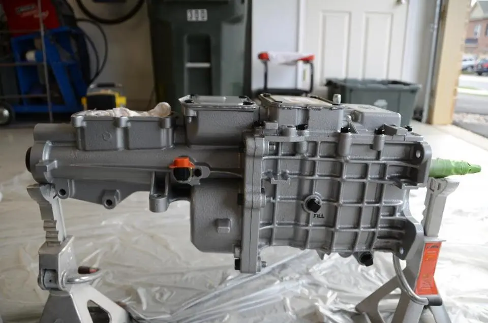

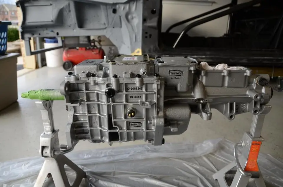

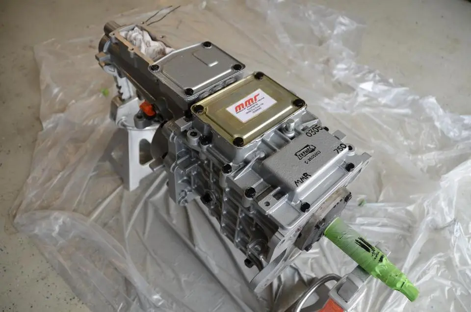

Anyways, although there is nothing to do on the body, I did detail the transmission today.
Reactions: chgovfk
Little do you know Noobz, that is actually a shop rag disguised as a sock. Fooled again...
Mike, the transmission is from Modular Mustang Racing. It's a beefed up TKO-500. Good to 750HP. A beefed up TKO-600 would be a better choice for the turbo setup, but I've had this transmission for about 5 years and it only has 1100 miles on it. It was just oxidized like crazy and all the bolts had surface rust on them, so I gave it some TLC.
