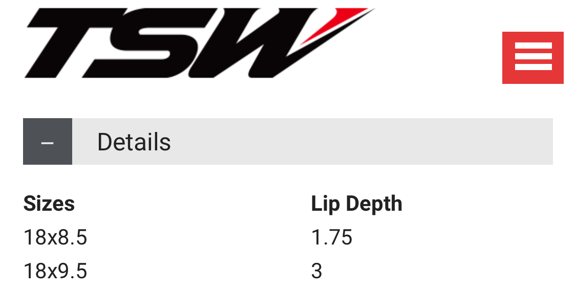

I pulled this off the internet.
Note where rim width and backspace are to two different points. From the rims I have seen and measured, the difference between measuring inner wheel lip to outer wheel lip and the rim width dimension is usually around an inch.
Recheck the dimensions for backspace and forward space - not shown but would be from the mounting flange to the front lip. So place a straightedge, a ruler or a level across the rim lip (not the tire face as you do have some tire bulge).
From the dimension you gave, you would have a 36-40mm offset. What model Mustang are they designed for because that is S197 or S550 offset numbers.

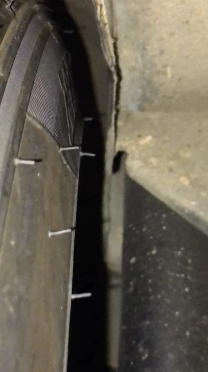

As I said above, take out the 10mm spacer and your rubbing may just go away - or do you start hitting something on the inner side (control arm, shock)?

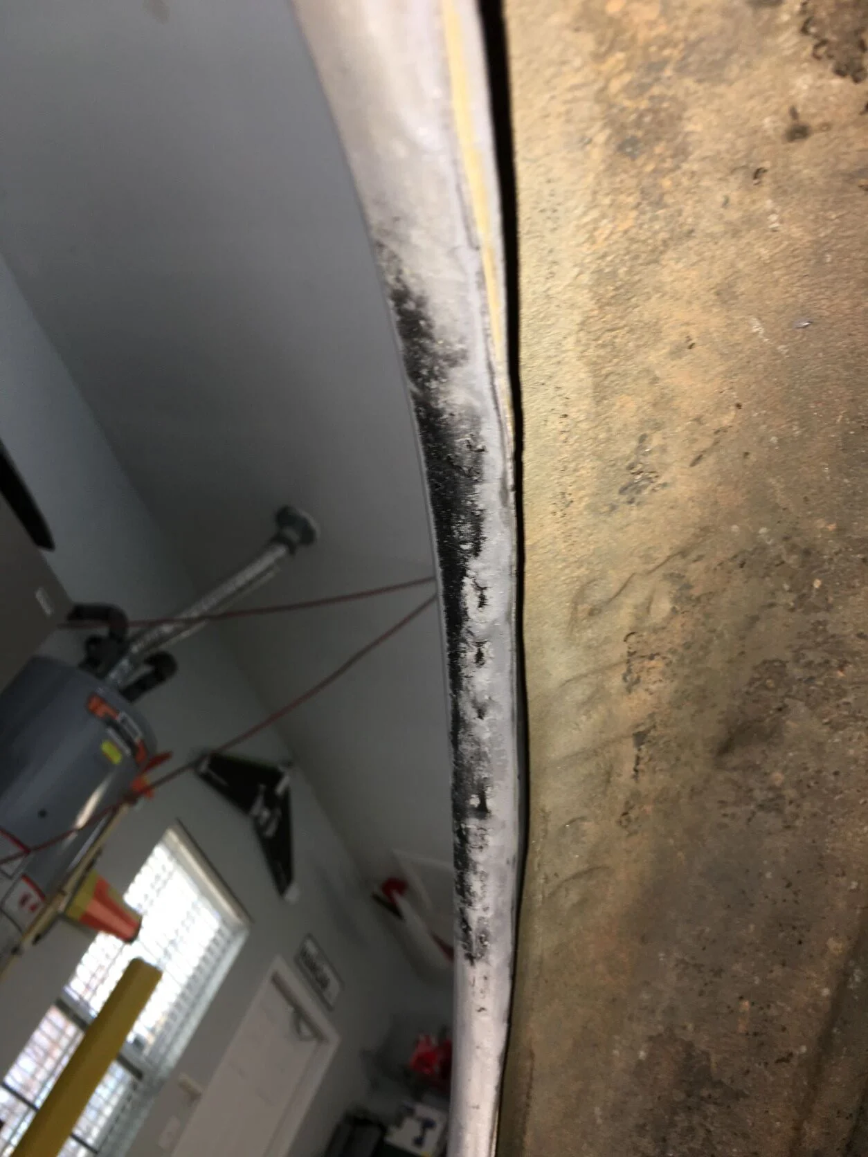

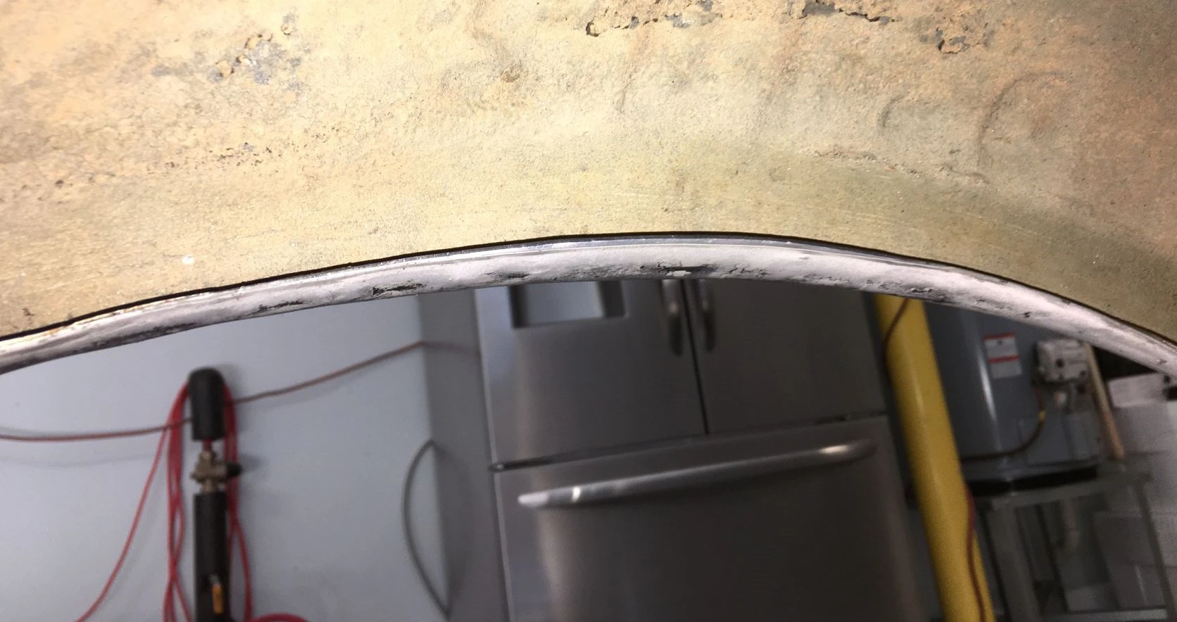

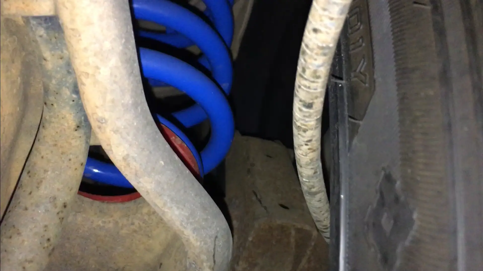

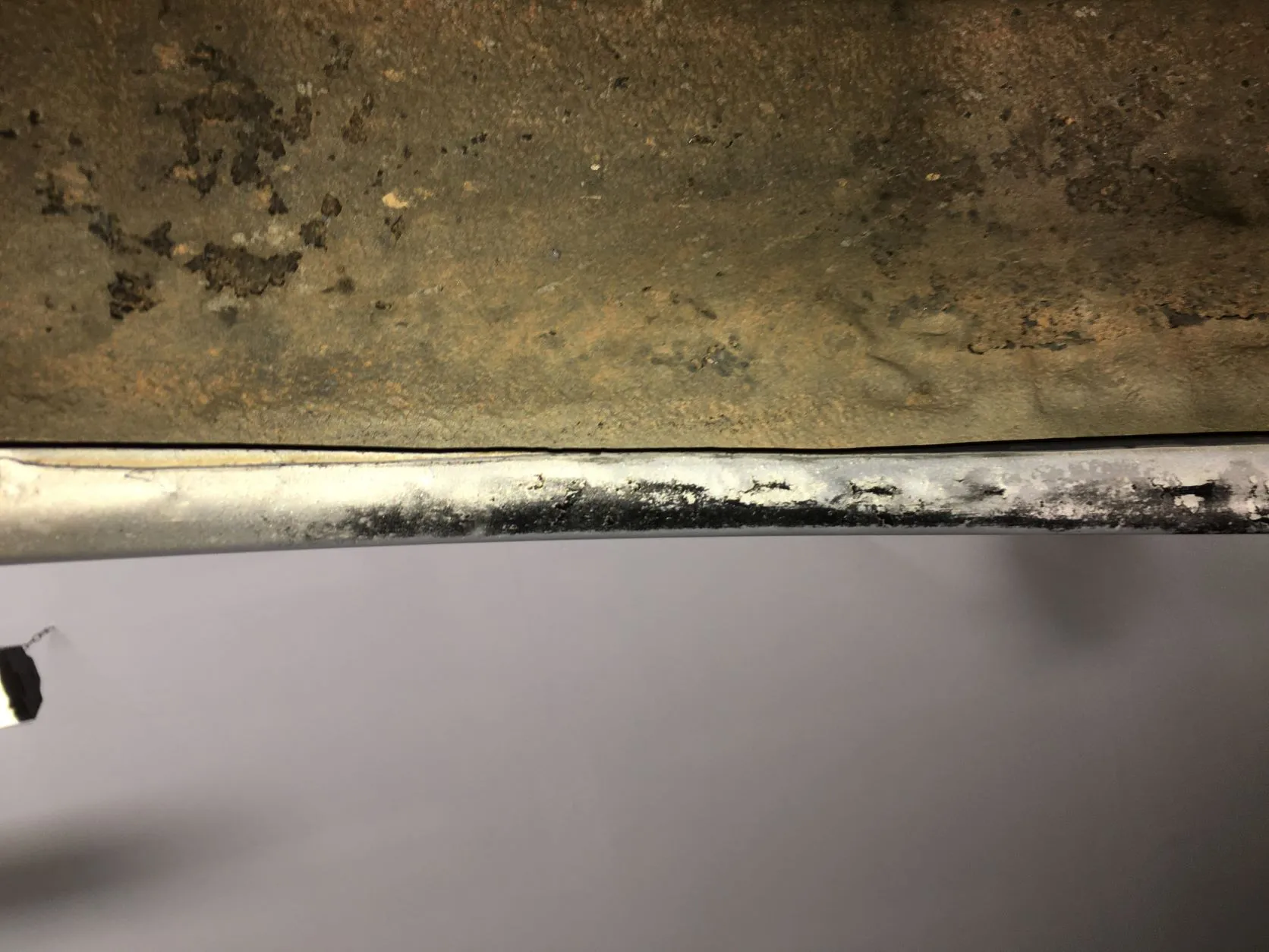

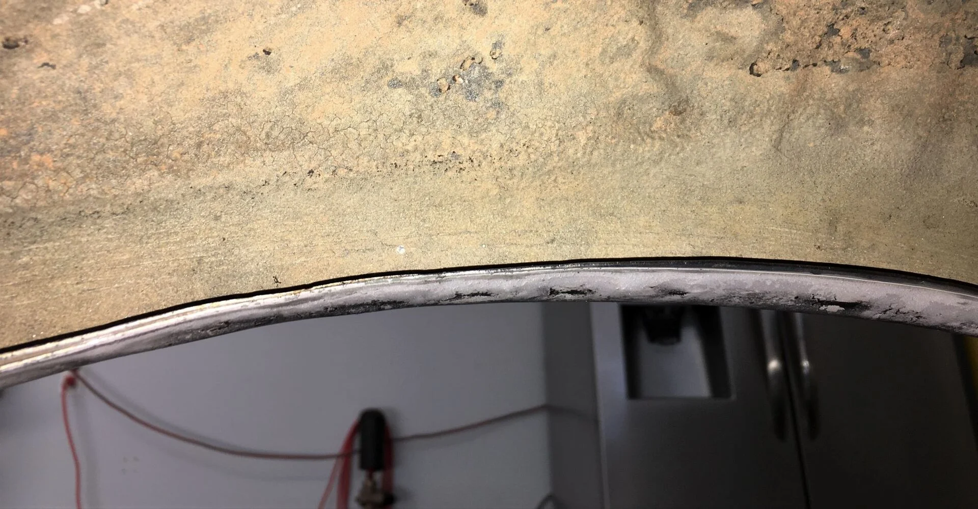

So I took a few snapshots of the inside of the tire mounted to my car. Without the spacer it would rub the brake line and inner fender well from what I can see. I'm sure I can move the brake line over but not sure about the fender well. I ordered a fender roller which will be here tomorrow and see how that goes. Next resort is to get a thinner tire but I do love the look of the wider tire. Also the rim diameter for this particular wheel in 18inch is either 8.5 or 9.5 per the manufacture. Thanks for your advice.

Come on over to the East Coast and you borrow it anytime you'd like. It wore me out. Spent almost 4 hours rolling the fenders. Was worried about damaging them so made sure to apply proper heat with my heat gun every now and then.
