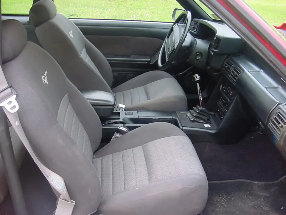

IPS- I noticed in the pic you posted that you have a square/holes cut in your A pillar from the gauge pod. I don't know how recent that pic is, but I have a clean OEM black A pillar you can have if you need it. Just throwing it out there!
Yup, that's from when i had the a-pillar gauges up there. Haven't decided yet if they are going back. If they do, i'll prob buy the 3-gauge entire pillar. If i stick them under the radio, then i'll need a new clean stock pillar :)

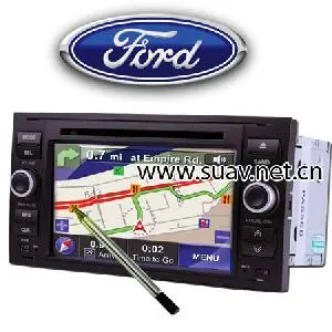

I guess i could go shaker as well.
I could do a lot of things really...even install a Ford touchscreen NAVI unit. :)
24557-ford-focus-car-dvd-player-gps-navi-bluetooth-touchscreen-ipod-stereo-audio-video-1.webp
NAV appeals to me because I might take the car out for shows that I have no idea how to get to. Plus it looks cool when the car starts up and the FORD logo displays on the screen.
Downside....cost
Would this fit? OMG i would love this.... But it would have to look clean and factory in order for me to enjoy it. Any dimensions on this? Thanks

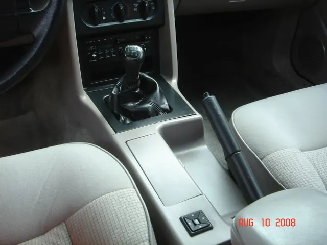

I have the factory radio in place any right under it is the controller for a 10 disc changer in the back.
the part that sits right under the stock radio is an excellent match it looks factory it even lights up the same green as the radio and the rest of the dash, If you would like I can get some better pictures for you just let me know Lee
When you see this face forward it's a nice set up. Is this something you might be looking for?
That place right under the stock radio is the controler for a 10 disc changer thats in the back.
It matches so good that most pepole just thank it is factory it even lights up the right shaid of green
If you think this is what you would like see some pictures of it for you let me know,
